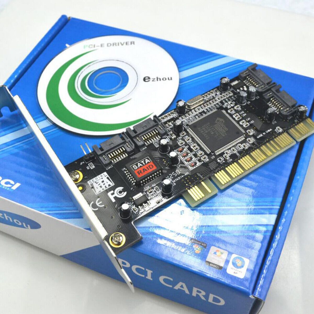

Rats! link at top of page brings up this PCIe(?) card:
Didn't grok that part at first. Box says PCI, driver disk says PCIe as does edge card. Might it work as either? Looks like PCIe 1x slapped onto PCI? Not familiar with such, might it work in either mode?
I'll do a pin count later, might just be a 3.3V cutout in the connector?
Looks the same as the (4) SI3114 cards I have on hand. I bought sockets in case I fudge the programming. Hopefully get to these this month. One from eBay as a random cheap, two cheap from Free Geek, one "Mac" card from eBay that said works with Mac (assumed it was already reprogrammed).
There isn't a ROM for the 3114 for Classic Mac OS (at least I don't know of one that allows booting and all four ports to work).
