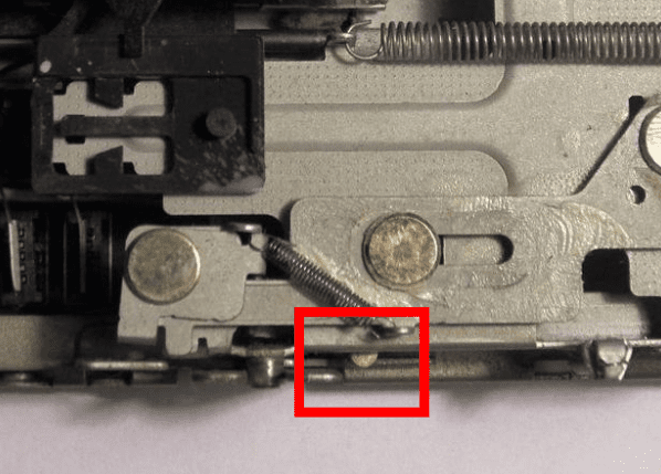

When lubing the drive after cleanup, make sure you do not lube this metallic pieces here:
Lubing this will make the pieces slide slower, preventing the drive from keeping itself in the "empty" state. There's a little knob that latches on the assembly when the disk is ejected. If lubed, It won't easily latch, not letting you get the disk out!

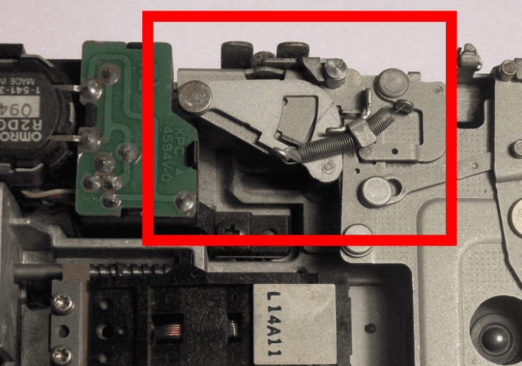

If the disk is not pulled in by itself, make sure the little metallic pull knob is properly (vertically) aligned with the disk:
