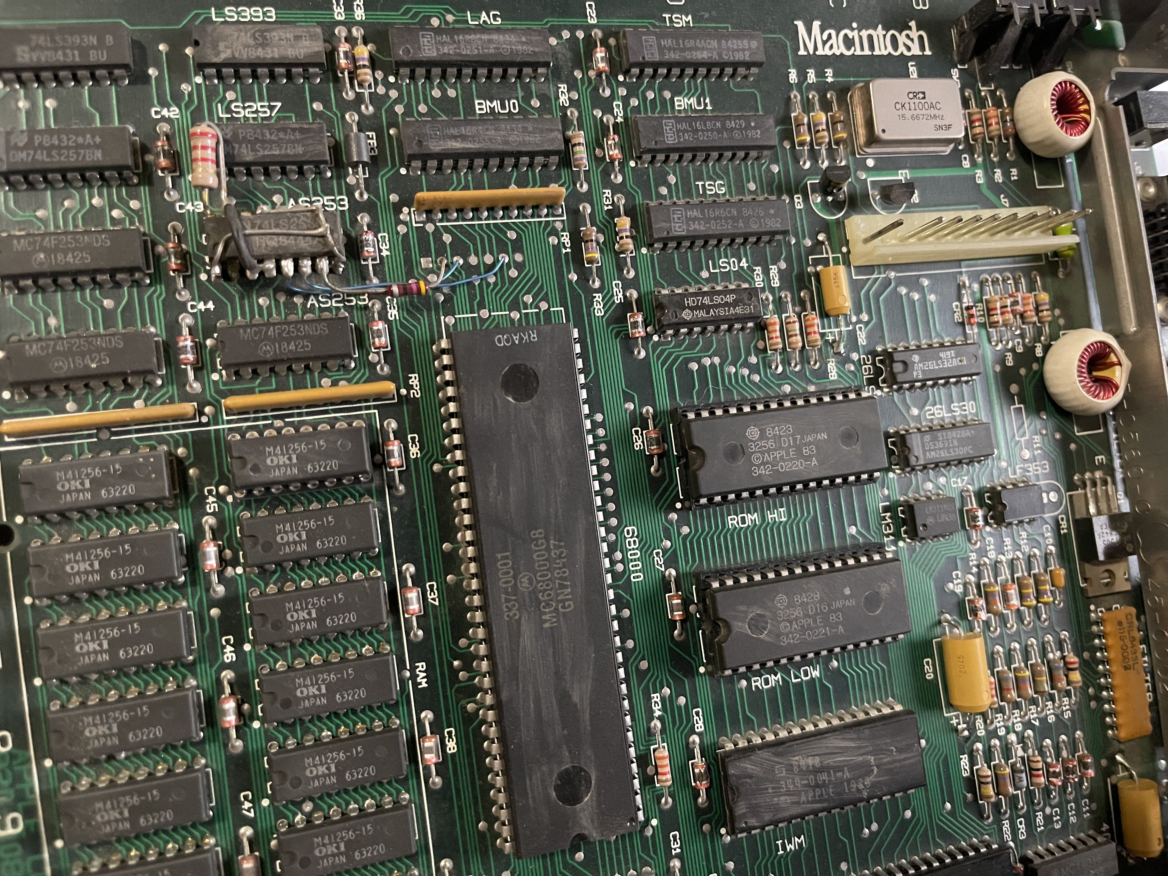

Apols for being late to this thread, but I too had a surprise a while back when I picked up what was supposed to be an 'original' 128k... What I discovered when I opened it up was the following...
Yep... that's an original 128k 'board, but "fattened" out to a full 2Mb!! And... it still works!
This represents a brief period of time when eager enthusiasts were willing to "risk it all" to reach the dream they were sold with the 128k (and 512k).
Completely agree!
