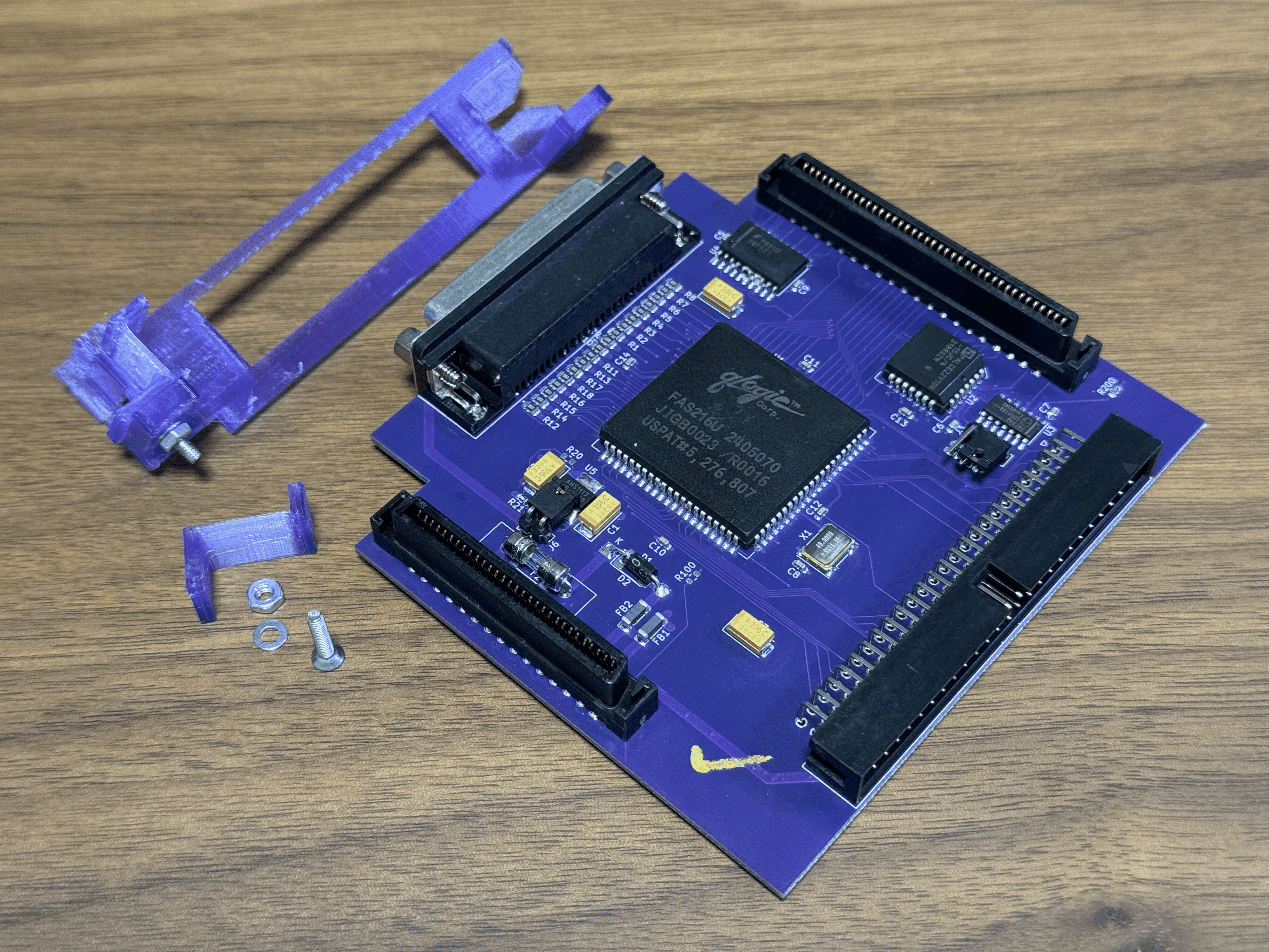

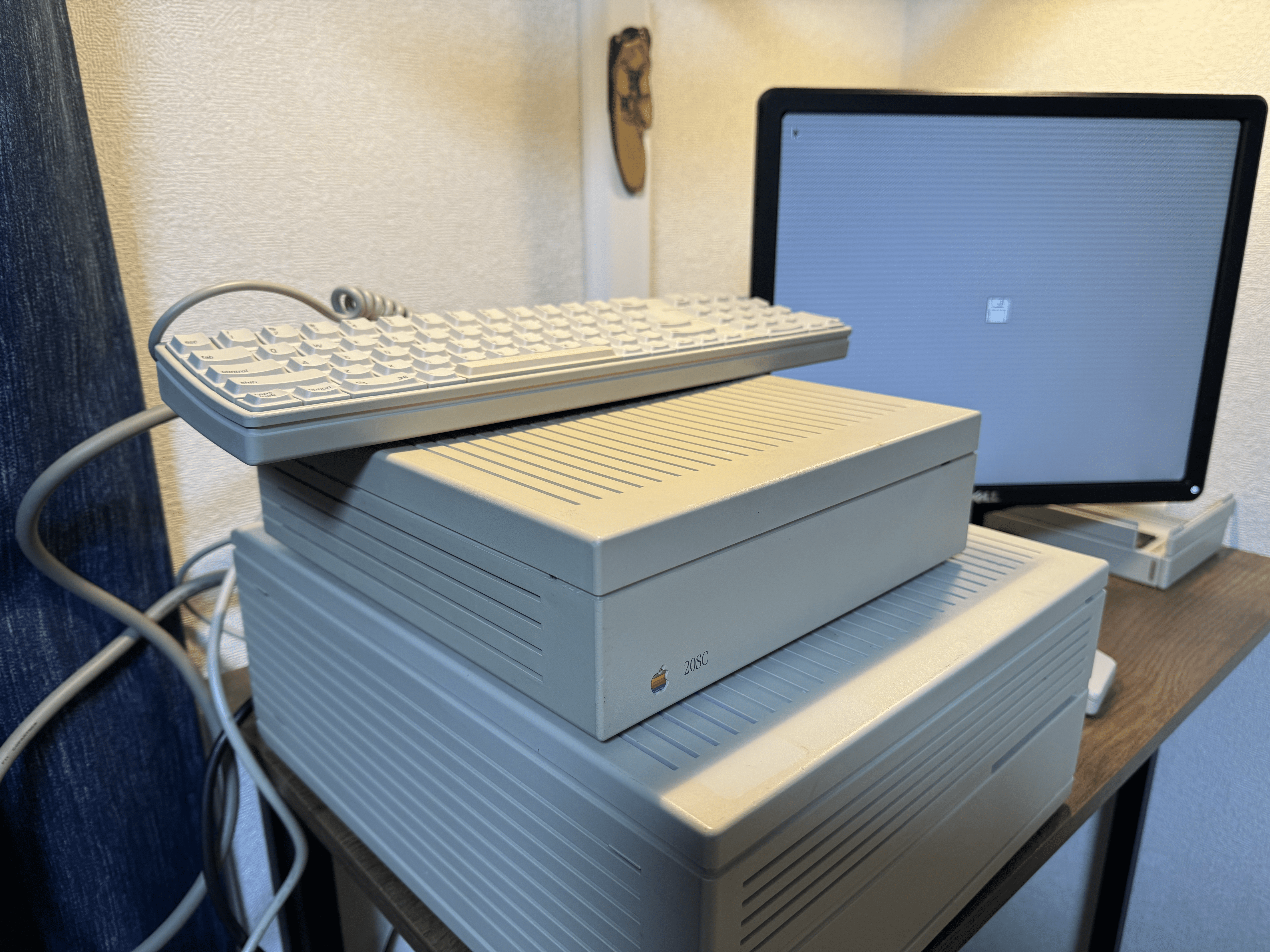

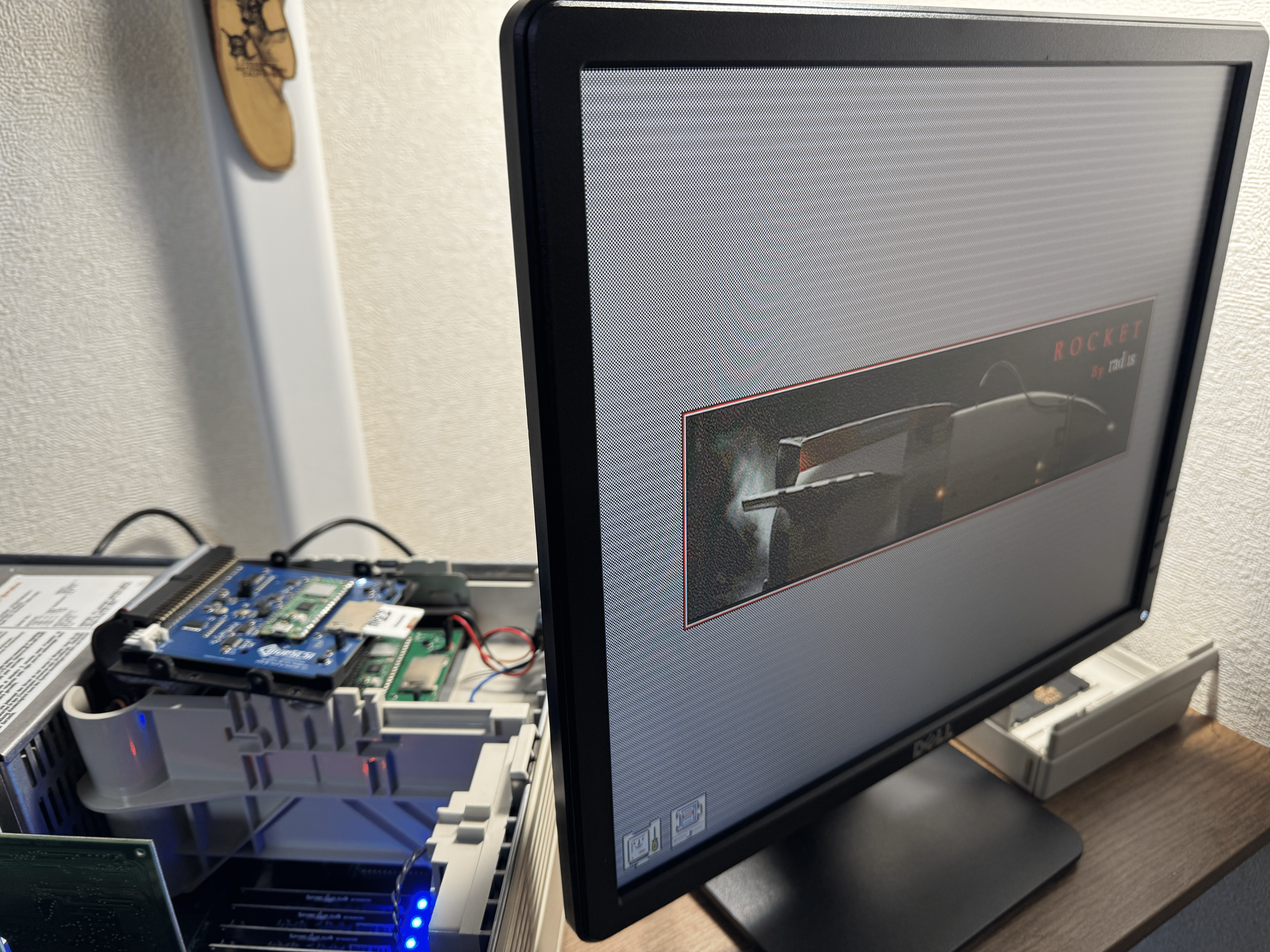

I purchased a SCSI Booster for my ASIC edition Radius Rocket (33MHz 030)...

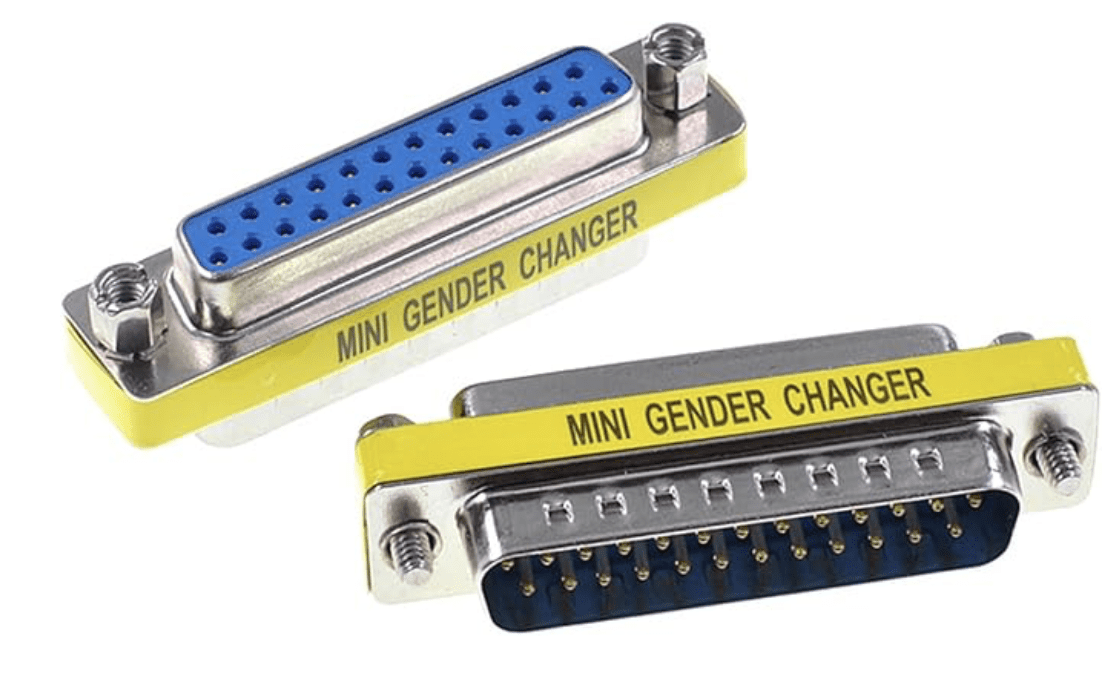

It includes a standard DB25 for external drives, which is nice. The DB25 connector doesn't stick out enough on my IIci, so I couldn't connect anything at first. But I solved that problem by purchasing a DB25 extender (one side Male, the other side Female)...

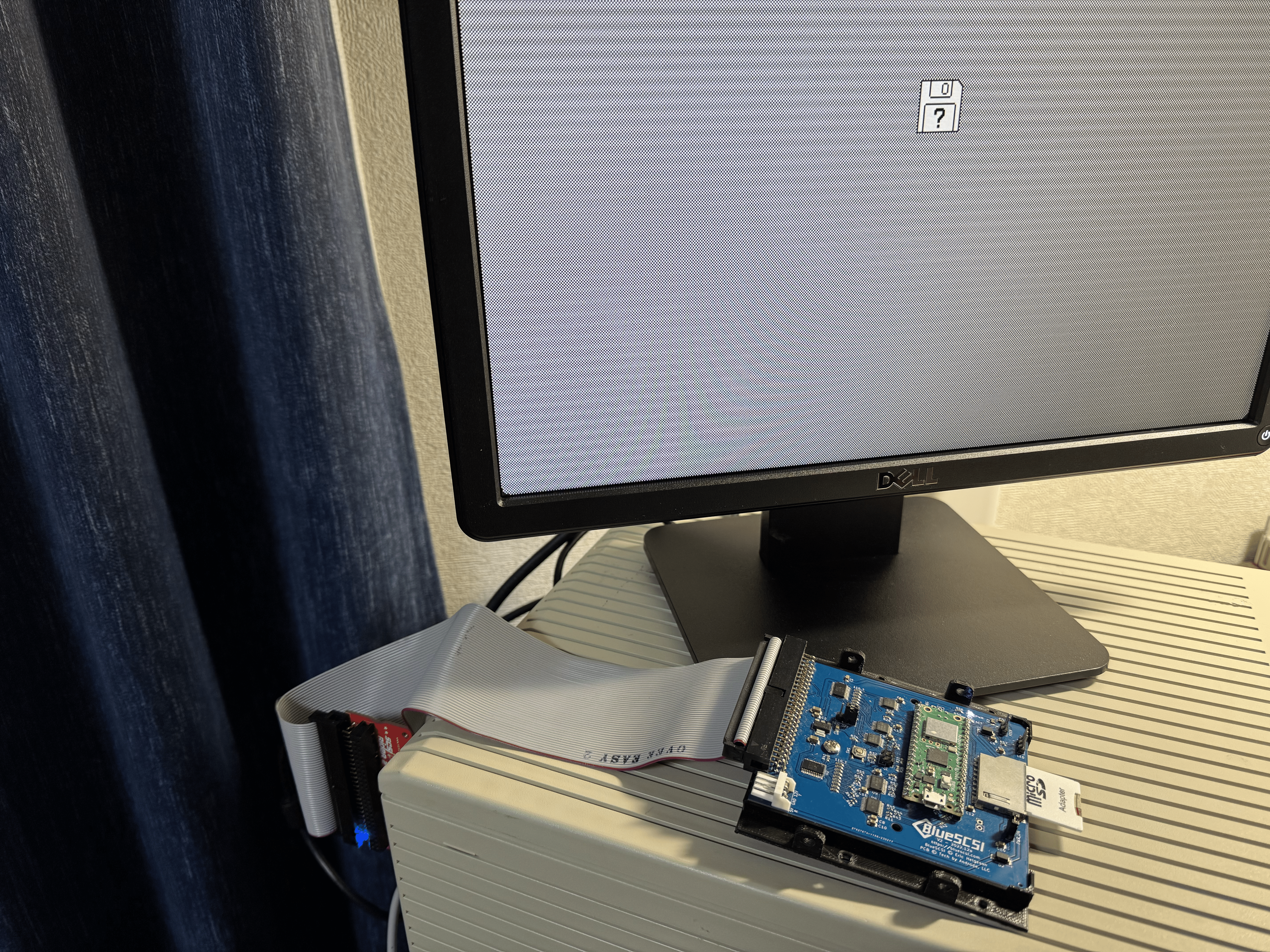

TEST #1​
My first test was using my BlueSCSI v2 via SCSI Rider 2 from @Kay K.M.Mods (since I only have a Desktop edition BSv2, not a DB25 model) ...
I get the Power LED on the SCSI Rider and on the BlueSCSI to light with the IIci powers ON, but after the IIci finishes its RAM check, there is no disk activity LEDs lighting, and I get the Disk with flashing ? icon. :cry:

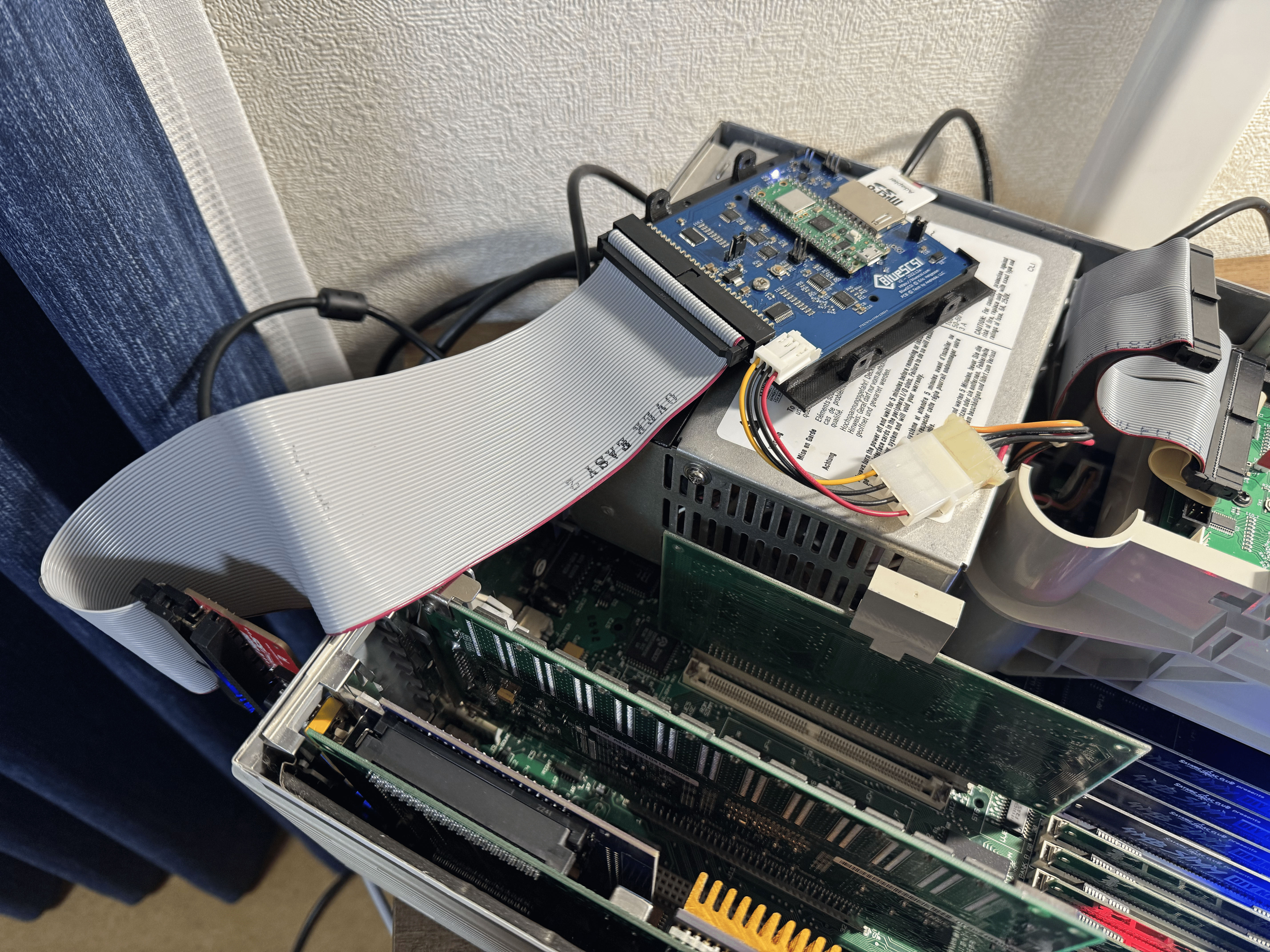

I then connected it to the internal motherboard SCSI ribbon cable, and it boots just fine, proving there's nothing wrong with the BSv2 I'm testing...

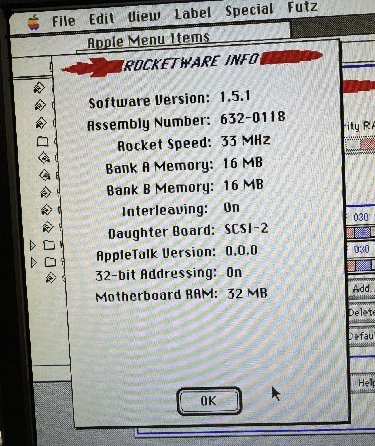

That alone told me something is wrong with the SCSI Booster (at least, when used with my ASIC edition Rocket), but when I check the Rocket software, it shows the Booster is attached...
So the Rocket recognizes the Booster, but the Booster doesn't recognize my drive. Odd.
Thinking it might help if I separately powered my BlueSCSI v2, I did just that, but alas, the SCSI Booster still won't boot from my BlueSCSI v2!
TEST #2​
I then connected my DB25 BlueSCSI v1, and all its LEDs lit when I powered on my IIci, but after the RAM checks, no LEDs flashed, and I got that darned Disk icon with flashing ?.
TEST #3​
I then used a spinner drive housed in a fully recapped HD20 enclosure, termination set appropriately. I powered on the drive enclosure and let the drive spin up BEFORE I powered on the IIci. Sadly, I can't boot from it either.
QUESTIONS:​
1. Any of you ASIC edition Rocket owners also own the SCSI Booster (same clone as I have or the vintage SCSI Booster)? If so, what's your experience?
2. Does the SCSI Booster require some kind of setup or settings to be changed before it works? I don't have a SCSI Booster manual, so I don't know how it is supposed to work.
Thank you!
