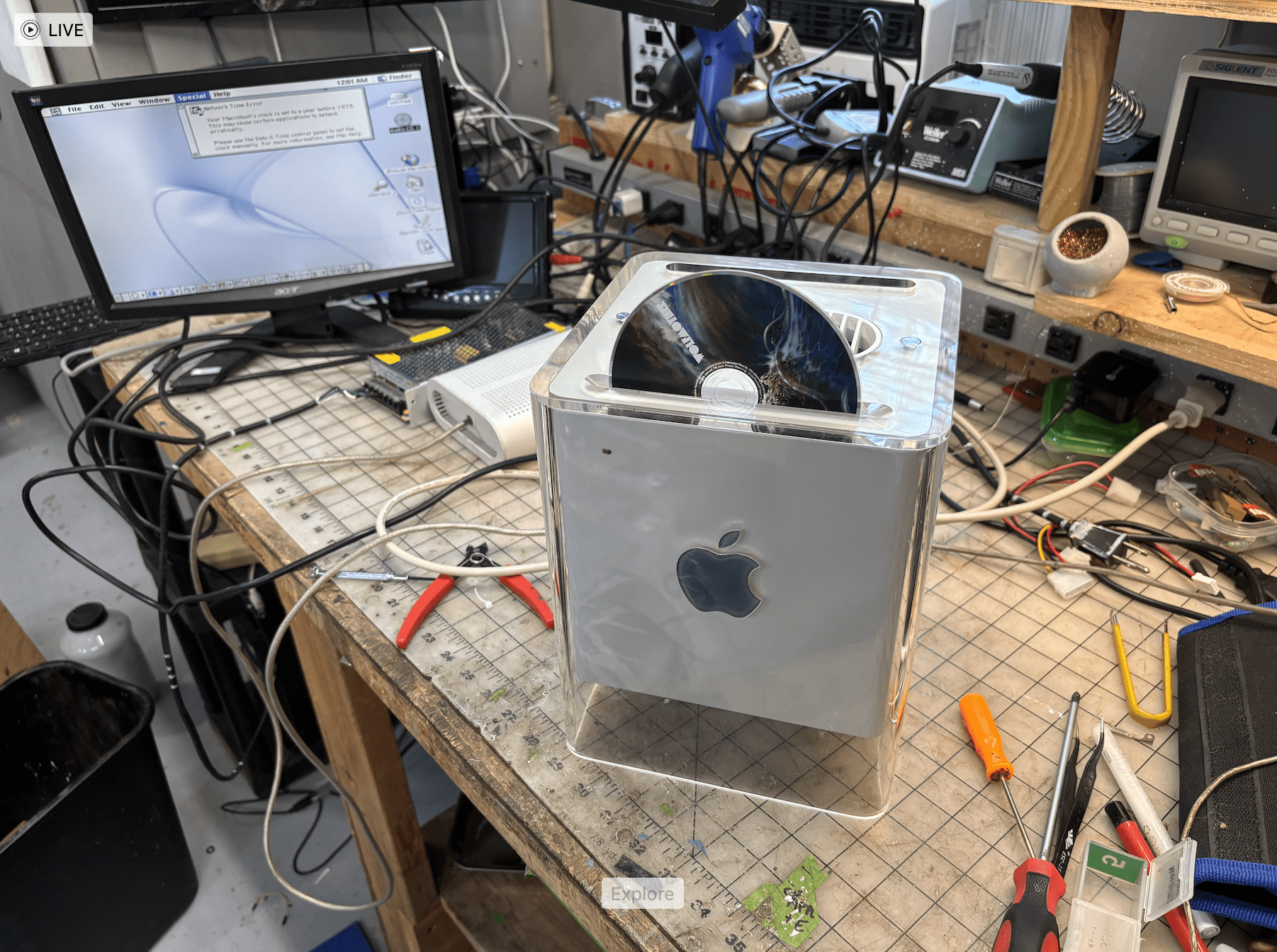

T TJ812 New Tinkerer Jul 7, 2025 12 8 3 Sep 9, 2025 #22 I received the IDE adapter and it does work fine. a great fit. here's the eBay link: Supermicro IDE Adapter SCD812 for SLIM CD/DVD OPTICAL DRIVE | eBay OneSupermicro SCD812 Slim CD ROM DVD Optical Drive Ide Interposer Converter Adapter. - SCD812 Rev 3. P/N: SCD812. Slim CD-ROM IDE (ATA) Adapter- SlimLine for PC server 40 pin IDE to slim CD connector Laptop. www.ebay.com Reactions: indibil and Scorpio_ny
T TJ812 New Tinkerer Jul 7, 2025 12 8 3 Sep 9, 2025 #24 and liftoff! ejects great! Reactions: phunguss
S Scorpio_ny New Tinkerer Aug 8, 2024 31 22 8 Sep 11, 2025 #25 I have updated the walkthrough with the new adapter. Thanks again @TJ812 !
