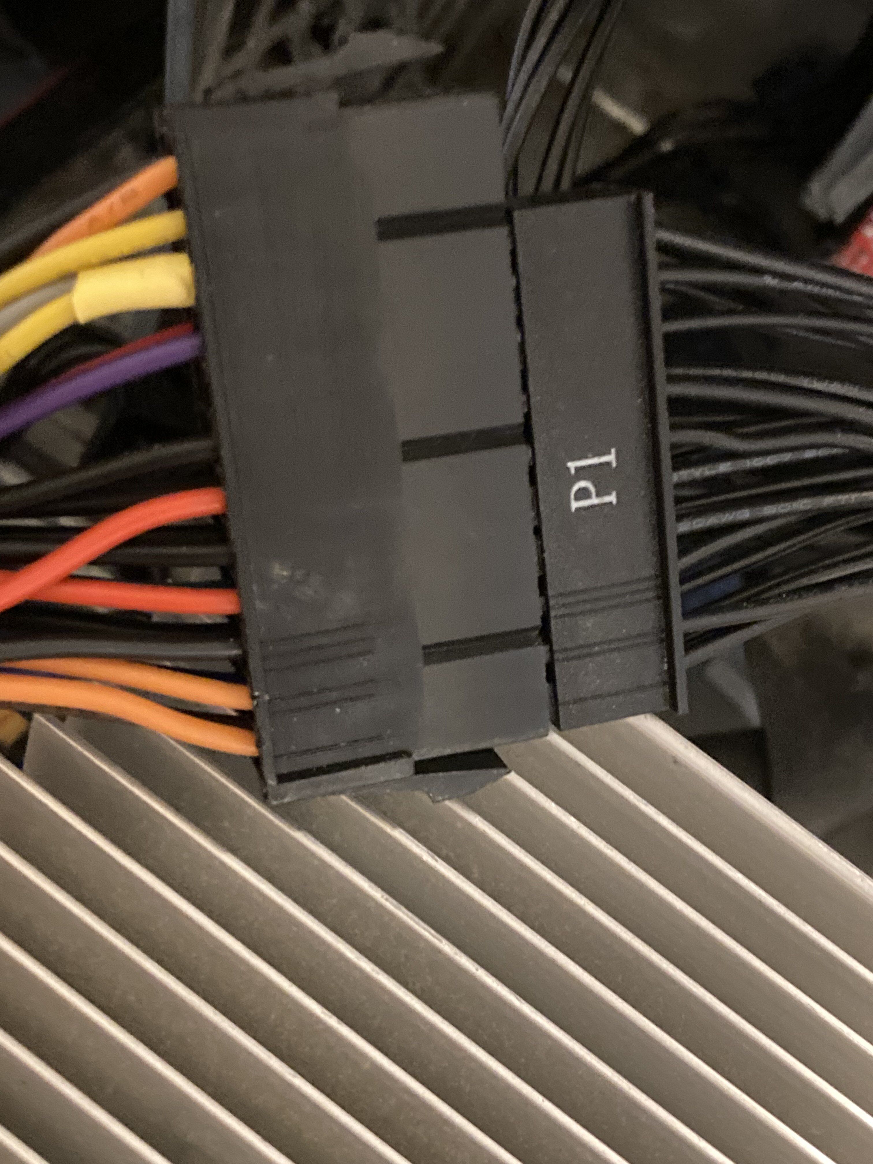

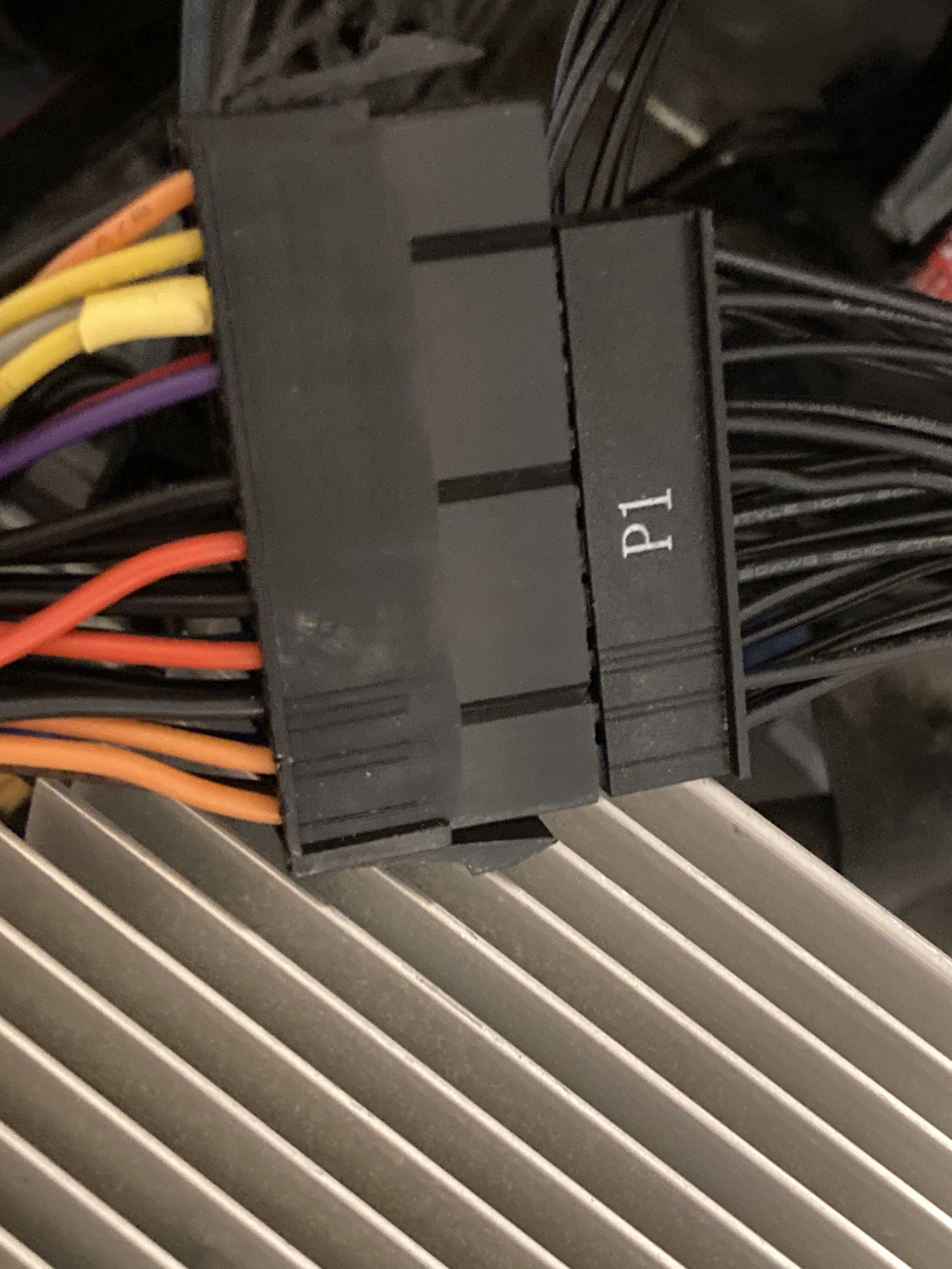

Here are the photos. The adapter is DVI to VGA, and then the VGA cable goes to the back of my 32-inch Panasonic Viera TV. Also, another problem-I was able to connect the mechanical HD & SSD to the two power connectors, but there's nothing left to connect to the CD-ROM drive.
It's been a long day-I've spent longer on this project than I expected. I'm still going to put back the old PS for the time being, and then figure out how to deal with these problems later.
Thank you all for your help! Any other suggestions are welcome. :)

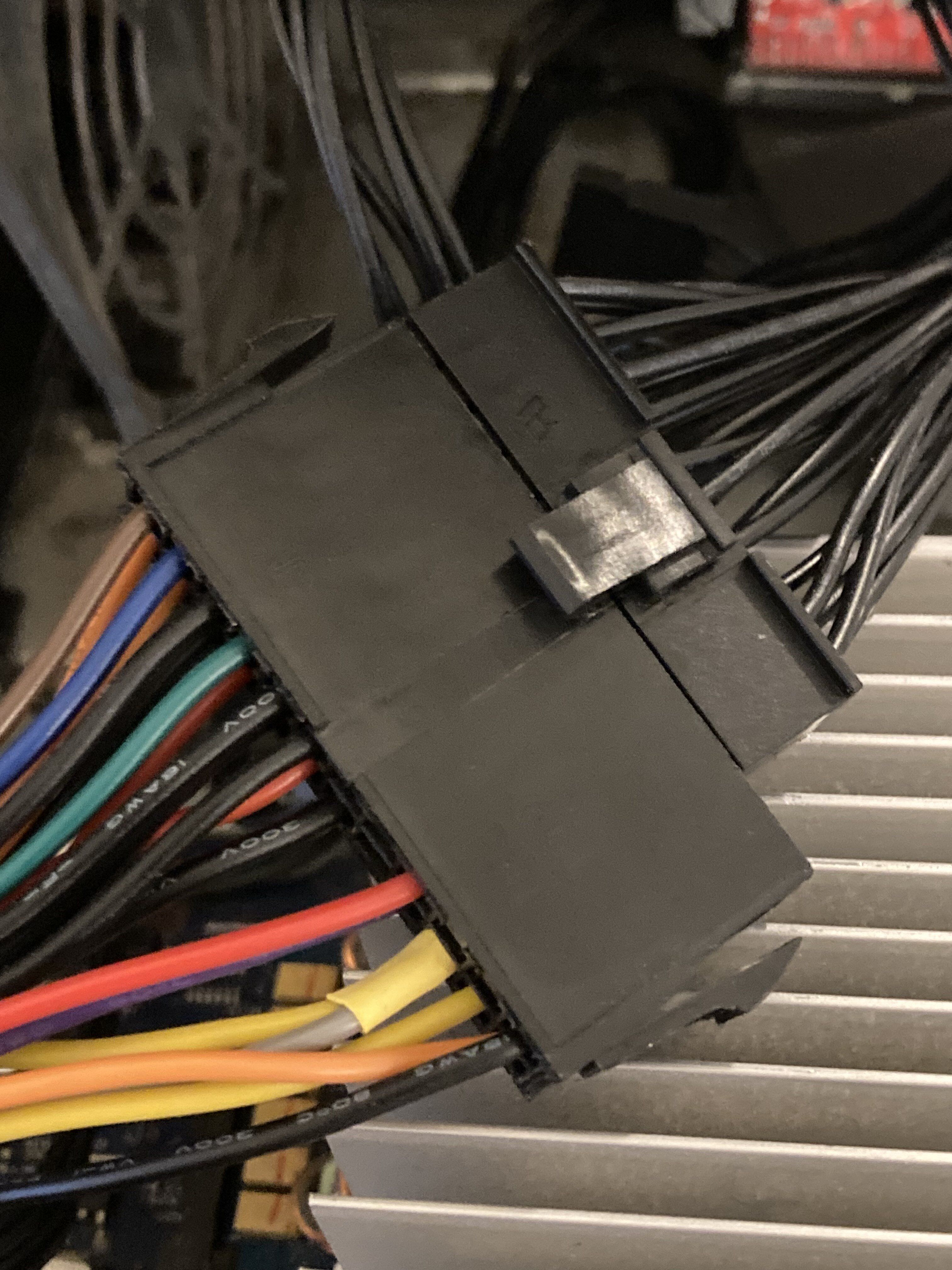

I reassembled the MDD Mac with the old power supply reinstalled. It's in working order again. I plan to hold onto the new power supply., since it seems to work. The question is: why didn't I get a picture? I also need to figure put a way to add power extensions to the CD-ROM drive, since I could only power the boot up mechanical HD (OSX 10.4) and SSD (OS9).
I guess this is my MarchIntosh project, eh? 🙃
