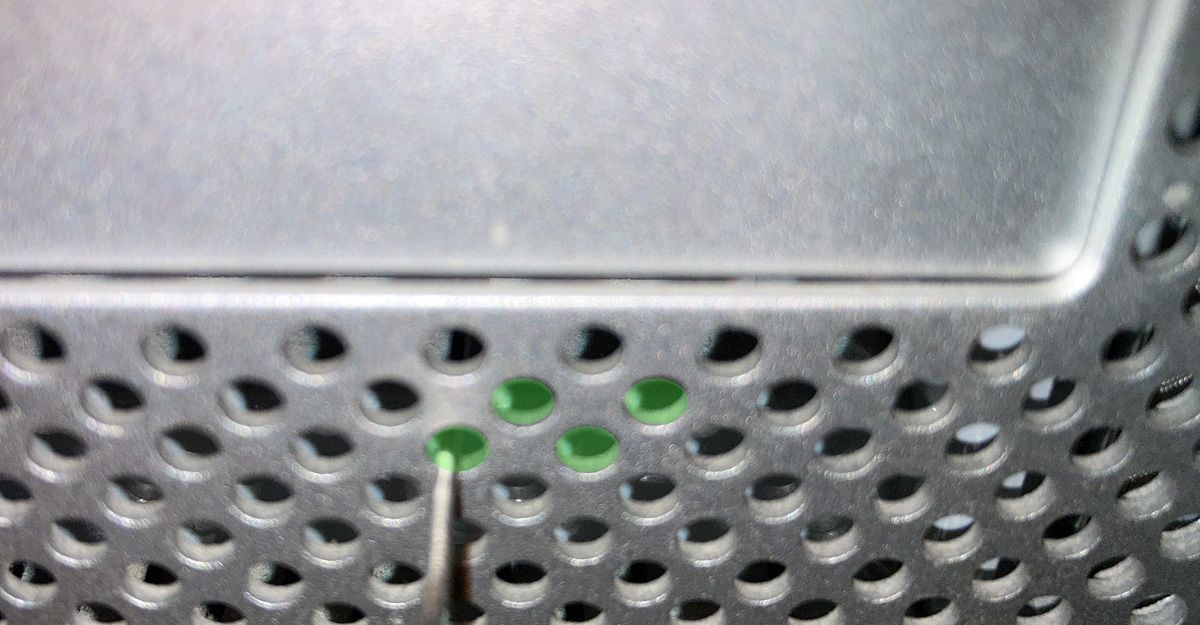

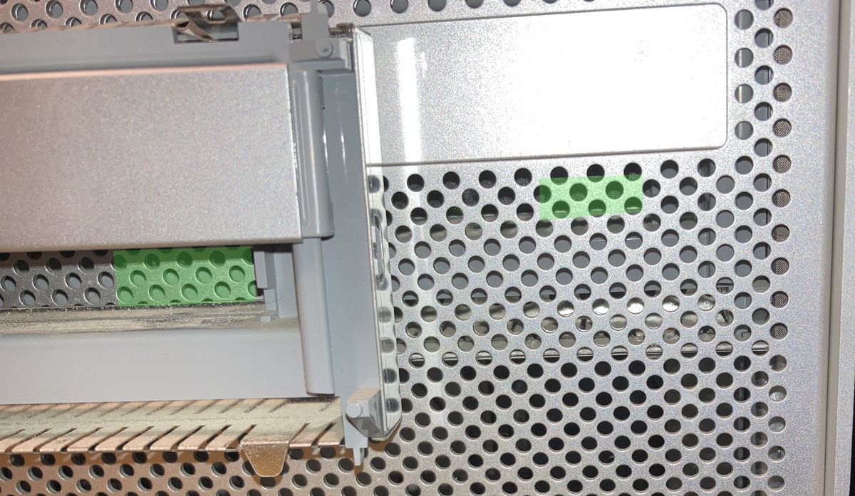

Here is an external reference shot with the optical drive door assembly on the outside of a G5 model so you can compare... The door slides downward. Look at the gap on the left green zone... you have to put an extended paperclip through the holes to push the eject button. Paperclip has to be inserted approximately 3/4 of an inch. You should be able to feel the bubble button.
So you will be inserting the paperclip on the green zone on the right (above), choose one of these holes to feel around with the paperclip (below). You may have to angle up or down a bit to find the sweet spot. You are looking for the big square eject button, NOT the tiny pinhole to manually force an eject. Now, remember that the door slides downward, so as soon as you press that button, yank out your paperclip so the downward door does not jam and the cd fails to open.

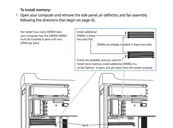

The ram should be matched in dimm 1 of each ram bank, meaning if you run matched pairs in dimm 1 & 2 of one ram bank, the machine will not work. Here's a visual that should help orient where your first matched pair of ram should be placed.
Another way to think about it is when you are inside your powermac g5 with the fan removed, along the upper right hand corner of each ram slot, the slot will be numbered 1,2,3,4 etc. Stick the first matched pair of ram in the slots numbered one (there should be a single slot labeled 1 in each ram bank), slot 2 for the second matched pair etc. This is how you install ram into a Powermac g5. I hope this gets you up and running.
Good luck.

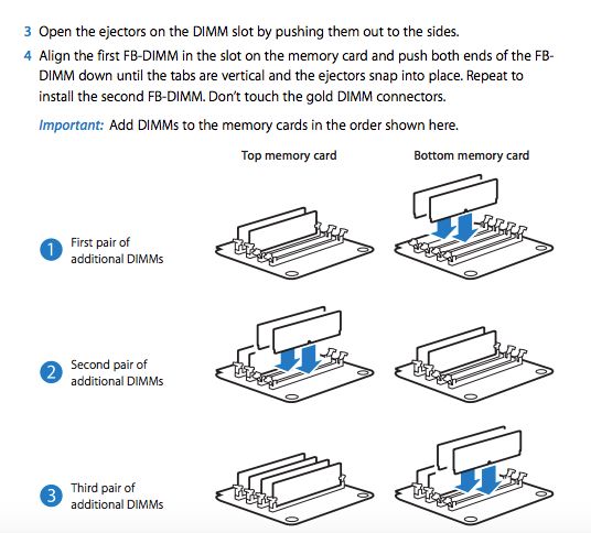

Oh I just realized you said "boards" in your previous post - as in memory riser cards possibly? The name of your thread is confusing as it has parts of two (internally) very different machines. How many cdrom slots are on the front of the mac? One slot will be a Powermac G5 (PowerPC) which correlates to my initial instruction above. Two slots will be Classic Mac Pro (Intel) which are different machines. To install ram into cMP, follow these instructions.
Use this instruction to ensure your ram is correctly installed before moving forward.
Good luck! :)

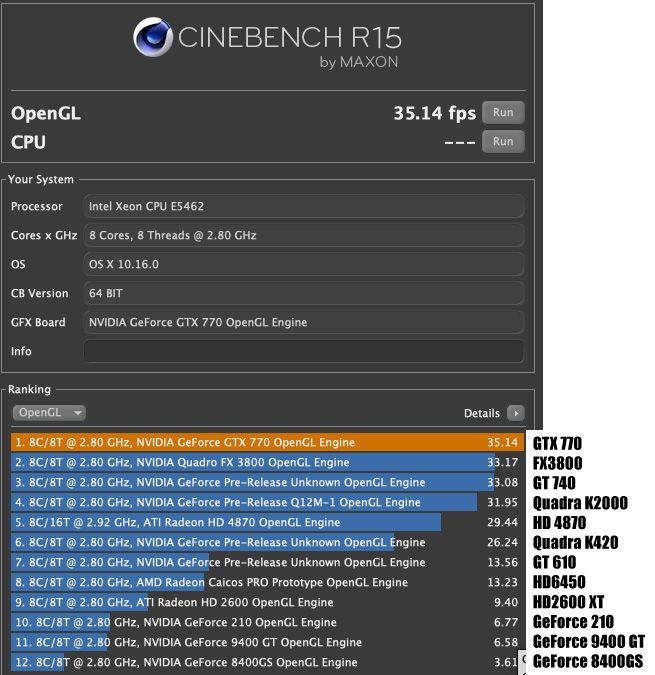

Ok, so now that we know it is an INTEL vs G5, there are lots of cheap options for video cards. Check out this thread on some confirmed PC cards that are not flashed to mac, but video shows up once the OS boots. OCLP can give you a boot picker screen with these cards (NOT an EFI picker ie the option key).
I also did some recent testing with other PC cards, nothing formally compiled, but here is a quick list:
9500 GT
9600 GT
GT 730
Quadro K600
Quadro K4200
RX 460
RX 560
RX 580
Those that require power will need either the special mini-mobo connectors or some sort of SATA/MOLEX adapters.

Ok, what cMP do you have exactly? You can figure this out on the sticker on the back of the mac below the PCIe card slots.
In relation to your ram, you want to make sure the sticks are equally sized pairs - so two 512mb for exmaple and NOT a 512mb and a 1gb as an installed pair. Your cMP accepts 512Mb, 1GB or 2GB FB-DIMMs. Check to make sure they are identical. Their spec is below:
667 MHz, FB-DIMMS
72-bit wide, 240-pin modules
36 devices maximum per DIMM
Error-correcting code (ECC)
If you are satisfied that your ram is correct and in good order, move forward.
