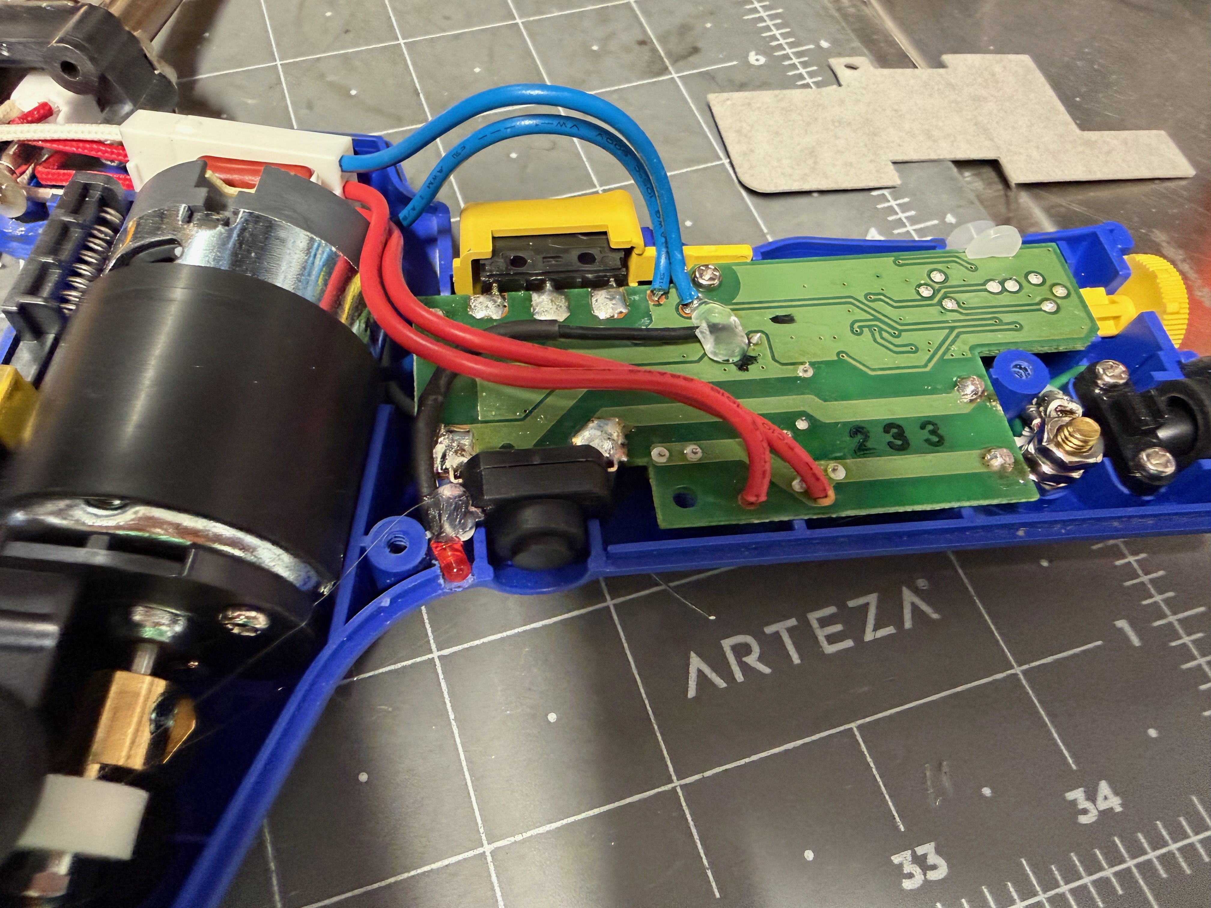

Inside the handle is a small control board with a thin piece of cardboard-like material which is held in by a single small phillips screw. With the cardboard removed you will see the two points where I've attached my thinner red and green wires, such as the photo below. You can see this is at the rear power switch.
On the other side of these new wires I attached a 120v neon bulb which I had laying around (inside an old switch). You can also buy 120v LEDs, though this example LED's long housing may get in the way.

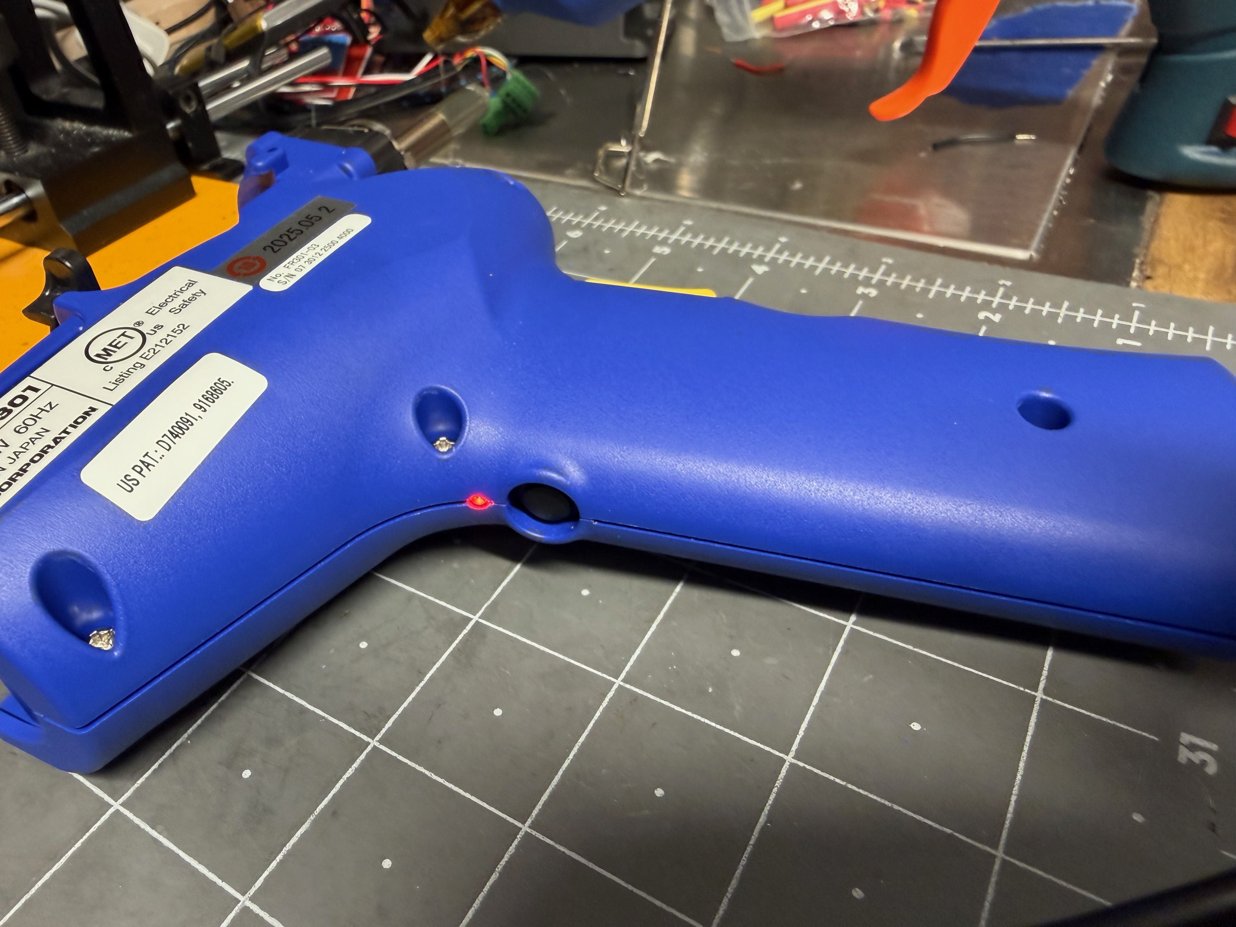

Now I must do that which cannot be (easily) undone... drill a small hole and then route the wires into their new home. Thankfully, there's a bit of extra room at the front but if you don't like this location then you will find a few alternatives — just use your imagination.
The image above is a great example of the problem. This Hakko FR-301 is powered on but the provided white lens near the bottom isn't lit up.
