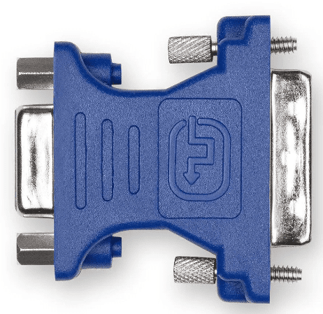

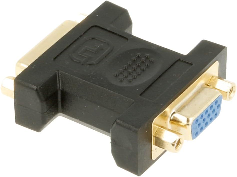

So if you have the official apple adapter... it would go something like this:
VGA output from computer
Standard VGA cable
Standard DVI-VGA adapter -

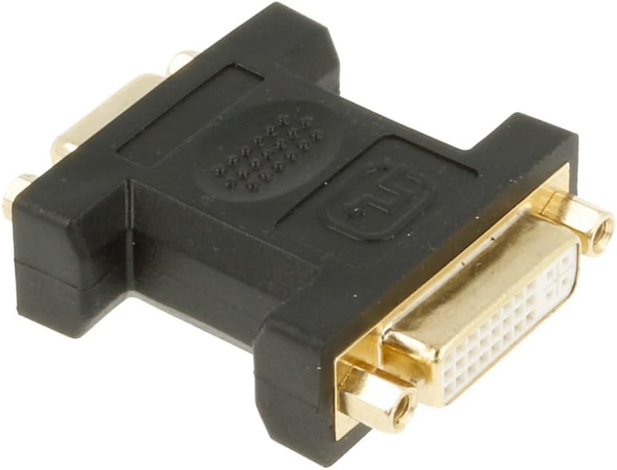

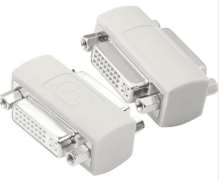

DVI Gender Changer (Female to Female) - This part you are likely missing.

Big jumbled mess of adapters, but it should work.
