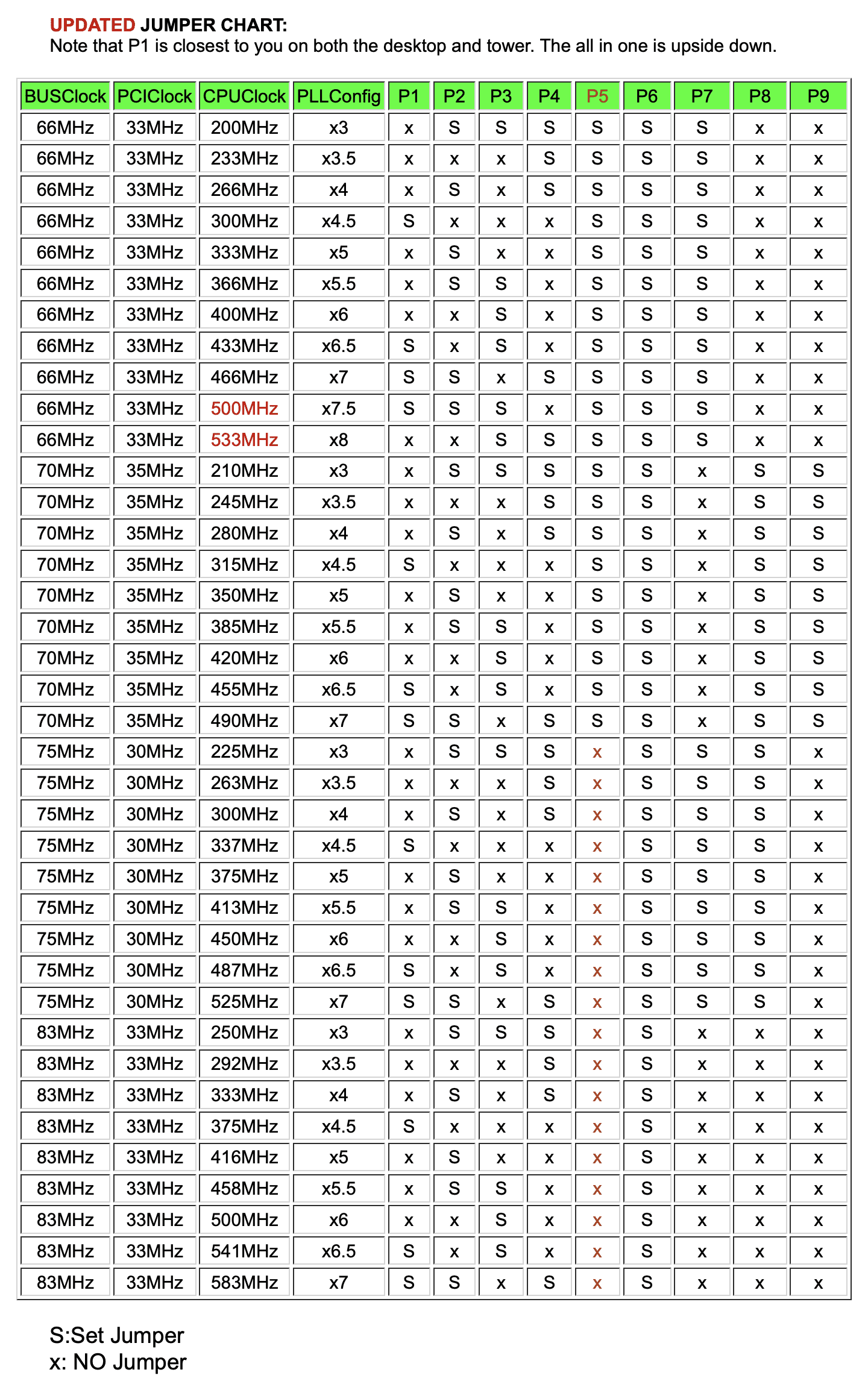

Just in case, I attach the positions of jumpers.

So just making sure I understand your response. The 500MHz upgrade was great, vs the native G3 333, previously used 266? I believe I will mostly use 9.2 so will also look at those other options. I also plan on installing a BlueSCSI v.2, and I should have mentioned that this machine already has a Rage ATI 128 from a B/W G3 installed as well.
