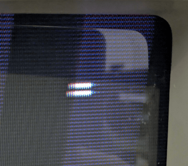

InexorableTash
Mar 20, 2026
c/o a willing tester, using a IIe and Composite Monitor IIe. Single hires display. Top line ends with $FF, next line ends with $7F. Obvious shift on the left, but seemingly end at same place on the right. So looks like the answer is: 560.

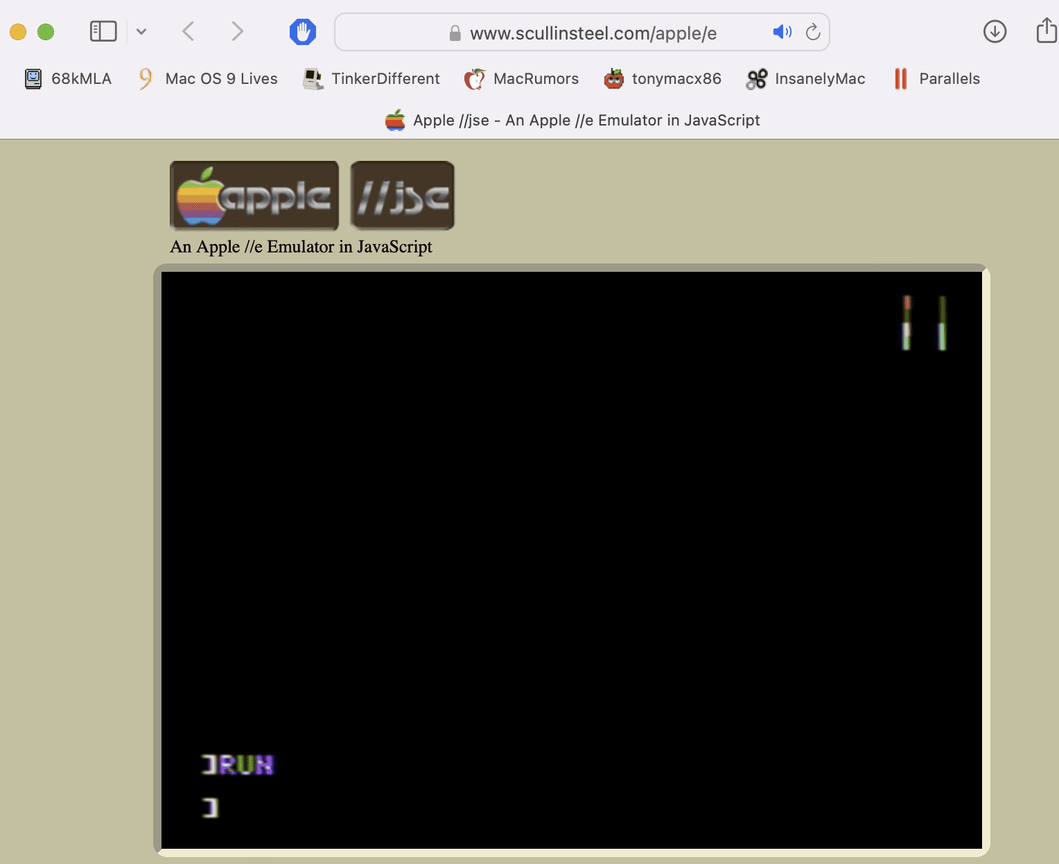

If that's the case, then this should show DHR colors on the right hand side of the display with the corresponding HR colors to the left of that (mixed with the same DHR colors):
Code:
10 HGR : HCOLOR=7
20 HPLOT 279,0 to 279,19
30 HPLOT 278,10 to 278,19
40 HPLOT 265,0 to 265,19
50 HPLOT 264,10 to 264,19
60 HCOLOR=4 : HPLOT 266,0 to 266,4 : HPLOT 266,10 to 266,14
The DHR colors (brown and aqua) have the same phase as the corresponding HR colors (orange and white) but are half a dot narrower.
Line 60 sets the palette bit of the next byte for the top half of each color in the left line which allows the HR color to not get truncated.
Setting the palette bit of the left most byte of a line should not affect the truncation happening on the right hand side.
