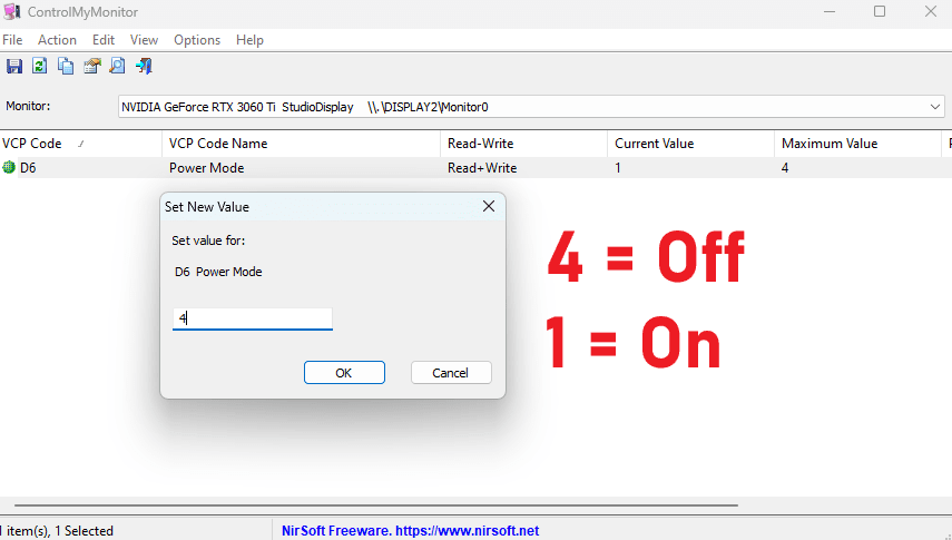

I've been looking into figuring out if I can modify my display's geometry recently and I may have found another method of controlling power mode that doesn't require python. It's a program called ControlMyMonitor and it really does just that. It's a portable .exe that doesn't have all the fuss that monitorcontrol.exe requires.
I found that VCP code at position D6 corresponds to the power mode, setting this to 1 results in a wakeup, setting this to 4 results in a soft off. I don't know what 0, 2 or 3 do, as nothing happens when I try to write those values.
This program offers a pretty handy GUI for debugging and offers command line inputs as well, so you can automate this via a power shell script as well. I'll probably get around to migrating my startup script to this eventually, my monitorcontrol.exe setup is fine for now.
