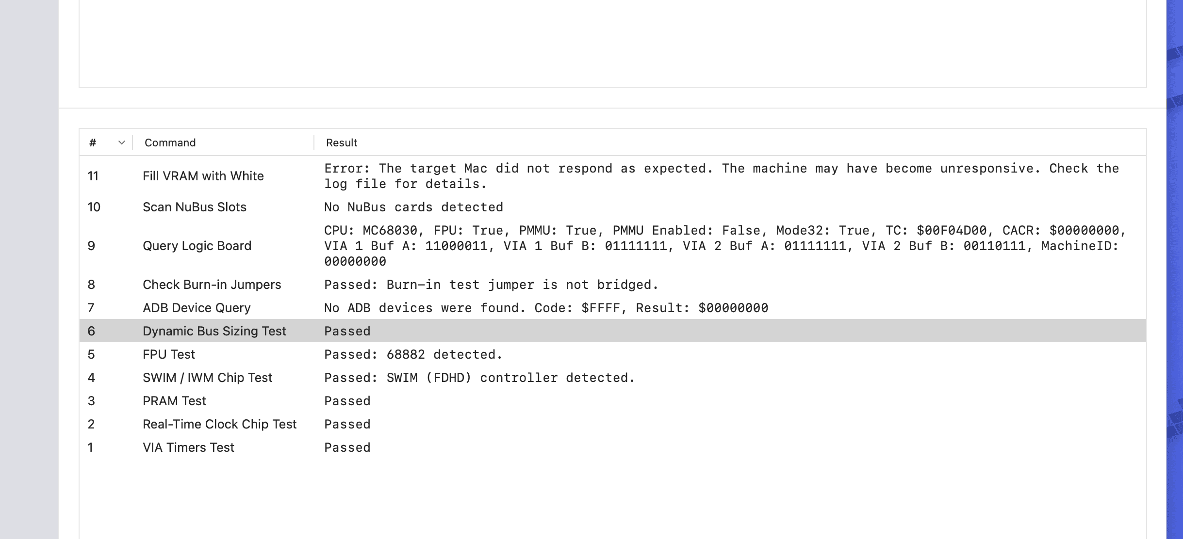

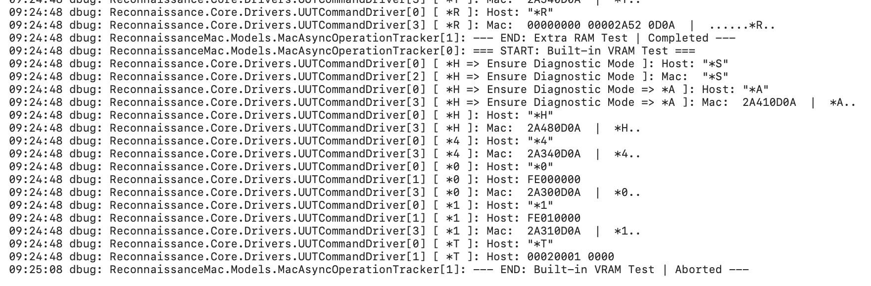

Well my otherwise happy SE/30 reloaded board boot chimes but went back to simasimac on the screen. I ran Reconnaissance and it stops at the VRAM test with the following codes.
I've swapped out the VRAM, Video PALs and Video ROM (and back) none of which appear to be the culprit (no difference). Hoping it's something simple. I just have no idea how to interpret the codes. Would like to learn if there's a reference somewhere. Thanks for any help.
