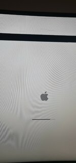

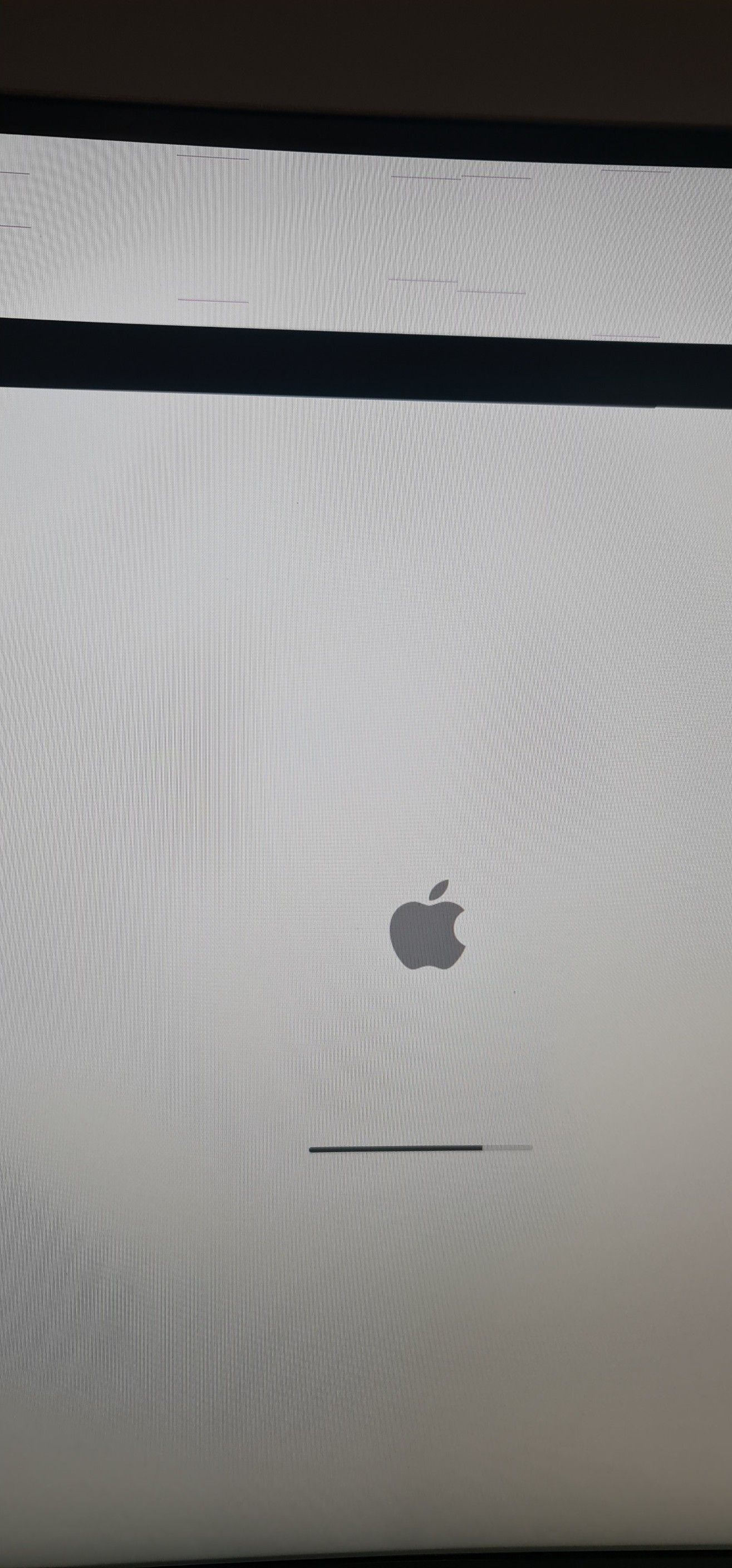

I think I got rid of OCLP (OpenCore Legacy Patcher). But now Mojave just doesn't finish installing. gets near the end of installation then corrupt graphics shows on the screen. I think something is up with the mac pro. It did this with my 2TB SATA drive and my 1TB NVME running on a pcie card

I wasn't counting, but it may've been 3-4 minutes of nothing moving like the photo. Does it matter if I plug the USB drive into the back of the mac pro? The USB drive is currently plugged in the front.
I would wait at least an hour. Front or back USB should not make a difference. A lot of times with the USB2.0, it seems the machine has frozen. Sometimes I put a piece of blue tape on my monitor just to see if the progress bar is moving. It should take a minimum of 30-45 minutes to do an install, depending on your USB stick and your internal drive speed. One report on reddit said it took the user 7-9 hours.
