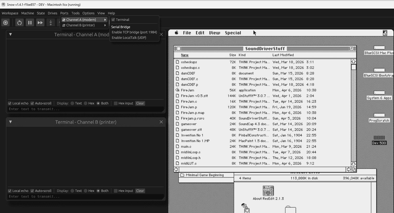

Step 1: In snow, make sure you have an emulation environment running (ie you booted in Finder or similar). Go to Ports menu, pick Channel A or B, and 'Enable TCP bridge port 1984'

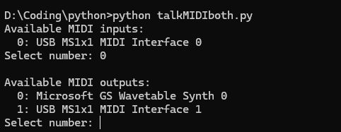

Step 2: Run a python script (adapt to your needs) down below this post in a cmd window to get your machine to listen/talk to TCP port 1984 and interface with the USB port where your MIDI or interface gear is connected. A menu selection in the python script lets you confirm to which MIDI device connected on the host machine you're sending to.

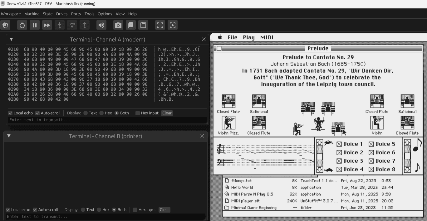

Proof of it working in Concertware+MIDI:
Proof of it working in Firejam, sending MIDI to my external Roland MT-32 module:
