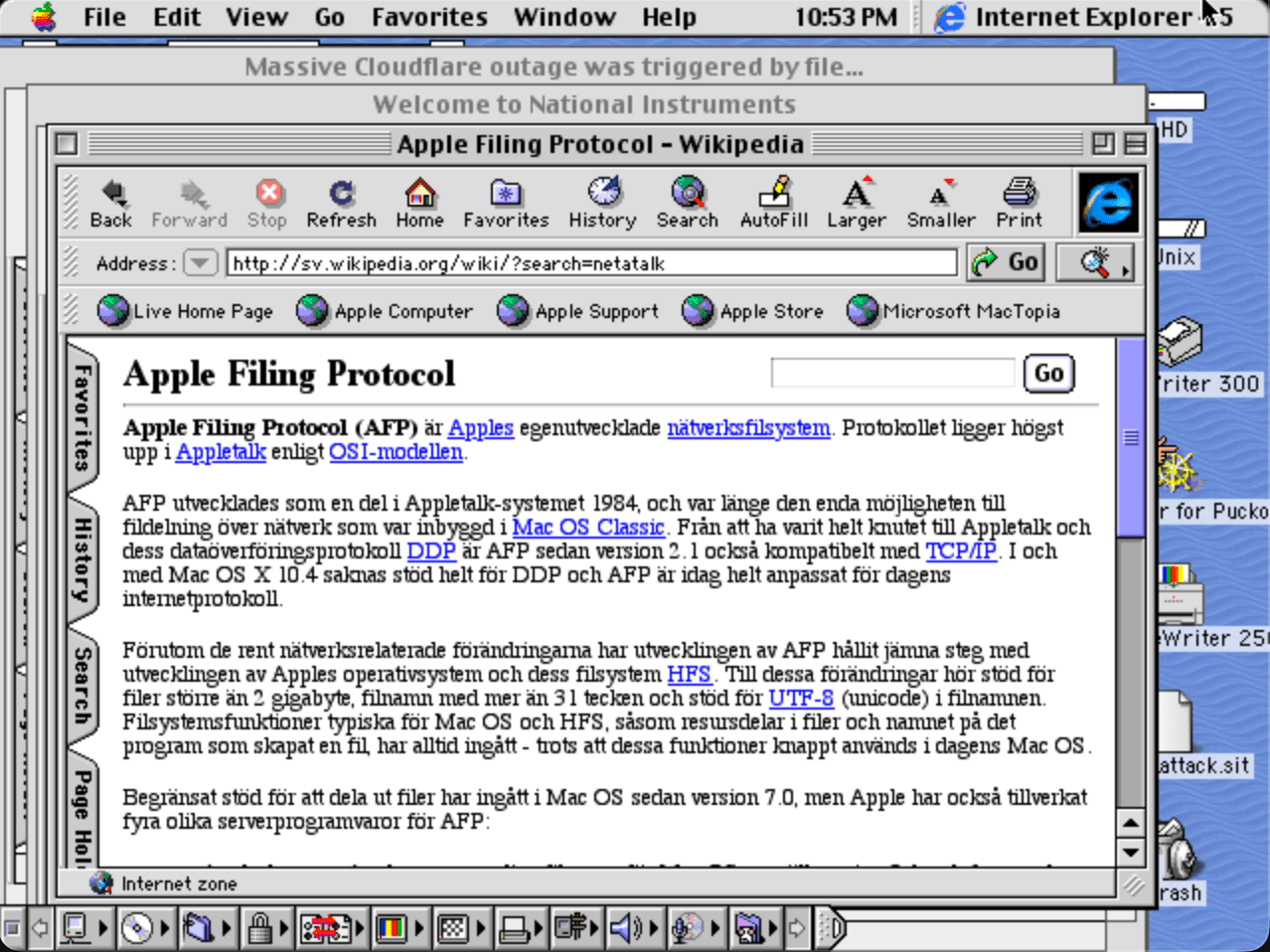

Figured out the easy way to get embedded images working! I tweaked the proxy logic to only modify the contents when content-type is 'text/html'. This way, any traditional embedded image (<img src="">) in traditional formats (jpeg, gig) work absolutely swimmingly on a higher-spec 68k Mac (Performa 476 below).
It slows down page loads in MacWeb on my Mac SE a bit since it has to handle a bunch of "image load errors" but still perfectly usable.
The problem to tackle is binary file downloading. It works fine if you 'save as' with the latest change, since the proxy no longer tries to mess with non-html contents, but I need to tweak the response headers a bit for the user agent to recognize it as a binary stream, I think.
