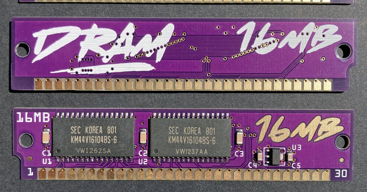

And they don't work. Does anyone know of any reason these would not work in an SE/30?
Any suggestions would be appreciated.

I have the BMOW RFOMInator II in my SE/30.Hello my friend!
I am thinking that you would best be to contact the seller on tindie!
I filled all 8 slots and they seemed a little loose so I printed out the RAM SIM clips and put them on which seemed to hold them tighter in the slots. ( There is one slot clip broken) but as I said the simms seemed OK with the clips in place. And I diid put the old ram back in after to retest it and the SE/30 is still fine with the old RAM (4x4MB SIMMS and 4x1MB SIMMS).siliconinsider usually does a great job. I have 4x4MB SIMMs from him in my SE/30 which work great! The SE/30 however is very picky about RAM. Did you install them correctly? What are the symptoms?
let us know if it worksI got a message back from siliconinsider saying the thin board of the SIMMs is a know issue with the SE/30s dodgy slots and suggested that a number of people have had success by using kapton tape on the back of the SIMMs as a shim to tighten the connection to the slot. I will give it a go.
