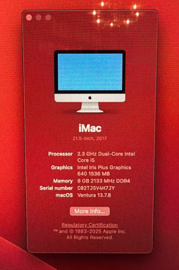

Hey folks,
An old buddy reformatted his 2017 iMac-it's now running Ventura. A couple of years ago, I bought a clamshell iBook off of eBay and it came LOADED with games. They are currently sitting on my G4 MDD which is dual boot-OS9 & OSX. They play very well on OS9.
I want to send these games his way, but I need to install an emulator on his iMac that will allow me to run these classic games on Ventura. Any advice on what I could use? I guess everything will need to be installed via thumb drive.
Thanks!
