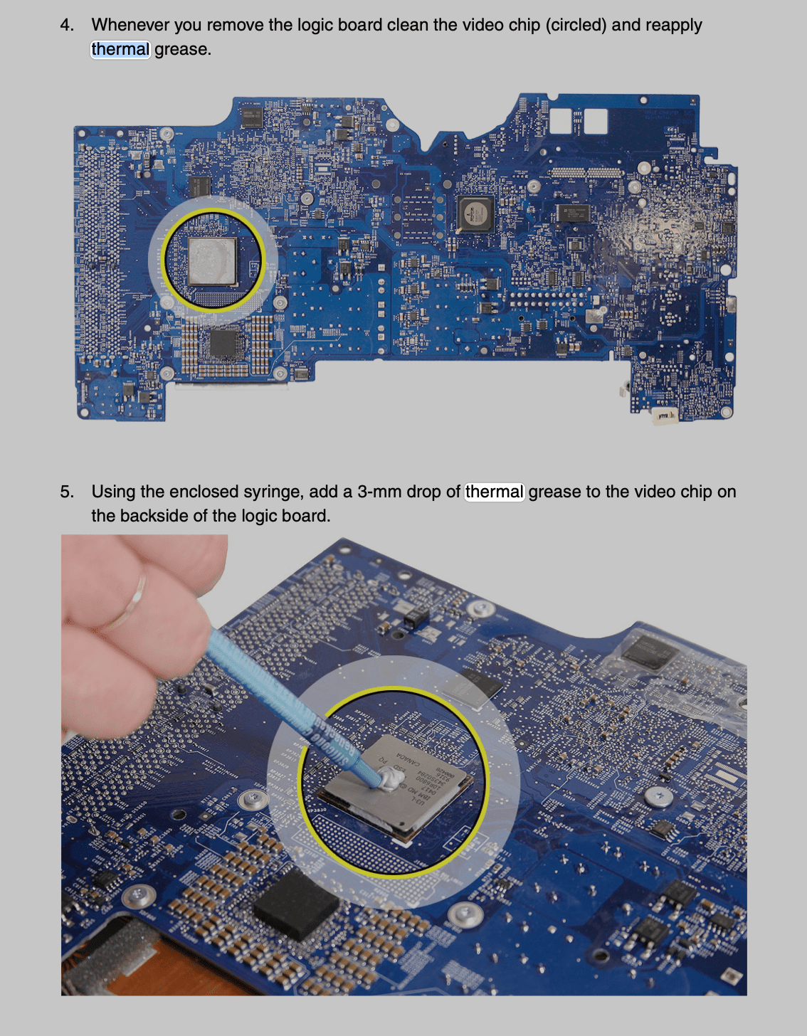

I also just noticed in the service manual that there is also a hidden thermal contact on the back of the logic board. So I am not sure if you removed the whole logic board or not or just the heatsink that you can see when you open the computer. If you had not already removed the logic board, you probably should not right now because overheating is definitely not your current problem (as you said, its bone cold)
