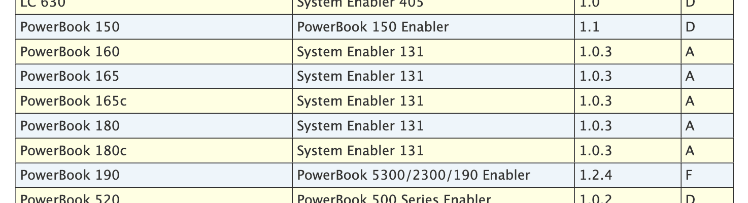

From EveryMac:

What are you using for your System 7.1 install source? I ask as 7.1 requires "System Enablers" to work on many systems (including the PB 165c) I would expect you'd see that error if you are using a 7.1 install source (floppies? images?) that includes a System Enabler for another model Mac.
Neat page that lists all the System Enablers:

Yeah, I discovered it is System Enabler 131. Apparently the 165c is one of a select few 'oddball' machines that requires this under 7.1, as usually you can just use a "standard" installer with most other 1xx series machines. I've been wondering how/why someone would be selling install disks that are unusable, since they don't have the proper enabler(s) - so that would make far more sense. Going to give it another shot today...
[From Macintosh Garden:]
I think this is normal, that a standard set of 7.1 installer disks will not have all the various enablers included. For systems such as the 165c, you’d need to use the installation media that specifically came with the machine.
Also, I can confirm that the PowerBook 160/165/180 also need this enabler 131 under 7.1. The 140/170 don’t as they were launched before the general release of System 7.1, so the custom code needed to boot these machines would have been integrated into the system.
