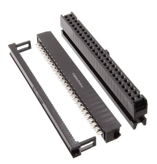

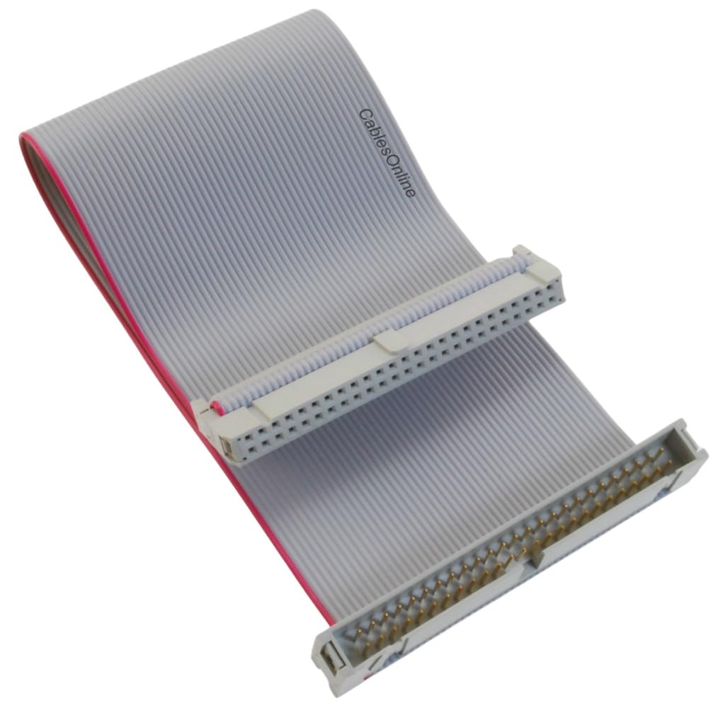

Do you think it would be possible to add a connector like this to the 50-pin ribbon?
I'm not sure if the order of the wires is the same.

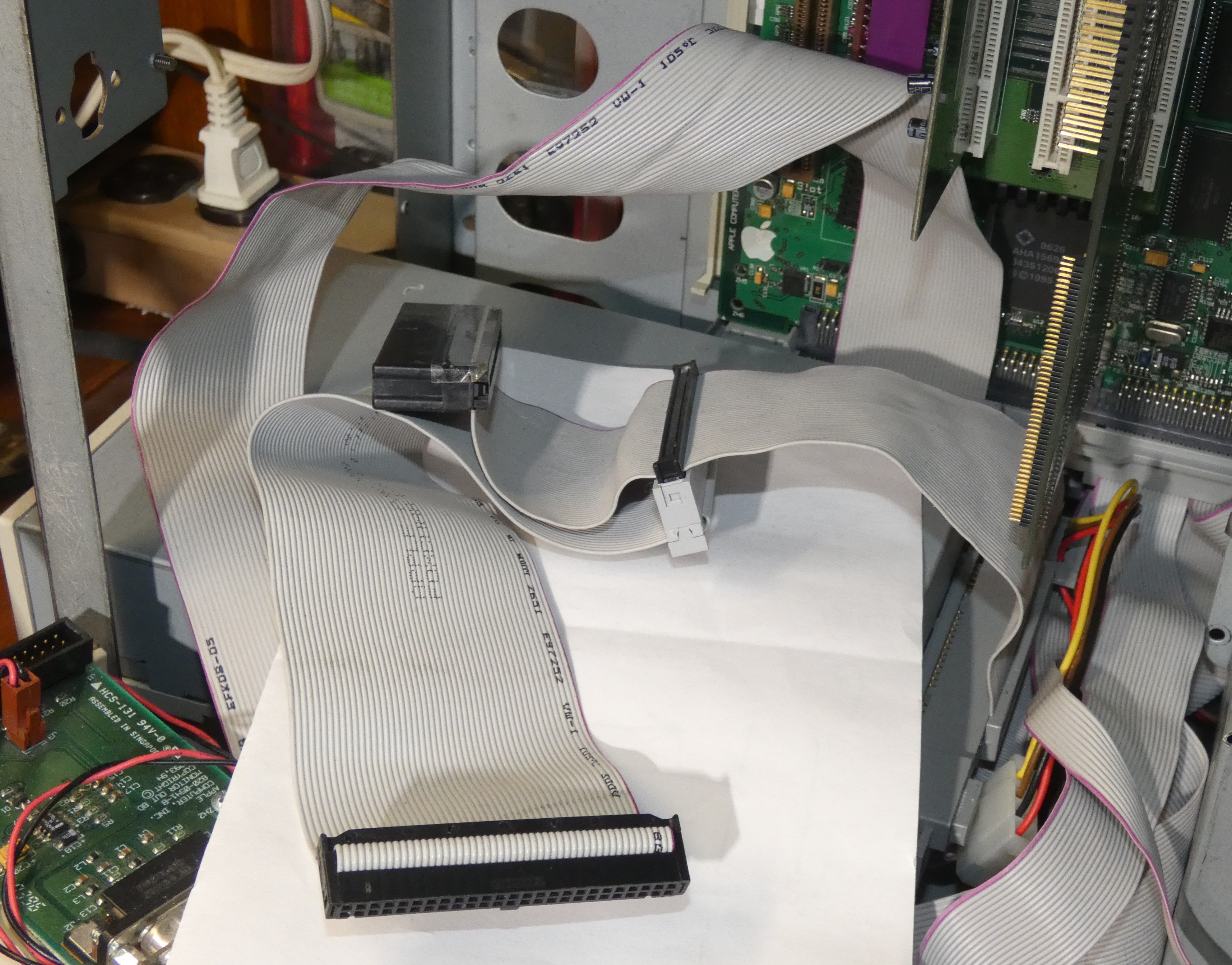

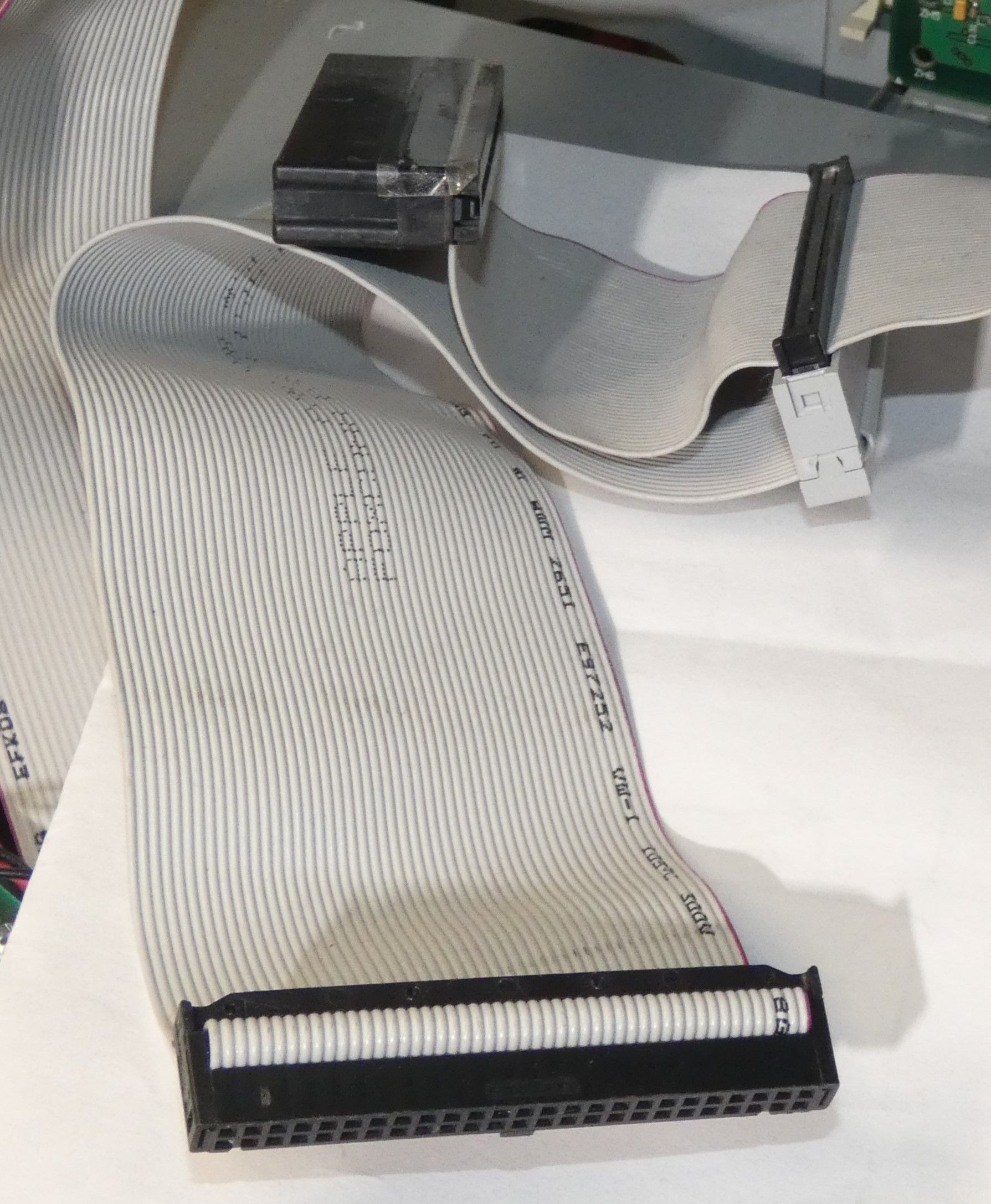

I see no reason why you can't crimp an IDC female to the harness just below the CD Connector Bar, facing aft. The connectors don't care on which side of the cable they're installed so long as the keying is correct. Crimp the female connector in a vise just so and then run the extension up overtop the CD bar, installing your BlueSCSI in the CD cubic.
If it has wireless, make sure the antennae are as far forward in the bay as possible. The front bezel has no RFI shielding to interfere with the signal.
edit: forgot you'd posted the connector upthread, that's exactly what you need to do the mod as I've suggested. BTW, does your front bezel have provision for an optical drive to be installed or is it a blank surface like the IIsi or Q605? I've never heard of one without the CD?
