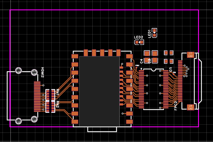

Not finished but, an update non the less. I think this is all that is "needed"! I don't need the LEDS but they will be the power indicators.
My old plan didn't work, but this one will! Right?

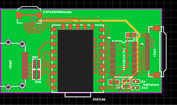

I think finished routing most of the Traces, decided to add an expansion header as well, maybe for DEBUG purposes? It just connects to 4 of the GPIOS one of the Level shifted pins and 5v 3V3 and GND, should I add or change any of those? Also what do you think?
techknight
Moderator
Dec 2, 2021
132
132
North Carolina
I plugged my RP2350 board into my computer, I am supplying external 3v3 power because what I put on didn't work. (Don't follow instructions blindly. Double check.) I but when I turn on the power, nothing happens. Zip, NADA, Zilch. No power pulled, not showing up on my laptop, even in device manager. No file explorer popping up when I hold the bootselect and then turn it on. I double checked the schematic, and that power is getting to where it needs to. I am even getting 1V out of the generator. I don't know what is wrong, if you can give me any pointers that would be appreciated.
P.S. It could be that the RP2350 is dead. I applyed some serious heat when I first put it on the board, but would it still generate 1V if it was dead? And how is it generating Voltage without drawing any amps, so confused 😵
No, when you lay out an RP2350 or likewise design, you have to follow the layout guidelines exactly to a T, or your DC converter doesn't work/wont run. I saw discussion in a different discord where someone was struggling with this.
Reactions: Froggy814
Froggy814
May 6, 2026
171
47
Squaw Valley, CA
You are soooo right... This is now something I will let the experts do, instead of soldering the pi together and designing that myself. Thanks for the info BTW
