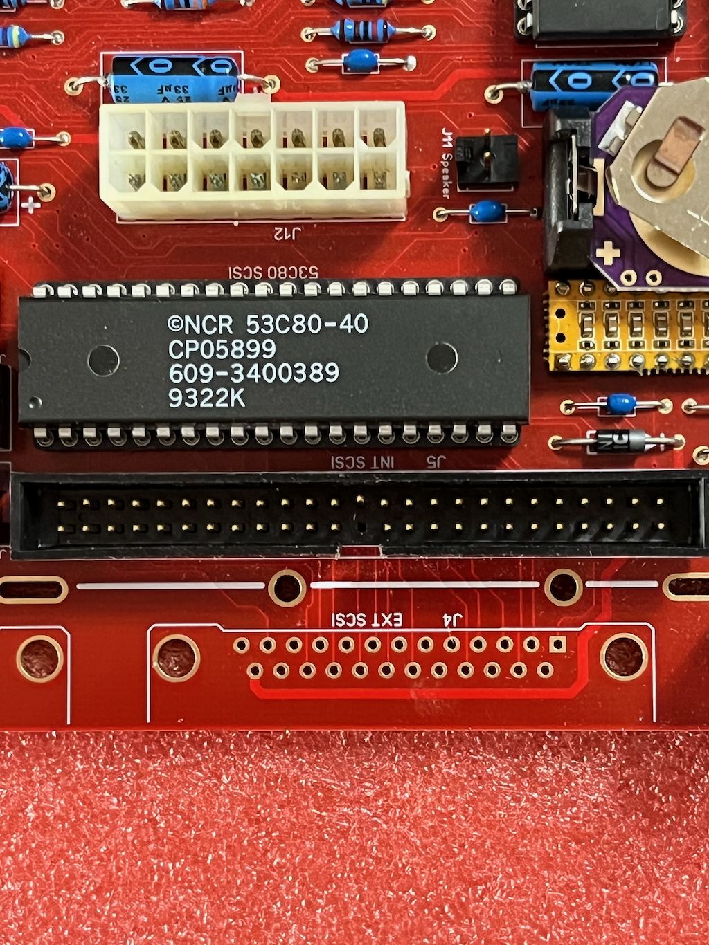

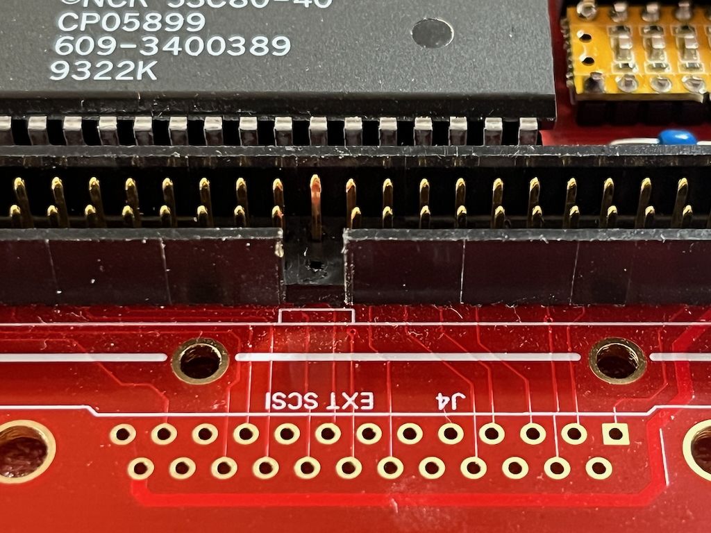

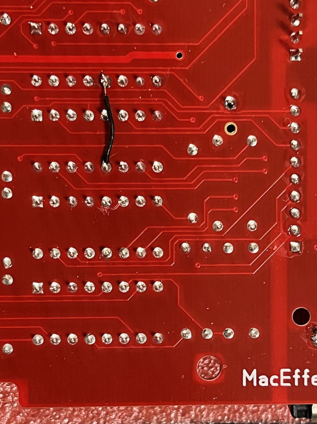

I haven't a serial cable to test my fix on the serial port. But here is the mod :
For the SCSI port, I found the simplest solution. Just remove the pin from the SCSI connector. SCSI is still working after this mod.

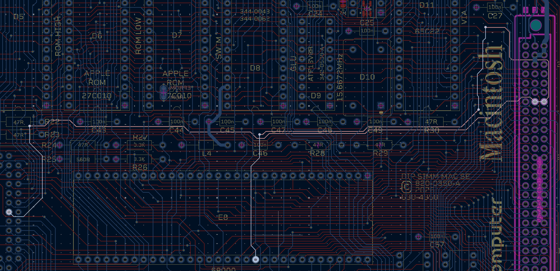

Does someone know why A19, A20, A21, A22 routing from the CPU to the PDS slot and the BBU use so a long path ? Is it to avoid a timing issue ? Here is an example of A22.
As you can see, the path do a full loop before being routed to the BBU...

This was probably routed before most of the CAD tools were in good shape. It looks like there is a lot of cleanup that could be done now. Even this little section is a mess:
It's a relatively simple design and just moving a few traces around clears up space for further cleanup and refinement.

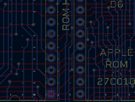

I'm working this way (a bit). I added direct support for both Apple ROMs and 27c010 EPROMS. RC filters can be originals ones or SMD version on the PCB. And I added the frequency divider for better 16F88 support (ADB).

I don't know how many boards were still being routed with scissors and tape in the 80s. I suspect the peculiar routing has more to do with the tools and deadlines of the time vs timing. The signal is relatively slow and high voltage (8MHz 5v?) so I don't think you would have any problems with changing its route. You could compare it to other address lines. With the signal lines on the outside layers it would also be easy to experiment with bridging/bodging/cutting traces to see if it makes any difference.

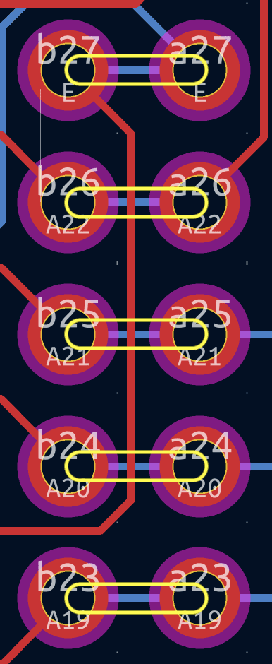

I think I found the beginning of the response. As you can notice on the picture below, Signals E, /AS, /RST and A19-A22 are duplicated on the same row and linked together. All signals from the CPU are routed to column A pins and outputted on column B. Interestingly, signals on column B are notified as reserved on the PDS connector pinout. It's like Apple change its mind at a moment. Maybe a PDS board was supposed to be here by default, and no path between columns A & B on the main PCB. The routing for these signals should have been done on this PDS board. Or these signals should have been substituted by this hypothetical board.
