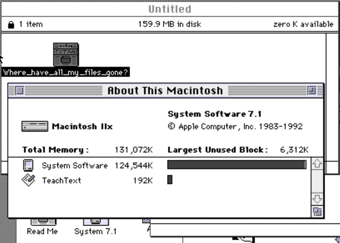

the desktop file on the img wasn't correct and had to be rebuilt
doesn't work on 7.1
