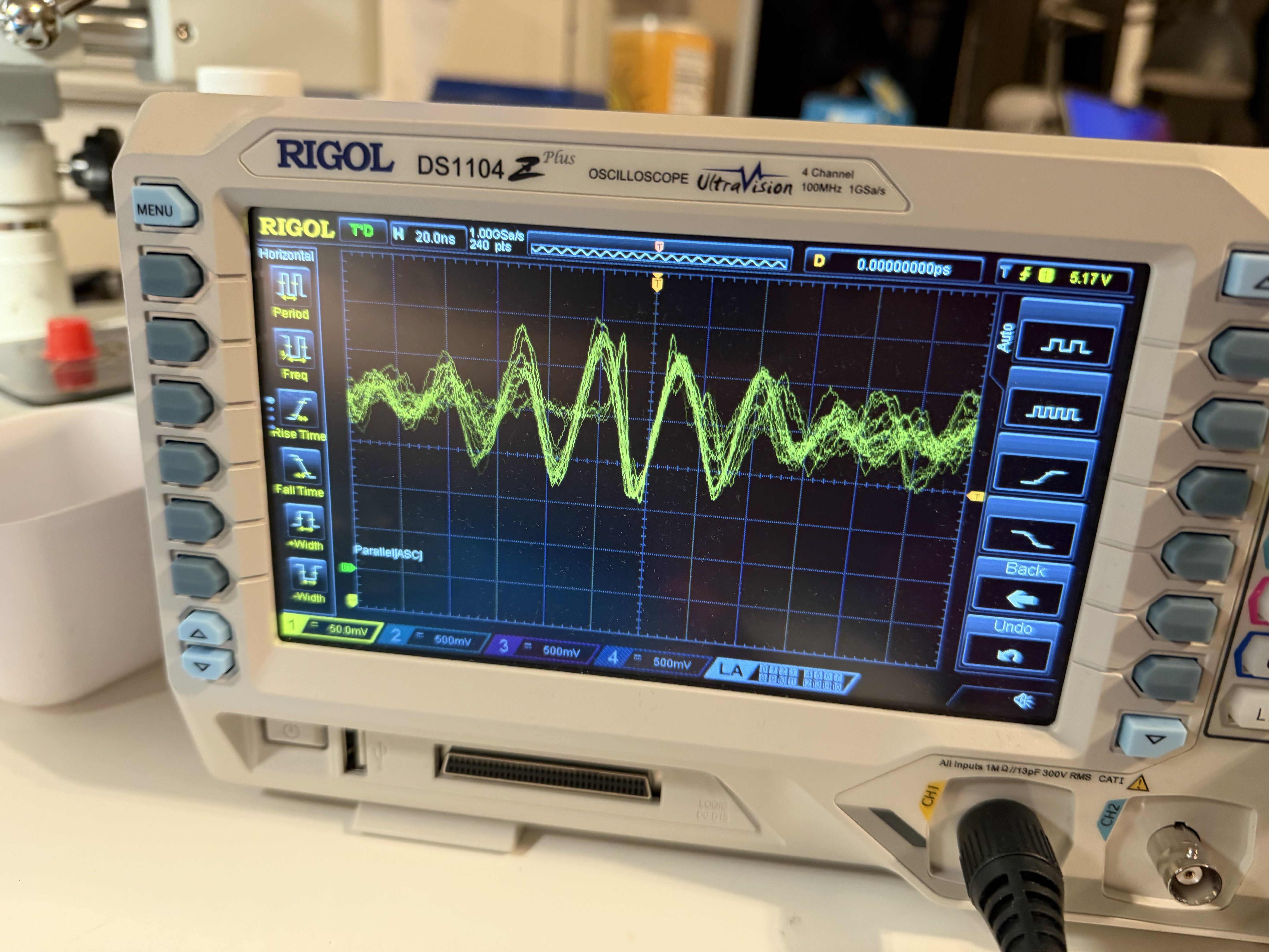

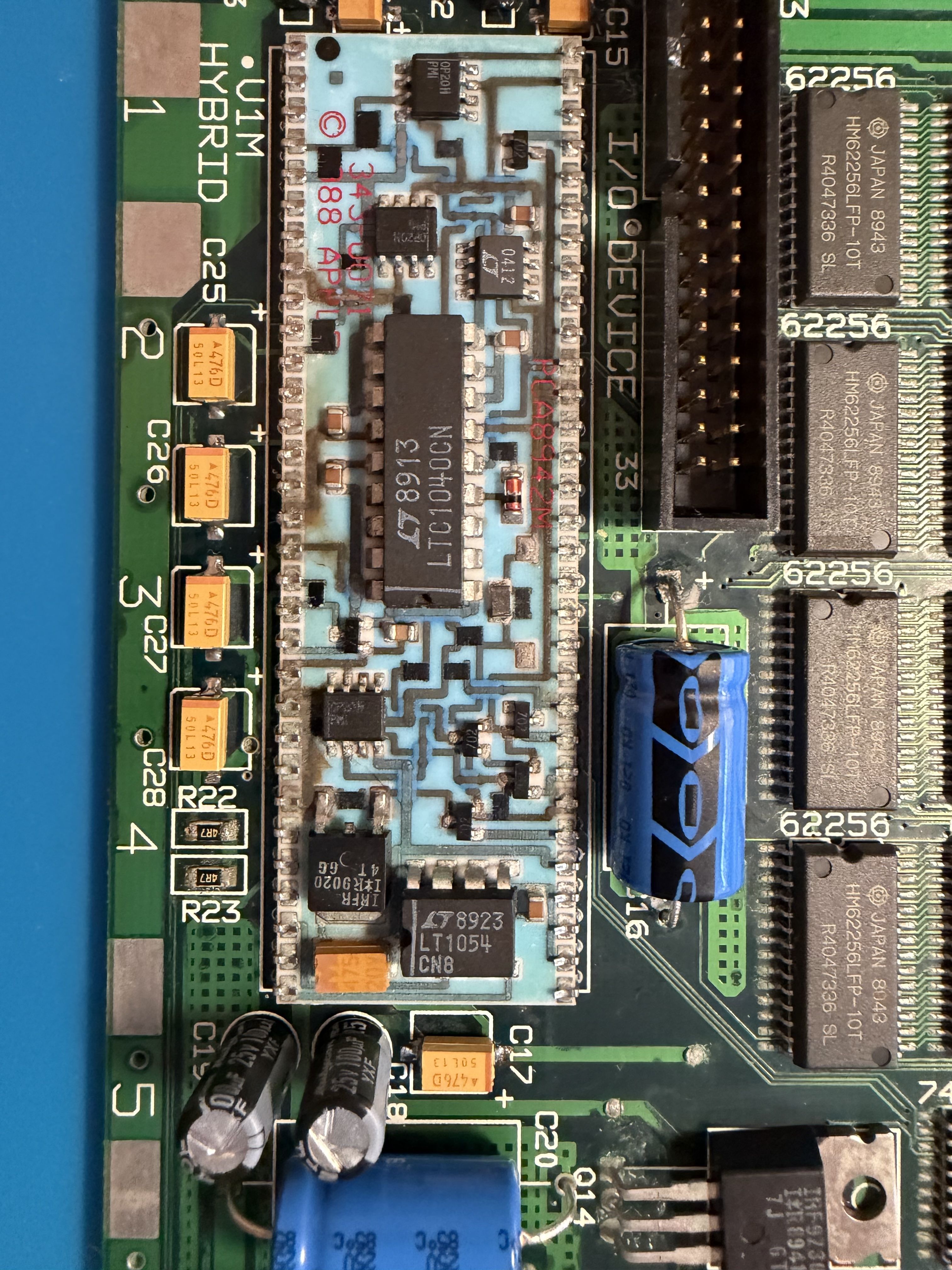

Just wondering if this is what I should expect on the 5V line. I'm new to occiloscope probing and need some guidance as to interpretation... I have a new to me Mac Portable that I'm trying to troubleshoot. I've replaced the caps but have the original hybrid module. There is some evidence of cap corrosion on the board. I get random errors (sad Mac) on boot after the initial good chime. Using a bench supply at 6.5 volts via the J17, I am probing at the VCC pin (28) on the RAM and + side of C16 with the following tracing included below.... I think it tells me there is a lot of noise but want some guidance.

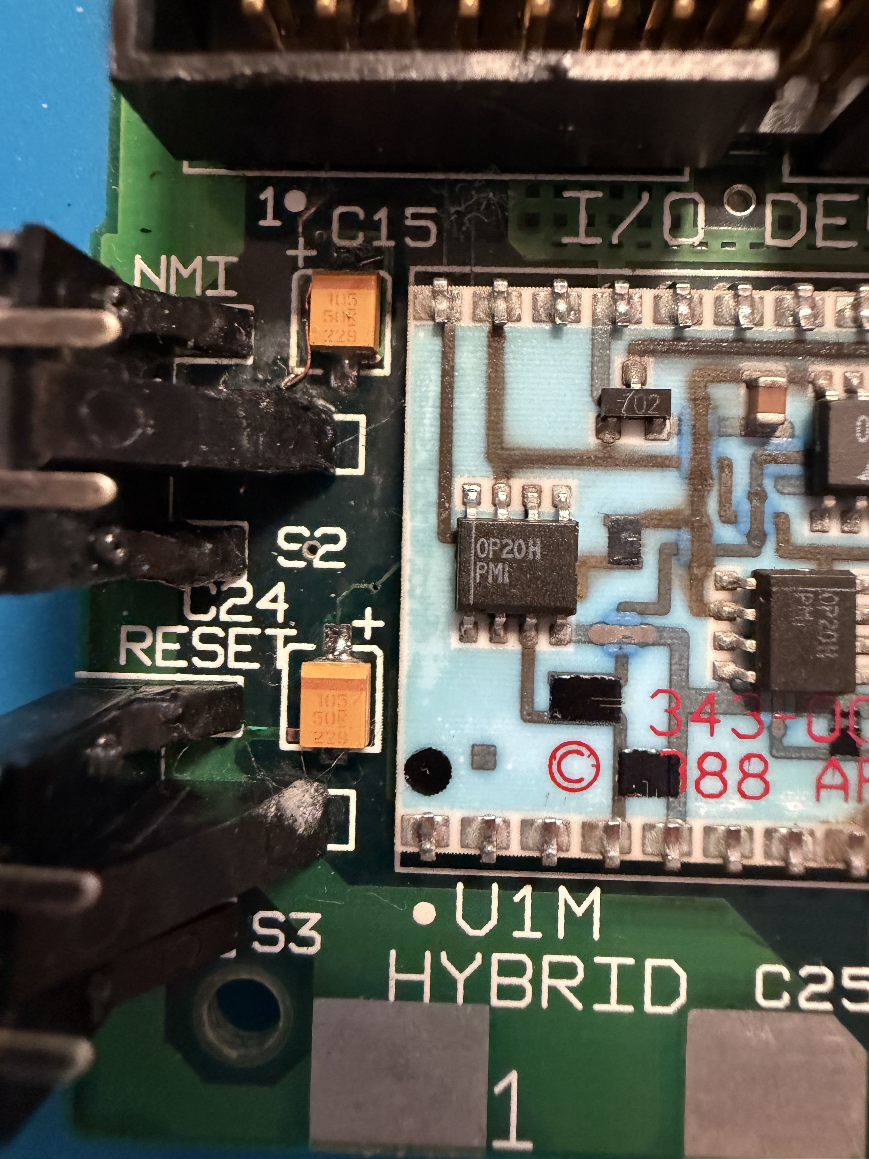

I did find a broken trace at C15 -- I have 0300 172C / 0000 1FFA before I fixed that trace.

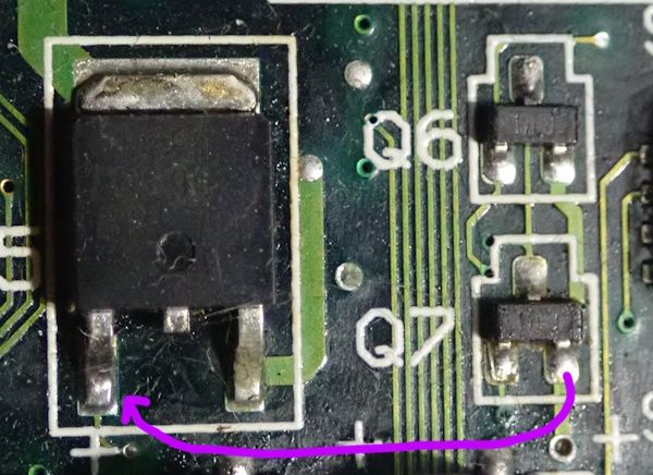

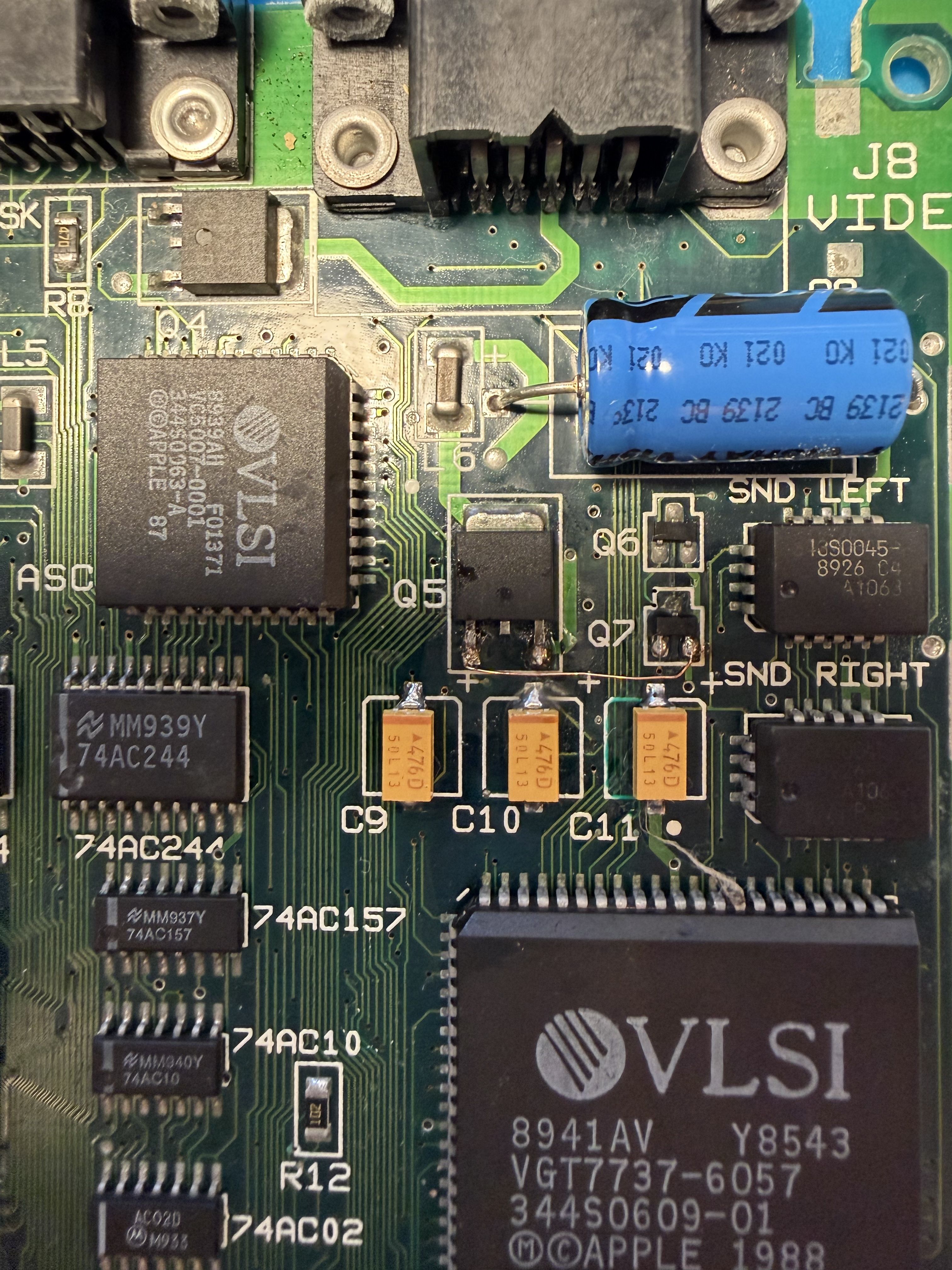

If this is a 5120, it is a common issue that powering up sound (for the chime) introduces electrical noise into the 5V line and scrambles the CPU, resulting in sad mac.
Connect a bodge wire to the sound power signal as shown below. If your Mac boots reliably, you can just leave this workaround in place. A number of us have tried isolating the component that has aged poorly (or become damaged by corrosion) that is causing this issue on so many 5120s. Nothing I've tried replacing has actually fixed it.

I did place a bodge wire without significant improvement; still the sad Mac on load.

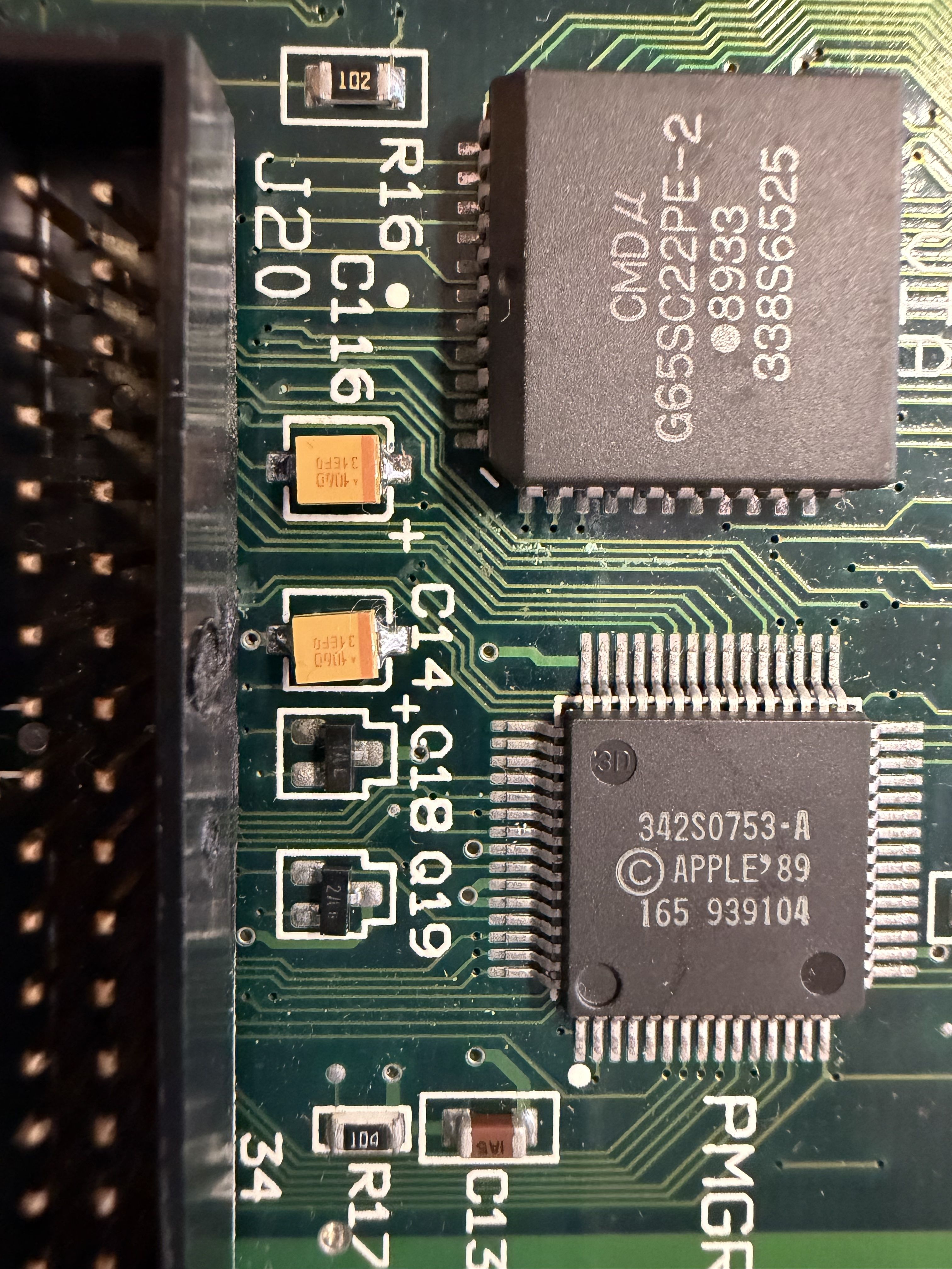

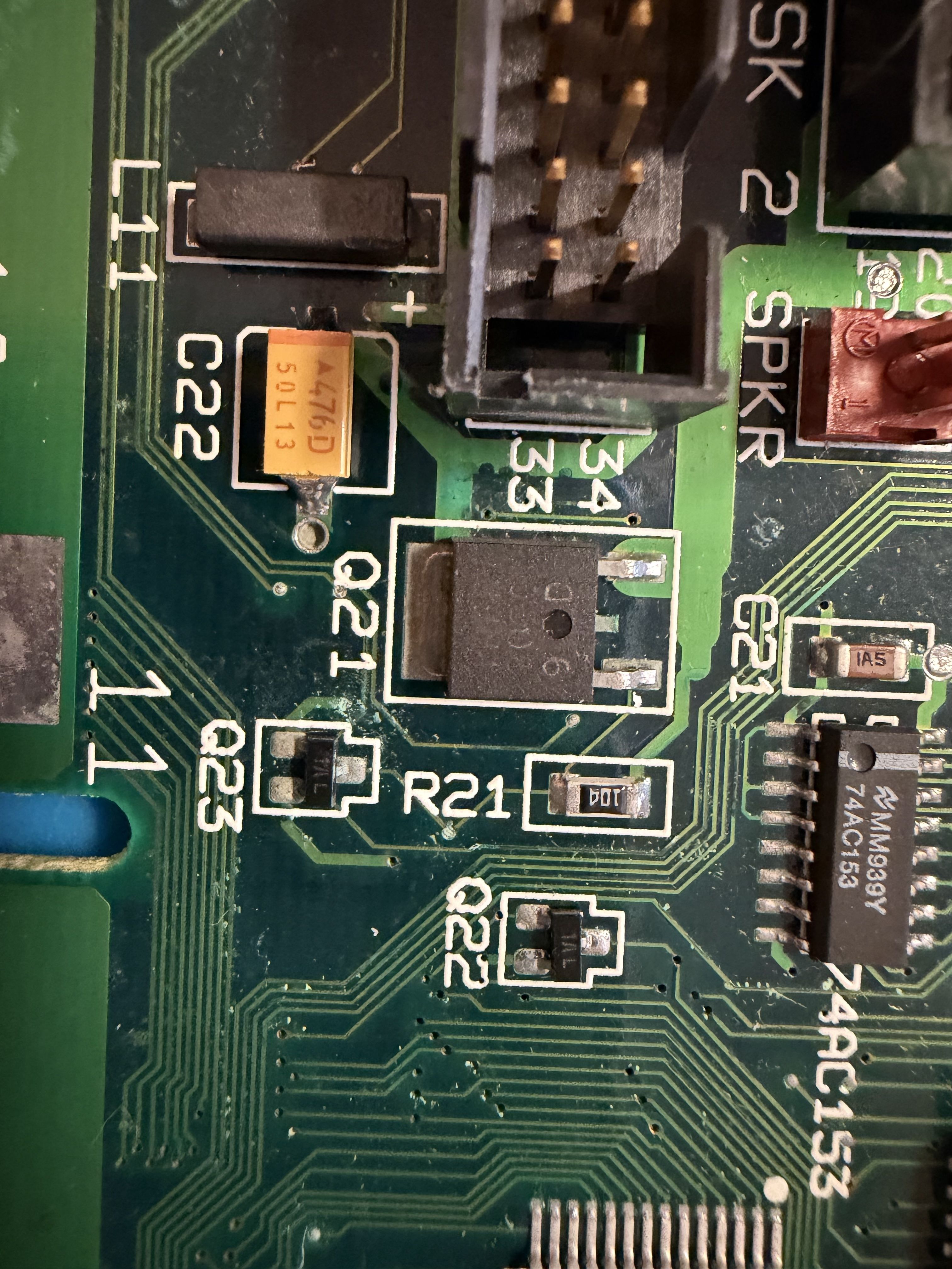

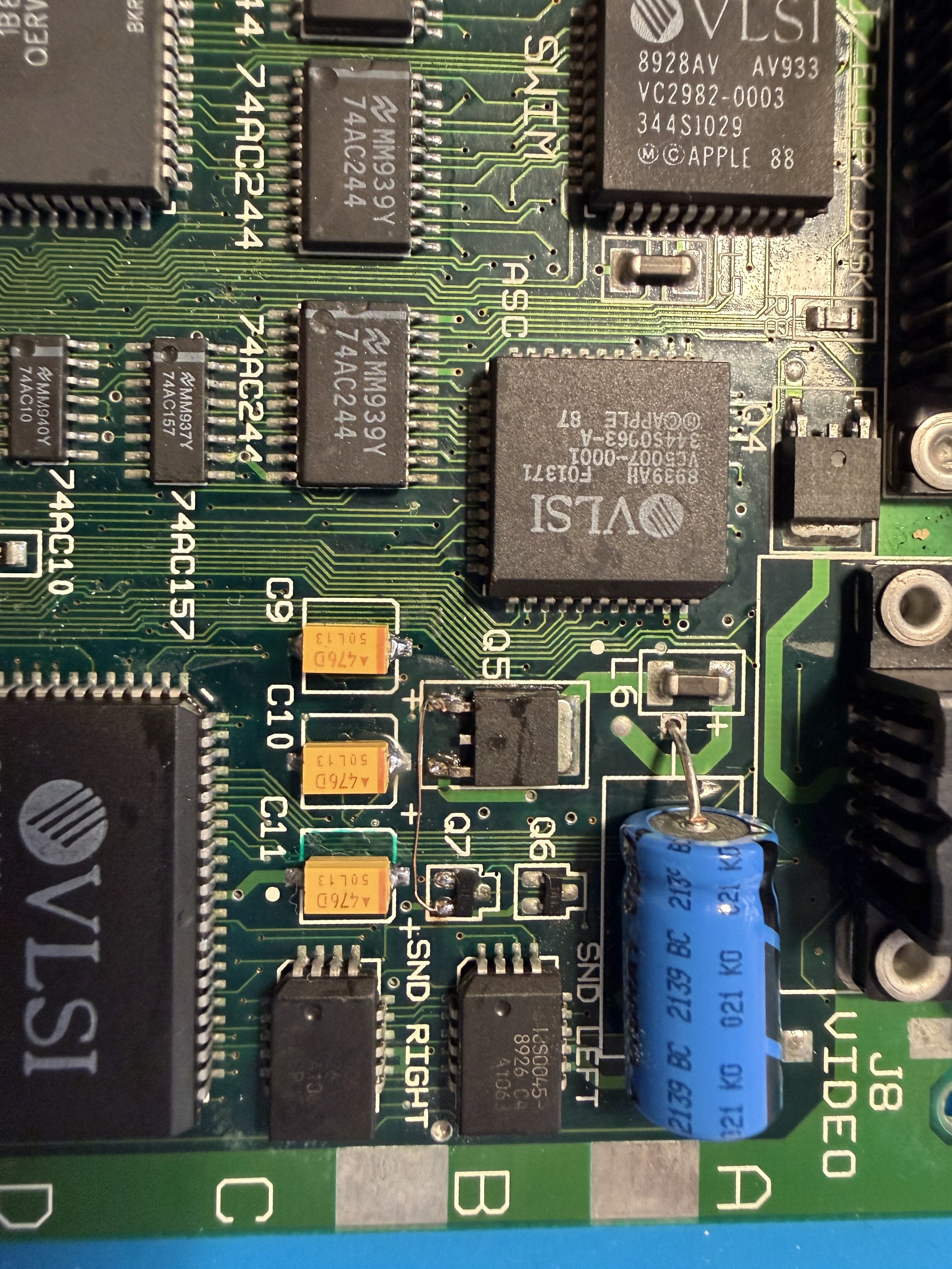

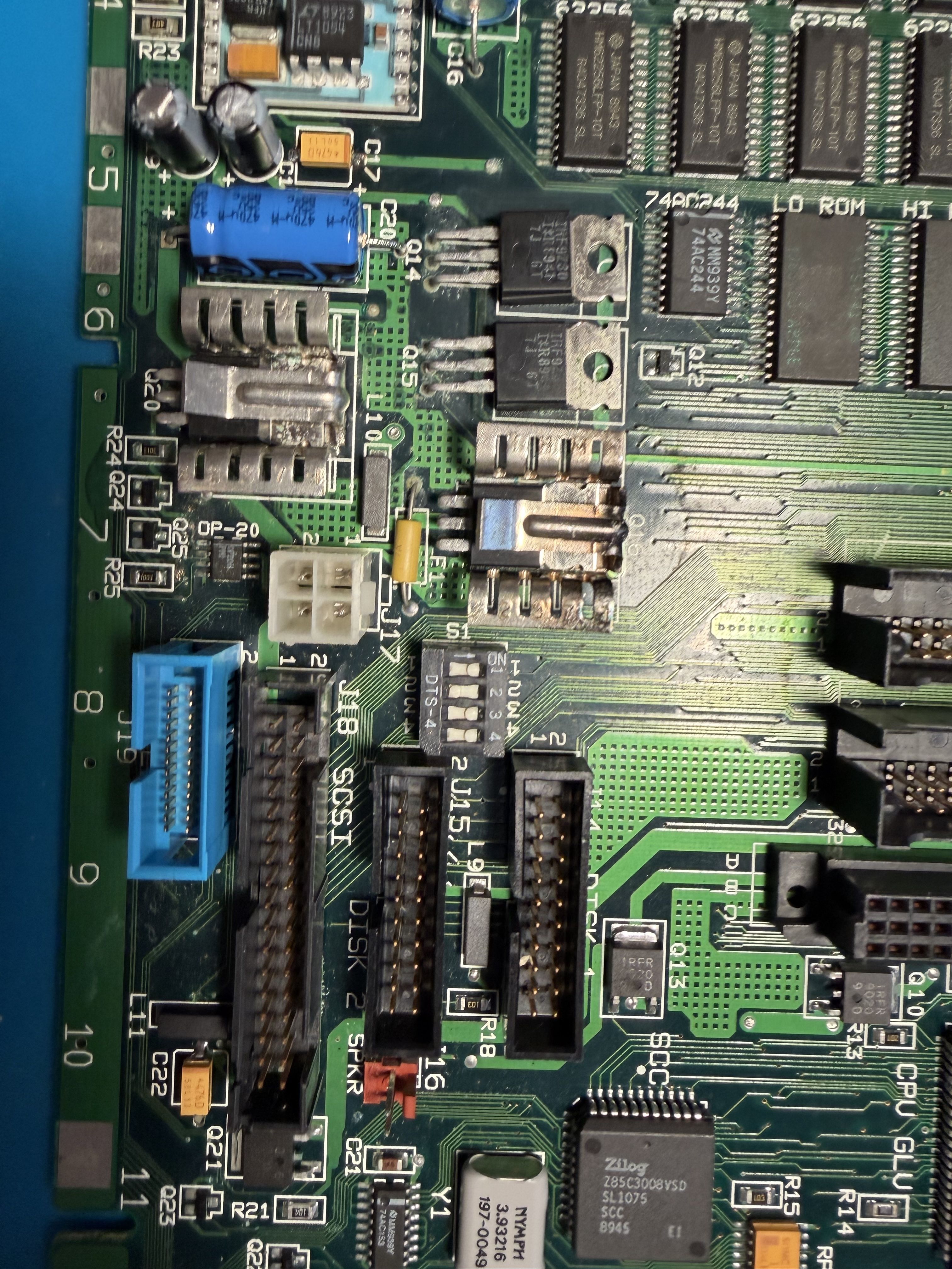

I'm a bit ignorant of the chip layout on the board; in addition for a new person to the board the silk screen indications are less than exact other than the chip number in relation to the schematics. Anyone have an easy reference for the chip placement and names that correspond to the chips on the board and schematics .
The error code points to RAM? or do you think it still could be a faulty hybrid or power given the jittery signal -- still the same post bodge wire...
I've included some picture of my board....
Thanks for any help or direction.

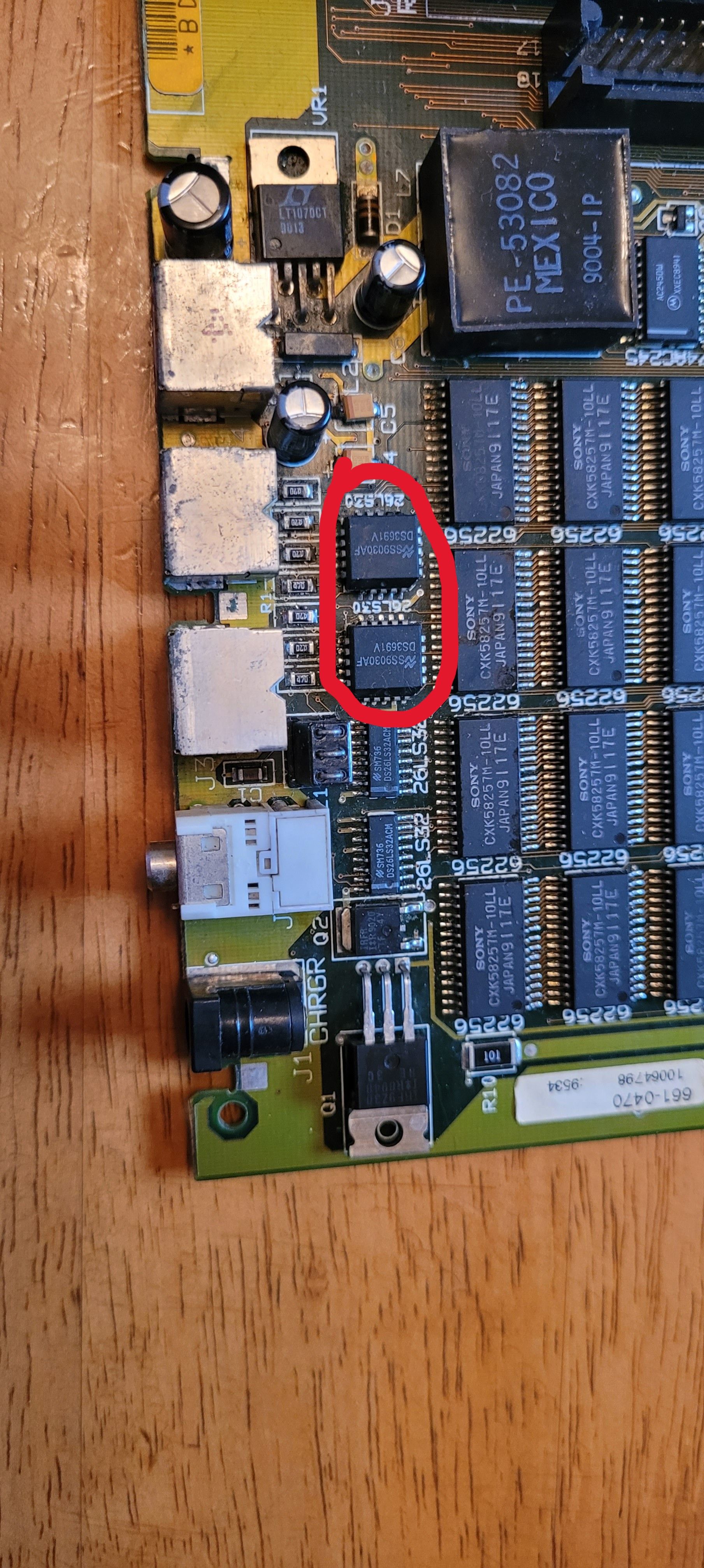

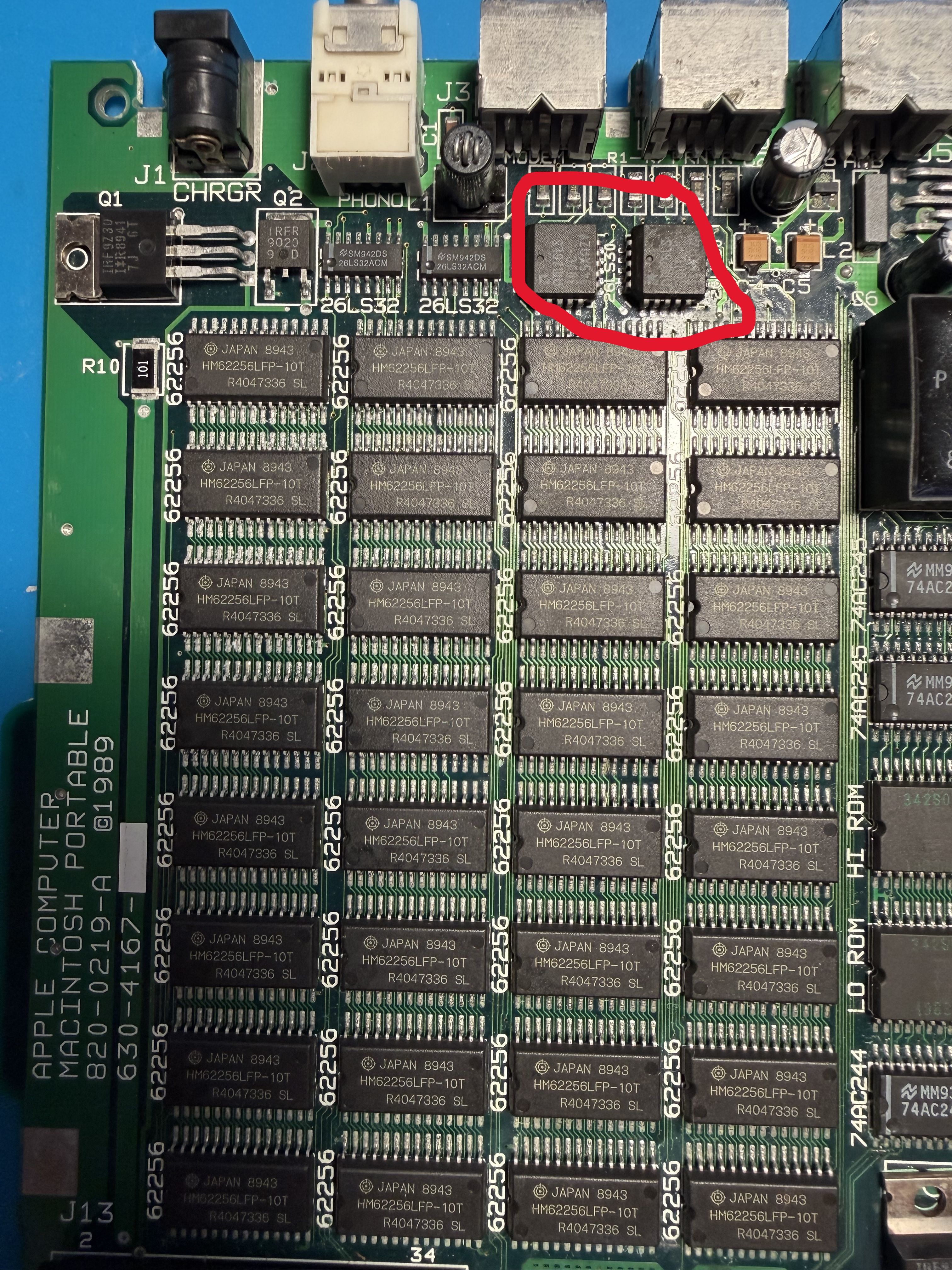

OH, If you find out what was wrong please let me know! I'm trying to find the same problem on mine. I discovered that the DS3691V ic was coming desoldered from the board. I am still waiting for flux and solder wick to show up so that I can fix it. If I find out what was wrong I'll let you know!

@Froggy814 not sure which chip you are referring to as the DS3691V. Do you have the backlit version— I have the 5120 (non backlit).

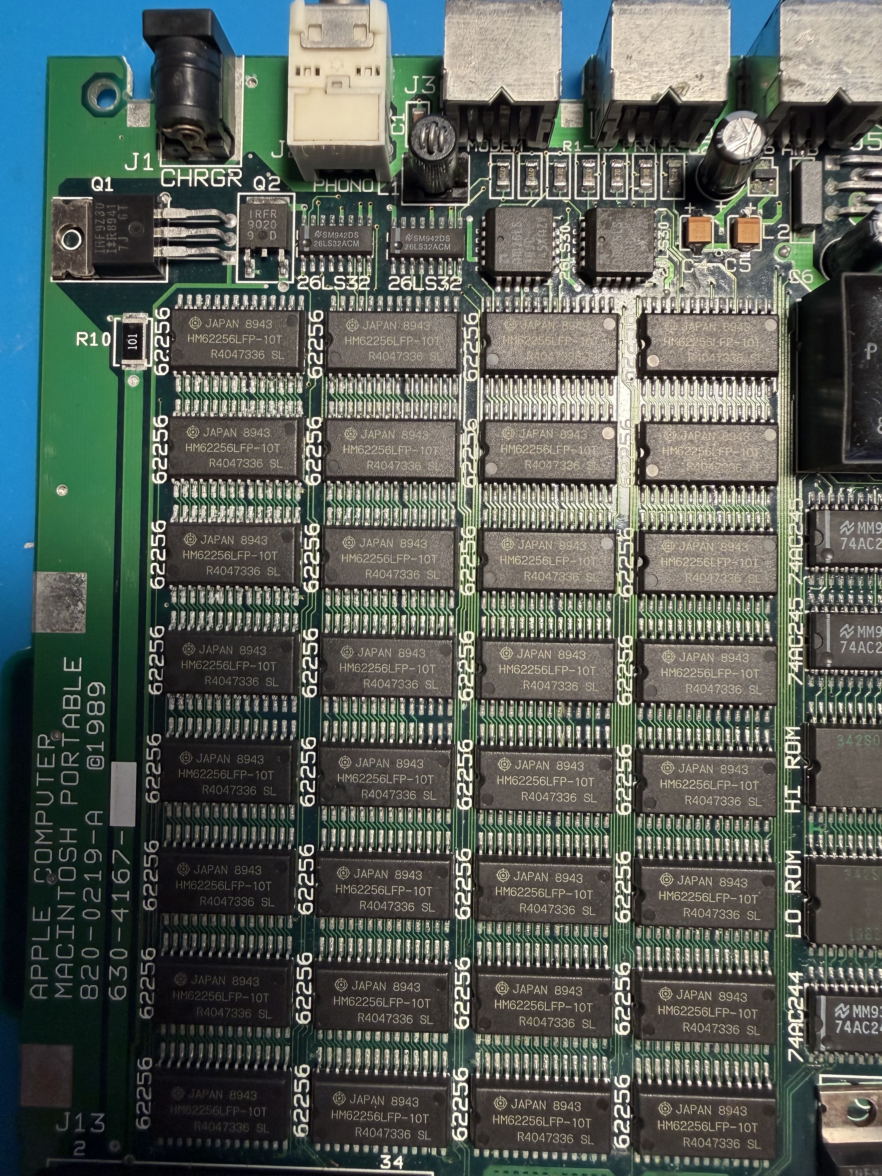

I have the non backlit. Here is the chip circled in the photo you gave. Your's appear to be a different model of IC but they do the same thing. Just like my ram is a different manufacturer, but both are from Japan. Under your photo is a photo of mine.
My portable's

I was able to fix my portable by reflowing the solder on the 2 ic's listed above. How are you trying to get it to boot, and what have you done to your portable?

I had the RAM error: 0000 0003 / 0000 FF00.
Replaced the first lower row of RAM nearest to the Hybrid Module and.... the sweet sound of just the startup chime!! (without the sad Mac).
Things look good, was able to test the RAM module (1 MB) and it is working.

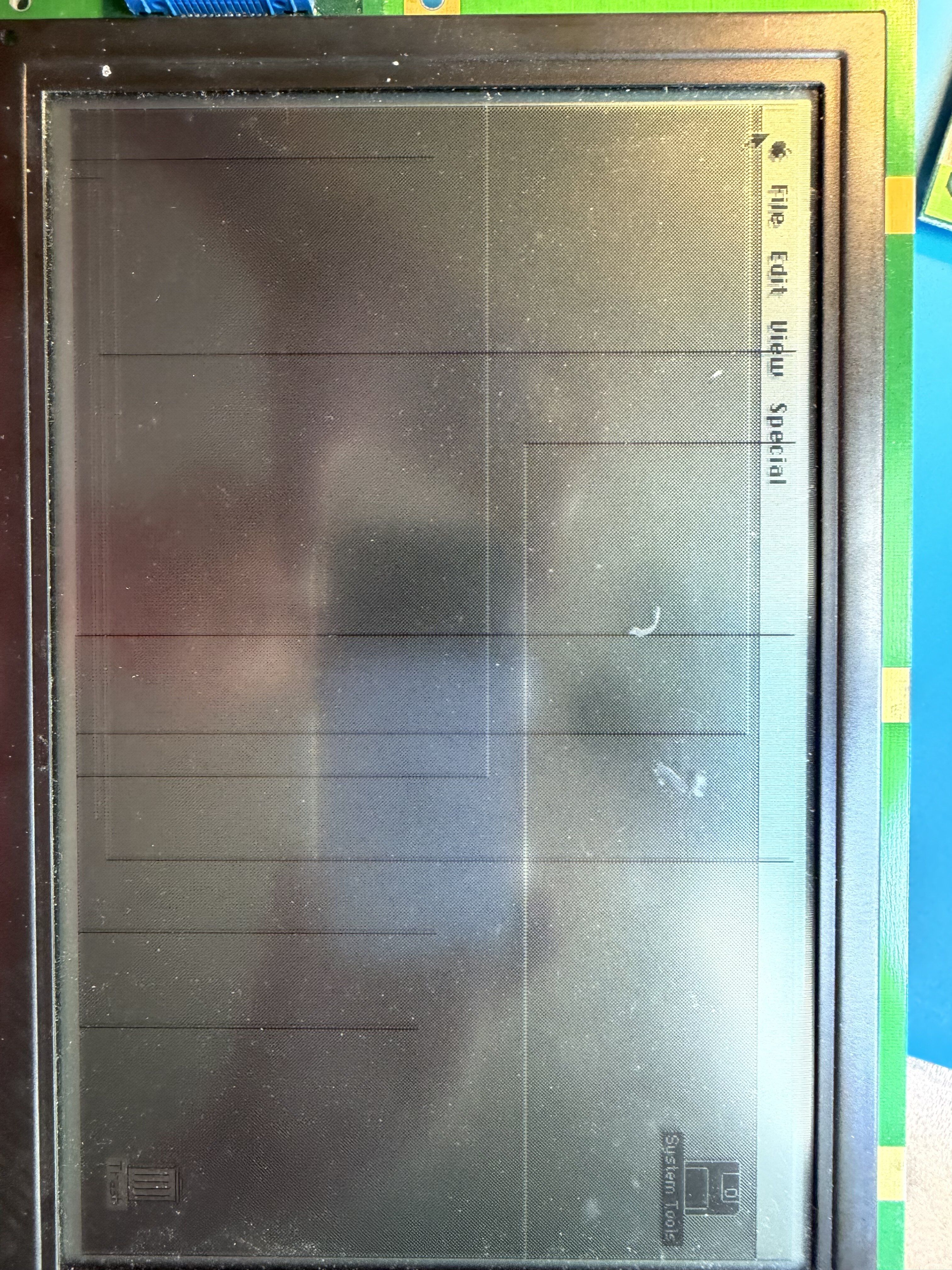

My screen is still a disappointment.... lots of lines.... will work on this but seems it is a difficult task to fix.

My screen slowly turns dark to the point it is unusable..... I am using an external monitor but not great.... is this the Tunnel Vision? or another problem?
Tunnelvision. Shes cooked. This is becoming increasingly common.
Gonna need to do a screen mod. SuperSVGA published his Pico to HDMI Adapter open-source, and i think its basically the same as what Androda did while his was VGA.
