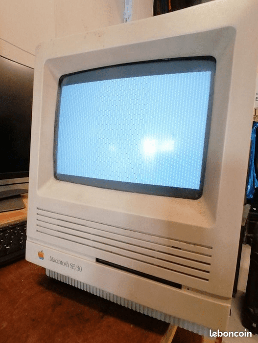

Hi
This is my first post here.
I've just get a Macintosh SE/30 with a CRT problem, hoping it can be fixed.
Is there a dedicated resource, blog, Youtube, that could help fix such a problem ?
This is the problem (image).
Best regards
Patrick

Hello,
Your CRT seems fine, this seems to be a problem known as "Simasimac" (Google for it). Sometimes is related to the RAM, so my first try would be to remove all the SIMMs and test it with known working RAM. If not, just install what you have again, maybe trying to fill only one bank of memory.
But it can also (quite likely) mean that your logic board needs recapping.

@pat665 -I second the recapping. In my experience, that-unfortunately- is usually the problem, or part of it anyways. But recapping the board will give you some great experience with a soldering iron!

Also have a look at your ROM SIMM. sometimes it needs to be reseated or pressured to make contact properly. 100% SE/30s need to be recapped but sometimes no ROM can show this.
