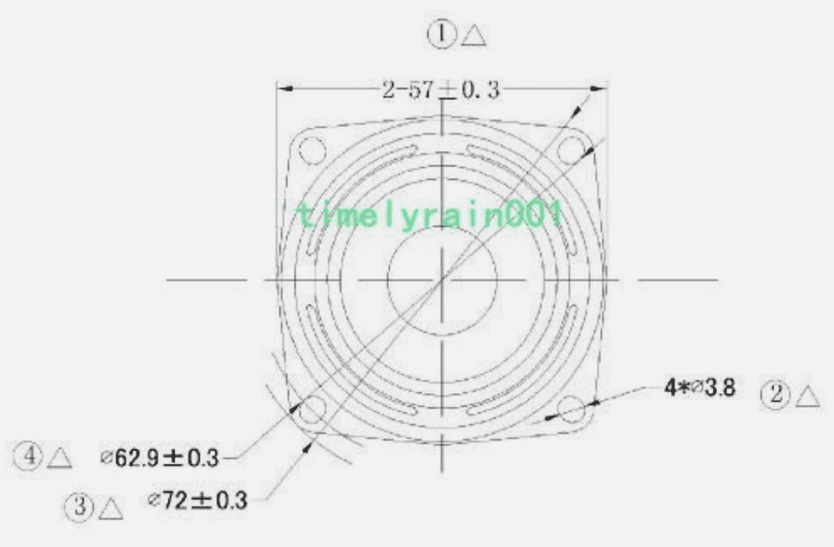

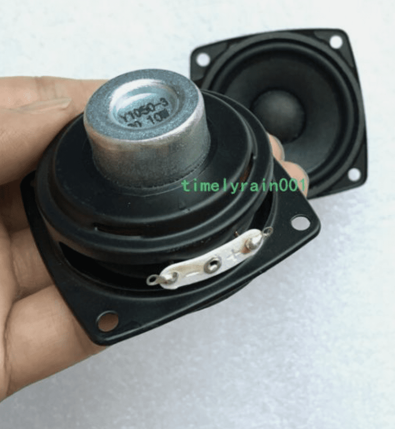

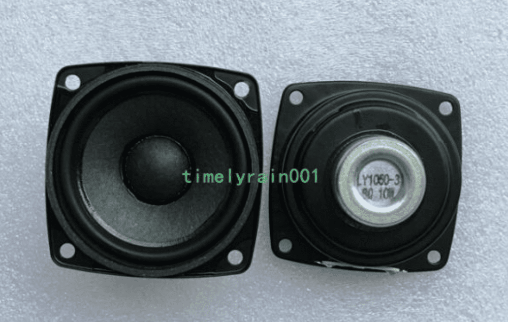

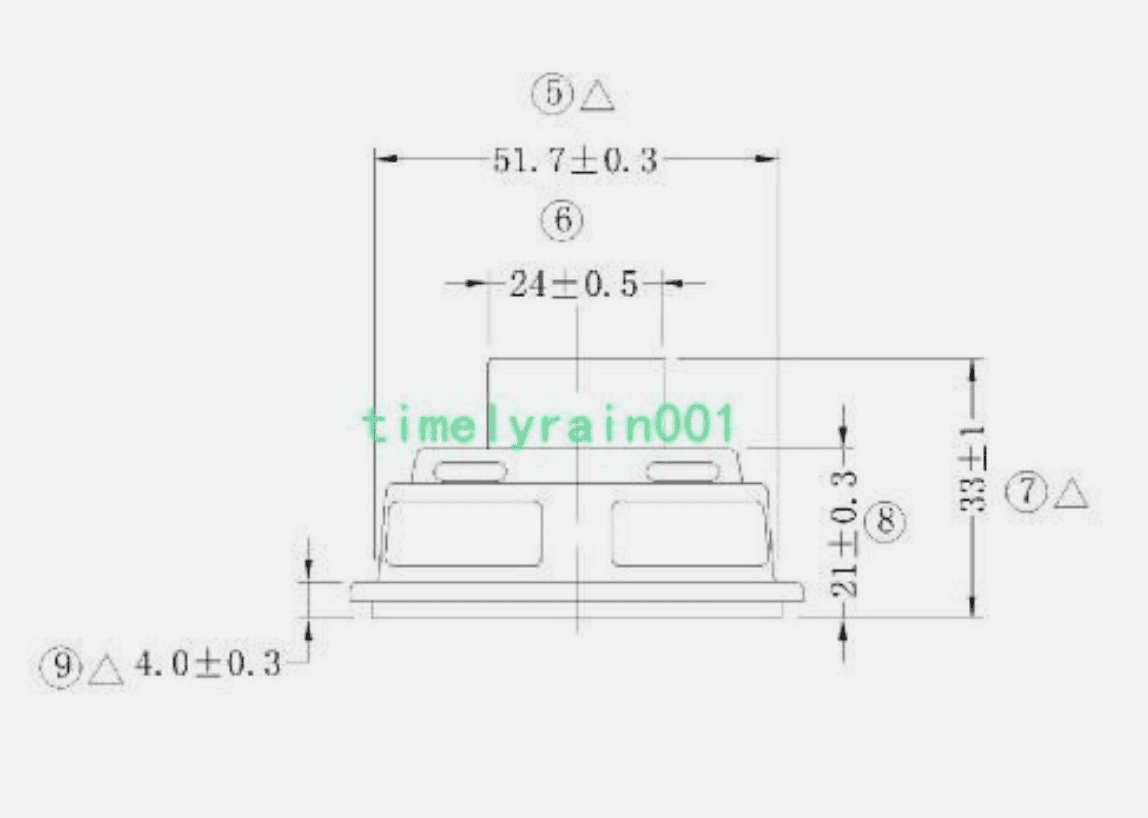

I found these ones and per measurements, it should actually fit. Can anyone confirm?
57MM 8Ohm 8Ω 10W Full-range speaker Loudspeaker Neodymium Rubber edge
Per attached measurements, this should be an exact drop in replacement. it sticks out a bit more, but I verified there is no obstructions in the case, so the speaker mounting location can accommodate a deeper speaker like this. The Watt rating is a bit higher on this one, so it should sound better/louder, too.

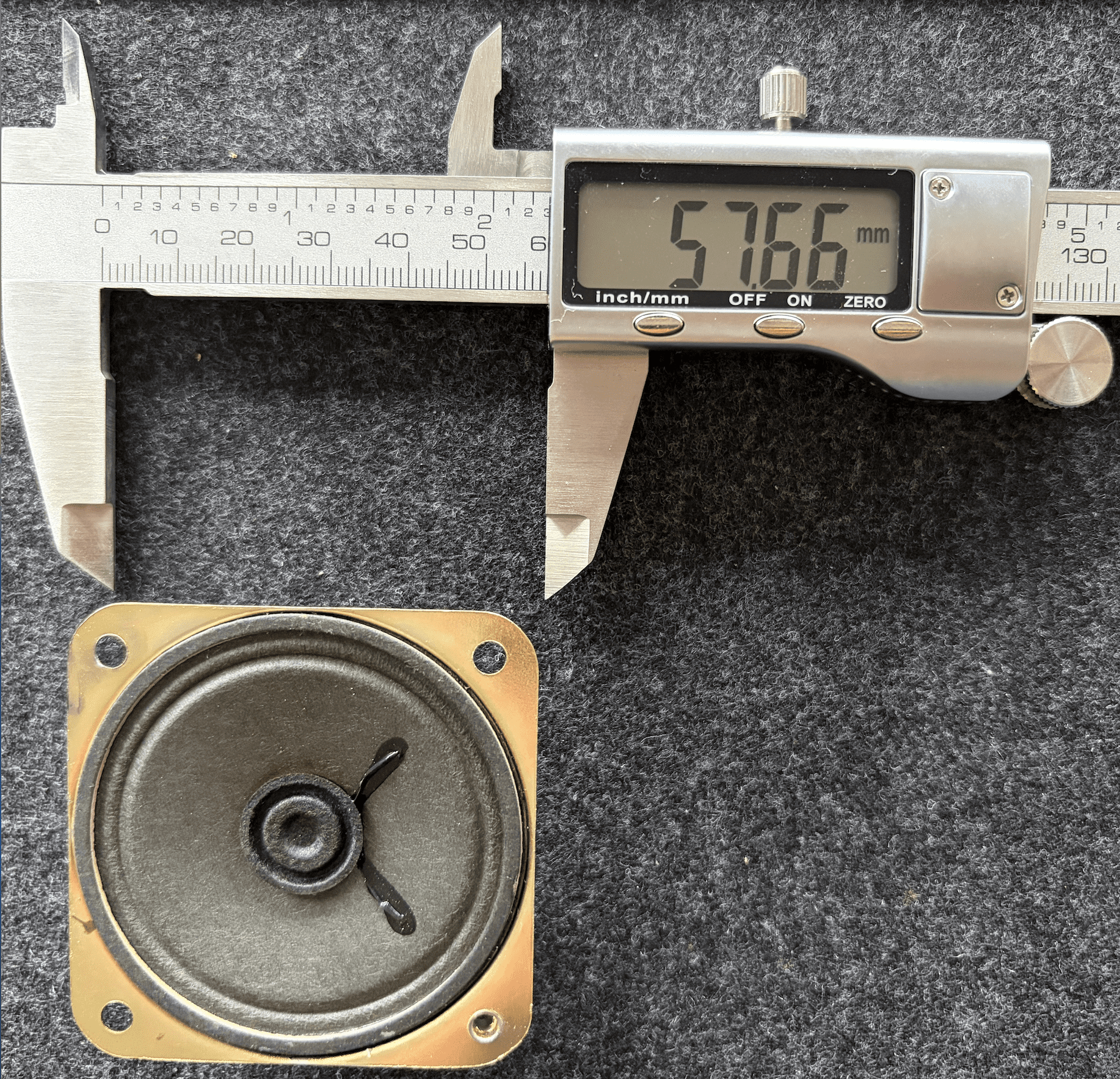

For reference, this is the original speaker I took out from the Macintosh.

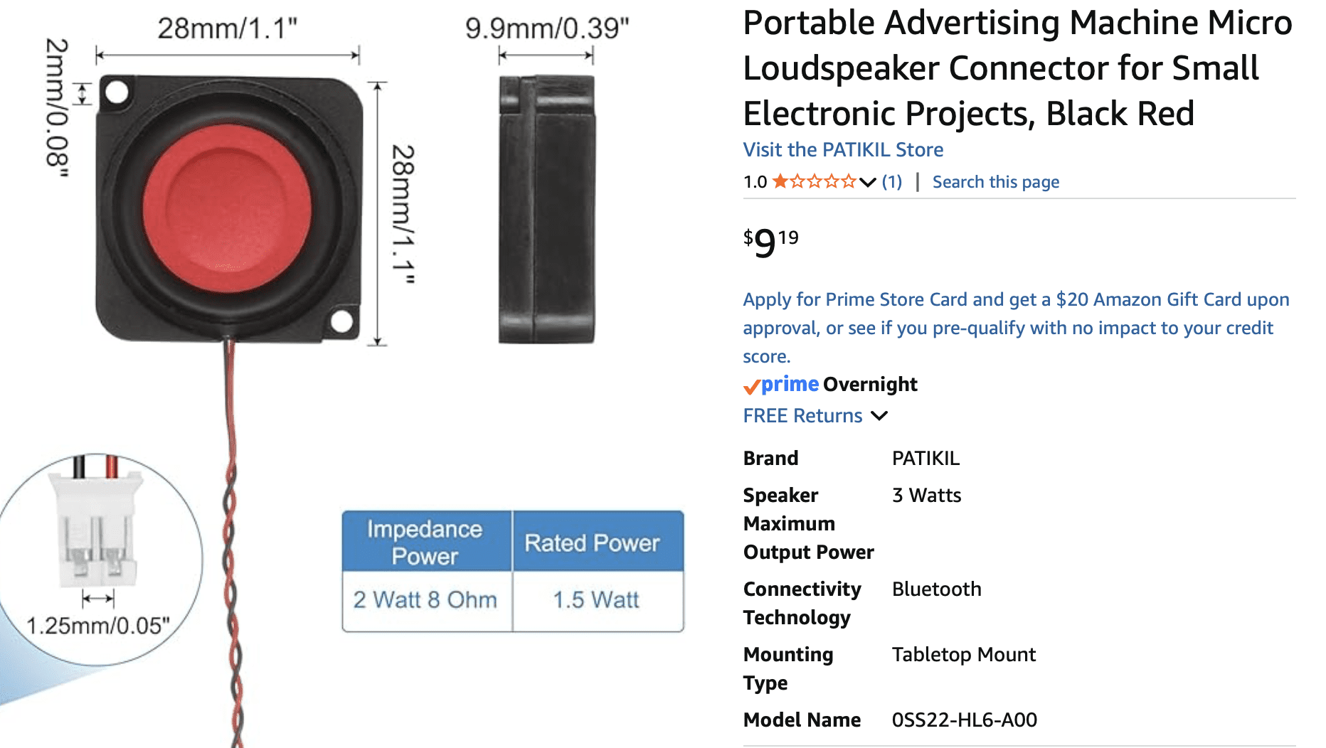

I've also found these. They are not exactly a match in terms of dimensions, but would be able to be secured with 1 screw at least.
A Mini Speaker 8Ohm/2W.

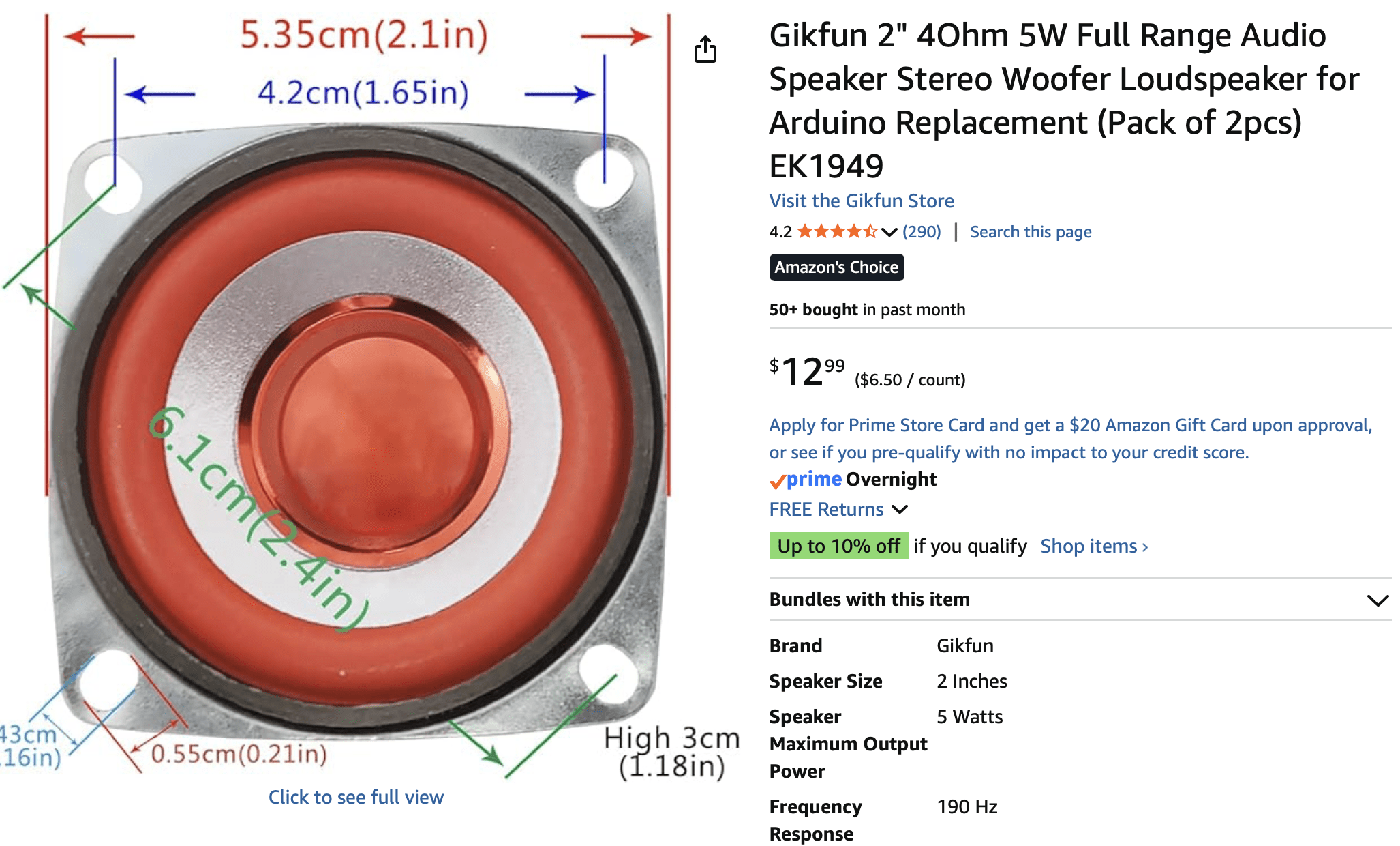

A larger version, almost the size of the original speaker. I might need spacers, but mounting it would be tougher.
Is it safe to drill holes into the analog board to make it match? I'm trying to avoid anything to potentially damage the board, since it is 40 years old.
