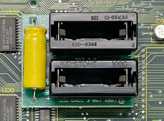

For those boards you may encounter that do not have the battery riser boards, I've found these holders to be an excellent choice: https://www.digikey.com/en/products/detail/6S-1-2AA/6S-1-2AA-ND/2077833
With some sandpaper you can take 1mm off of each holder and they will fit perfectly side by side, and have more than enough meat left over to be strong. One of the pins will fit straight through the hole and the other pin will have to be bent out at a 90 degree angle, then the tip bent to fit into the hole. The end result is a strong, good looking replacement (I think). I'm sure there are other options but figured I'd share this one.

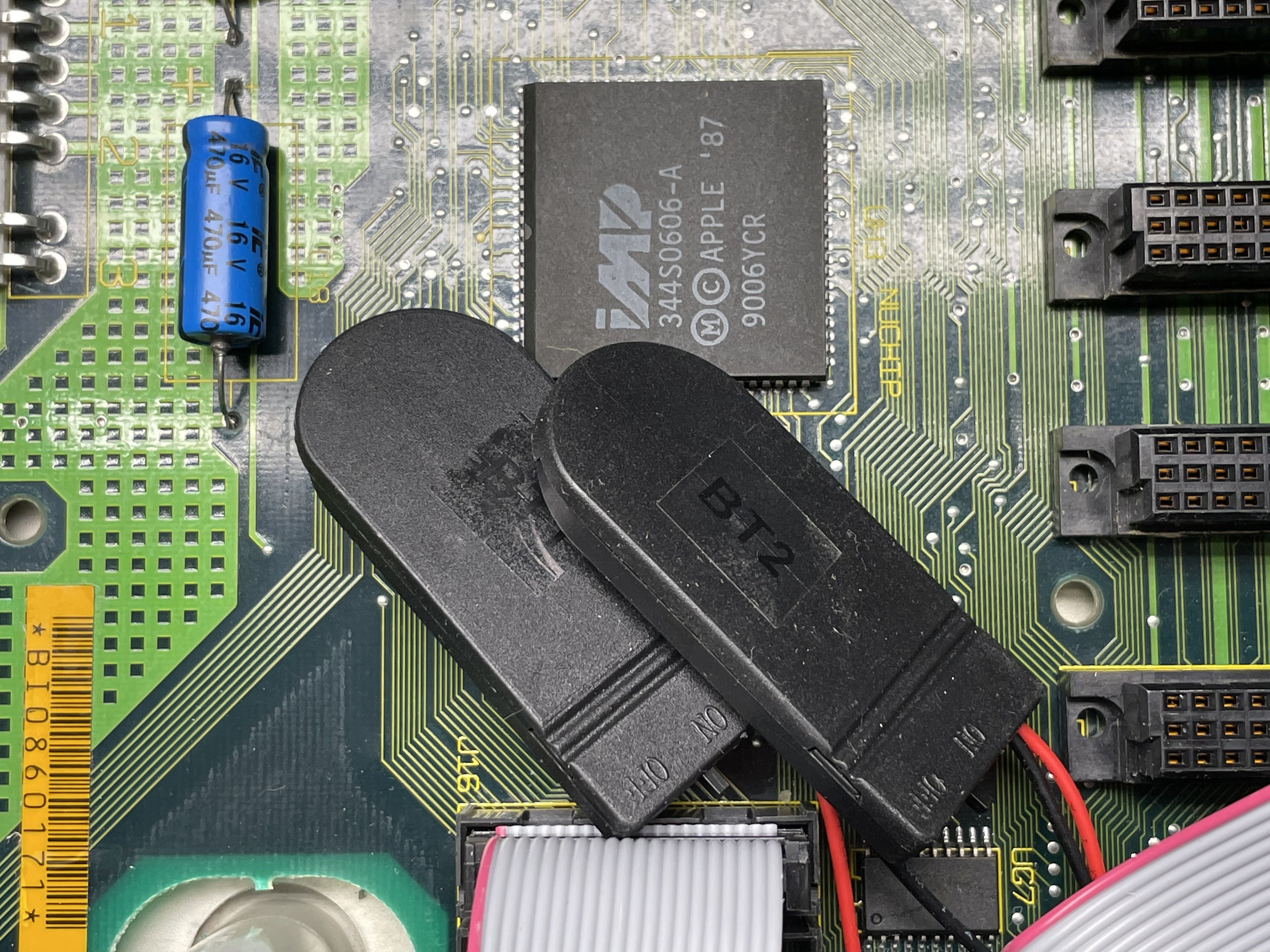

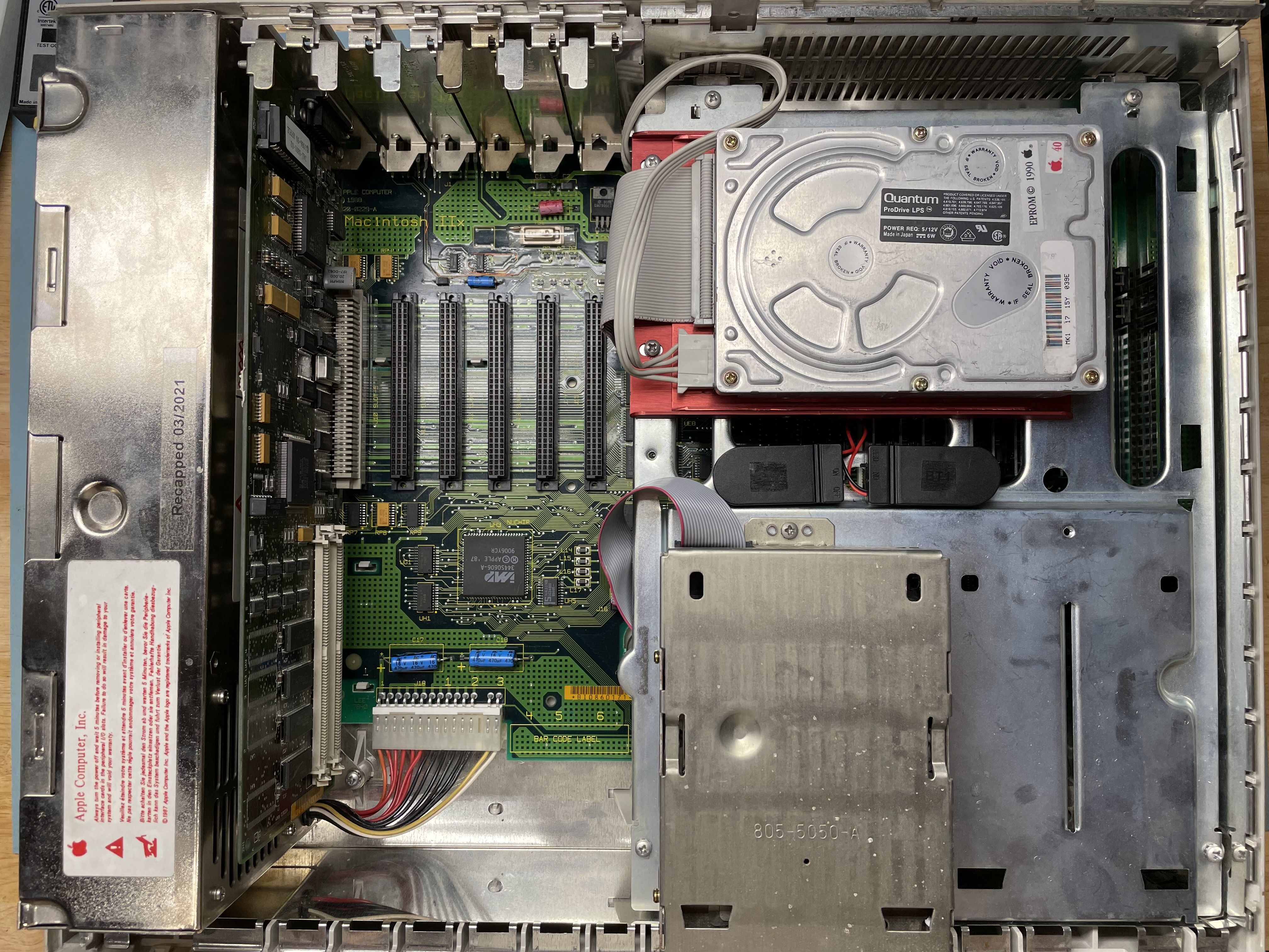

I prefer this other holder type for several reasons. The batteries are in an awkward spot under the drive carrier. It's easy to forget about them or to consider it not worth the effort to take them out when you store your Mac II or aren't sure if you'll use it for a long time. These carriers let you use CR2032s much less likely to leak, positions them above the carrier and they have off switches so you can save battery life when the Mac is in storage.
I paid $6 for 12 holders, installed them in eight different II's and Iix's without any issues. Give them a try next time!

Where were you 2 weeks ago when I ordered the battery holders!! :p
Definitely a nice alternative

I use these same holders on all my Macs, they work very well! I've been using them on Macs that (normally) require the 4.5V battery as well and so far the 3V from the CR2032 batteries have worked well enough.
