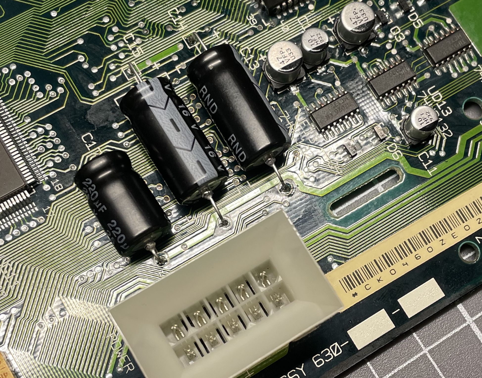

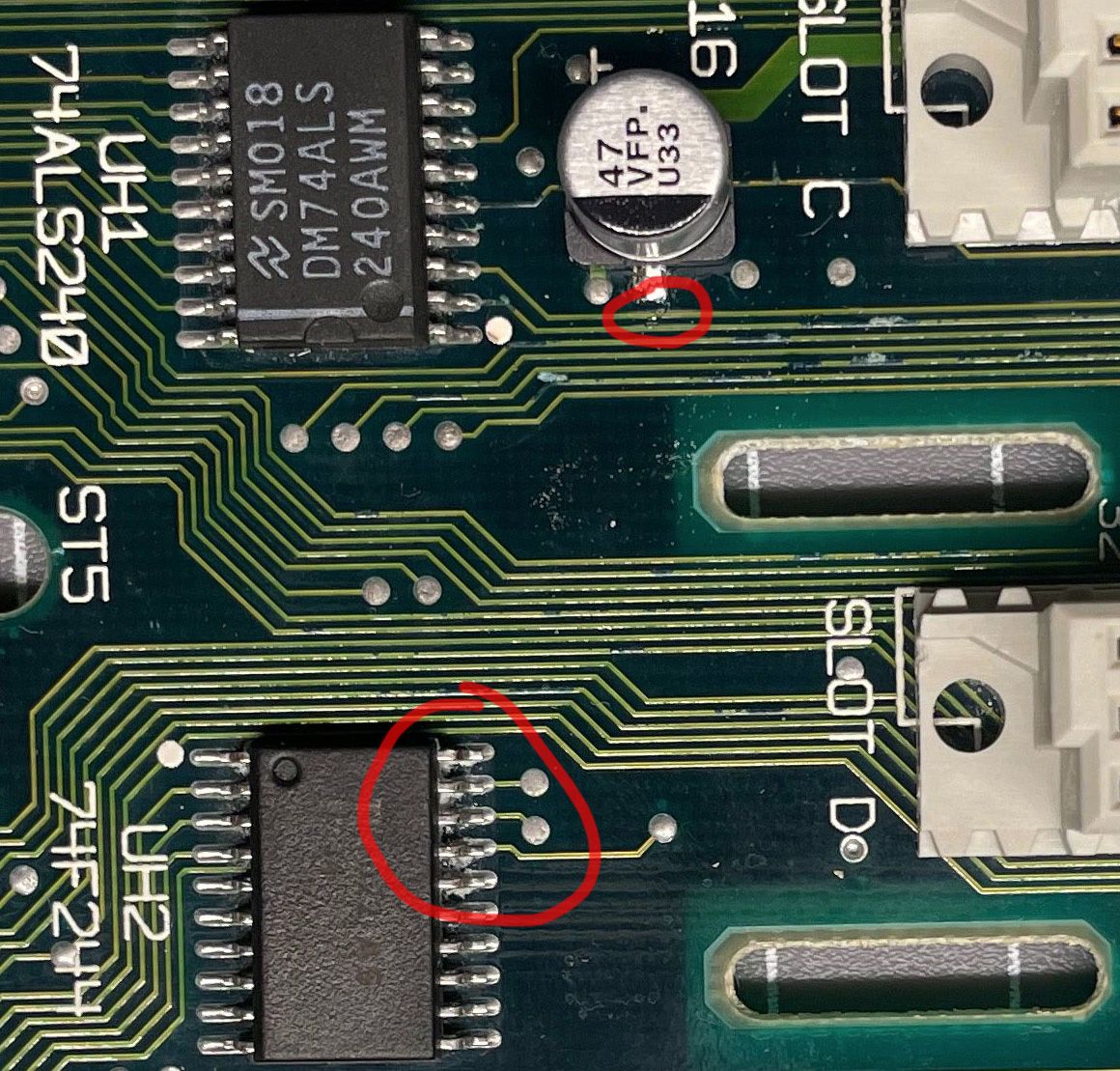

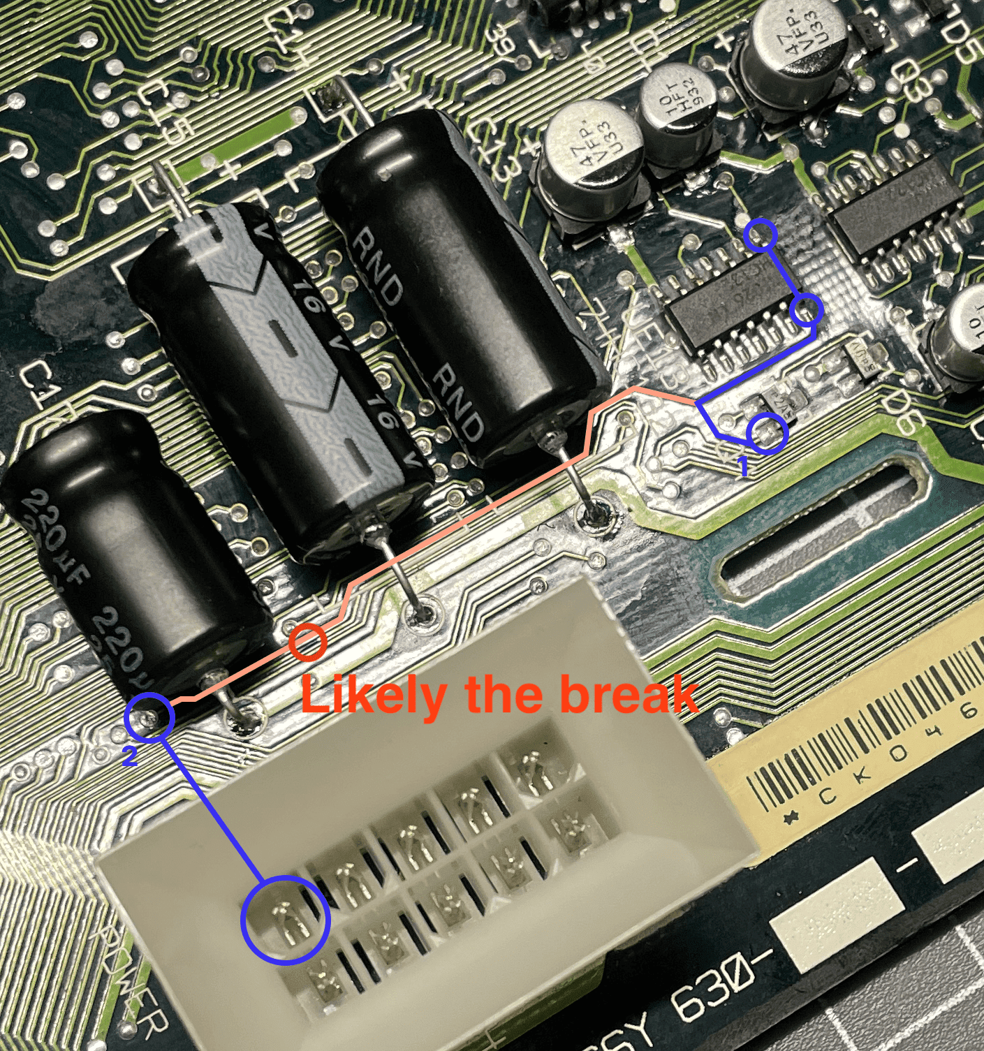

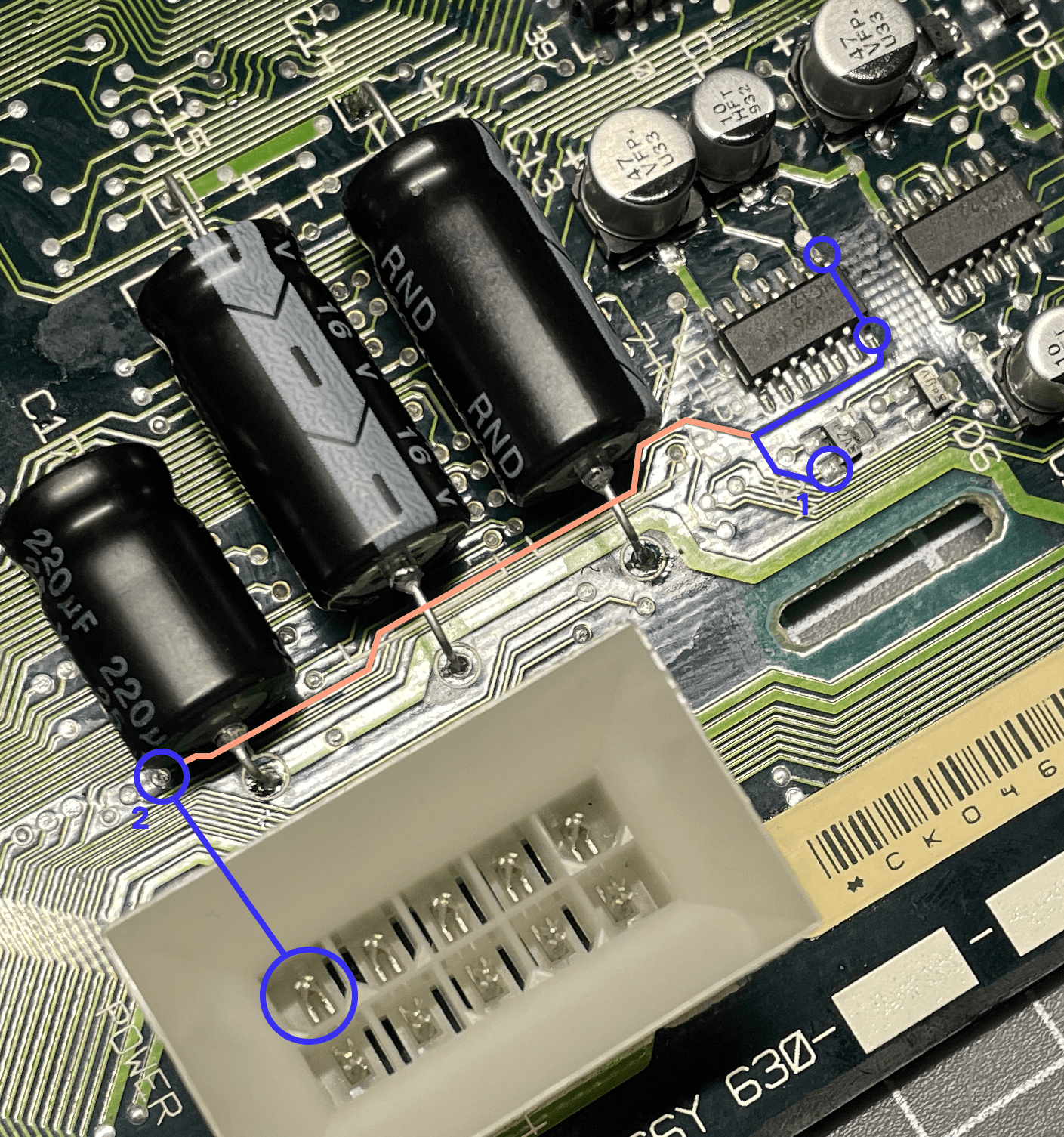

Macintosh IIci - no life even after recap
Hugotronics
Apr 11, 2025
France

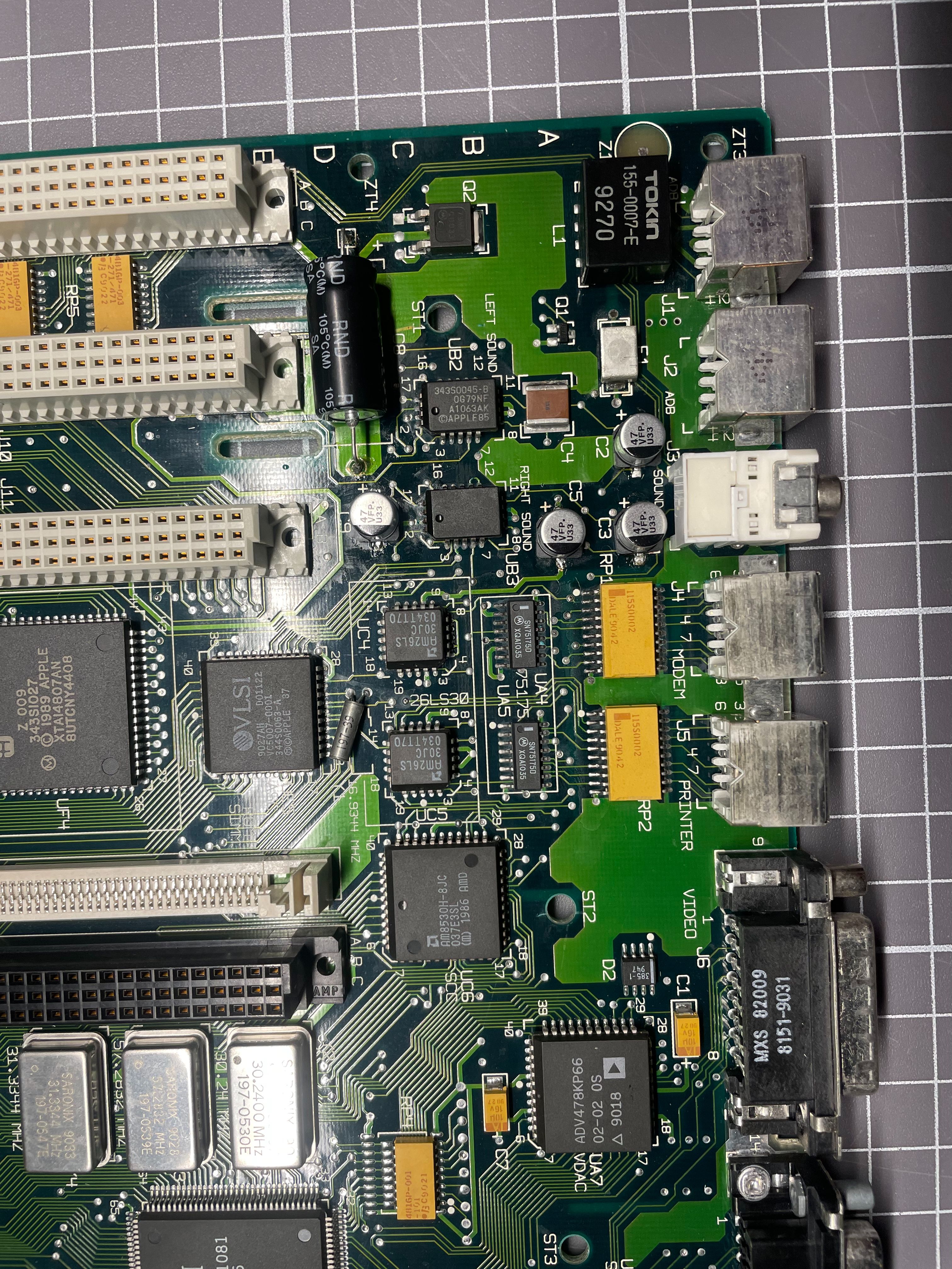

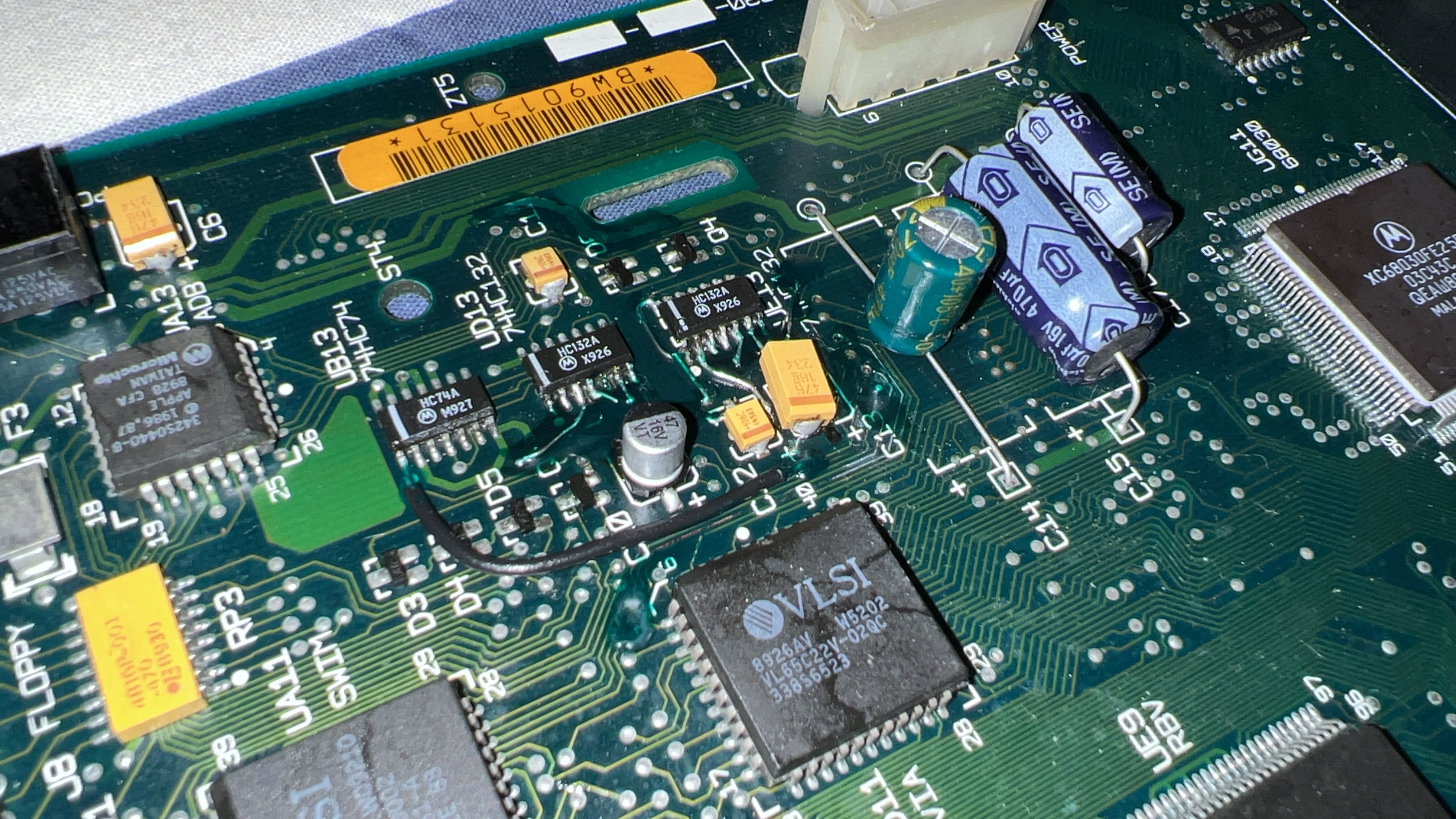

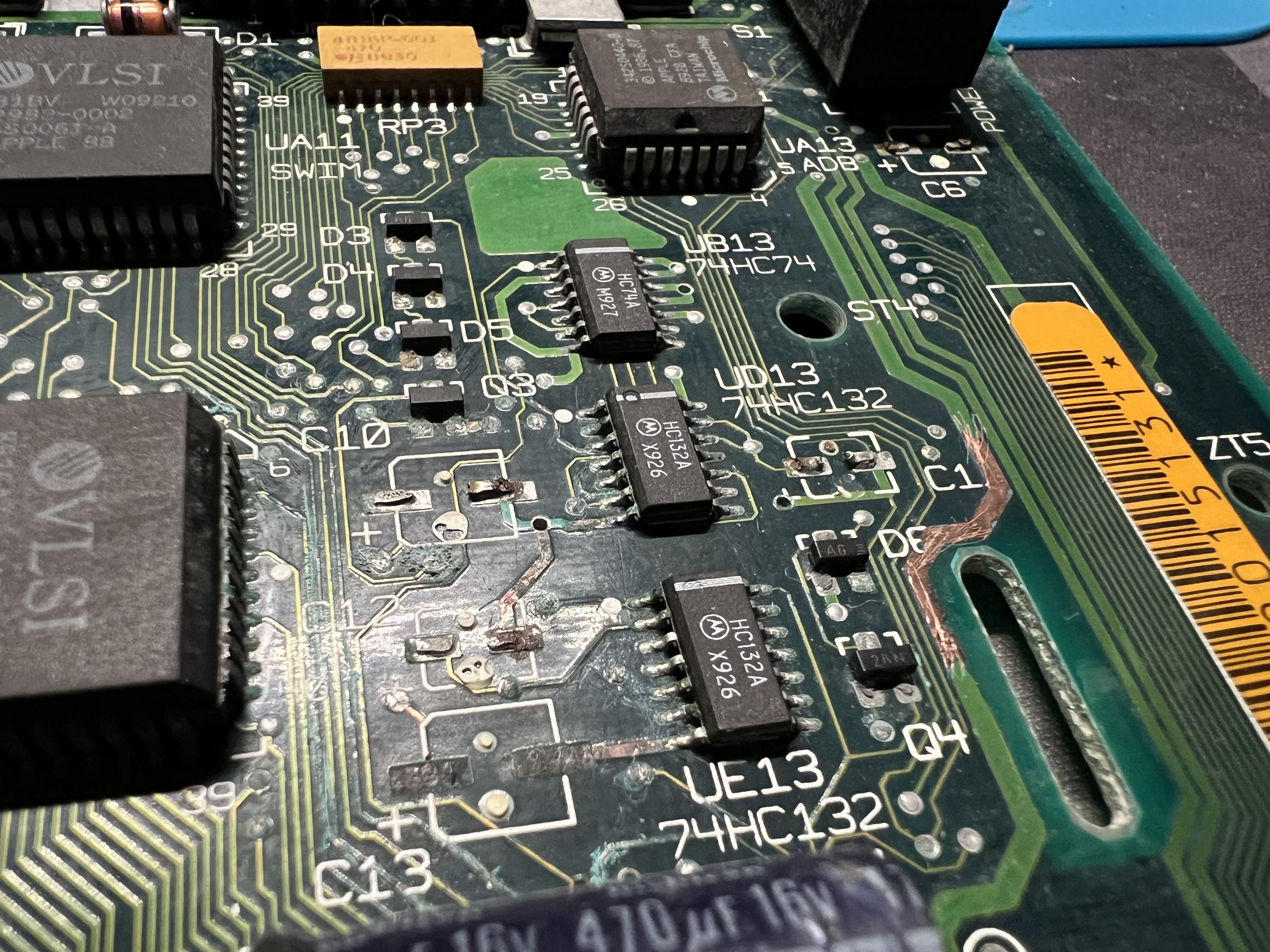

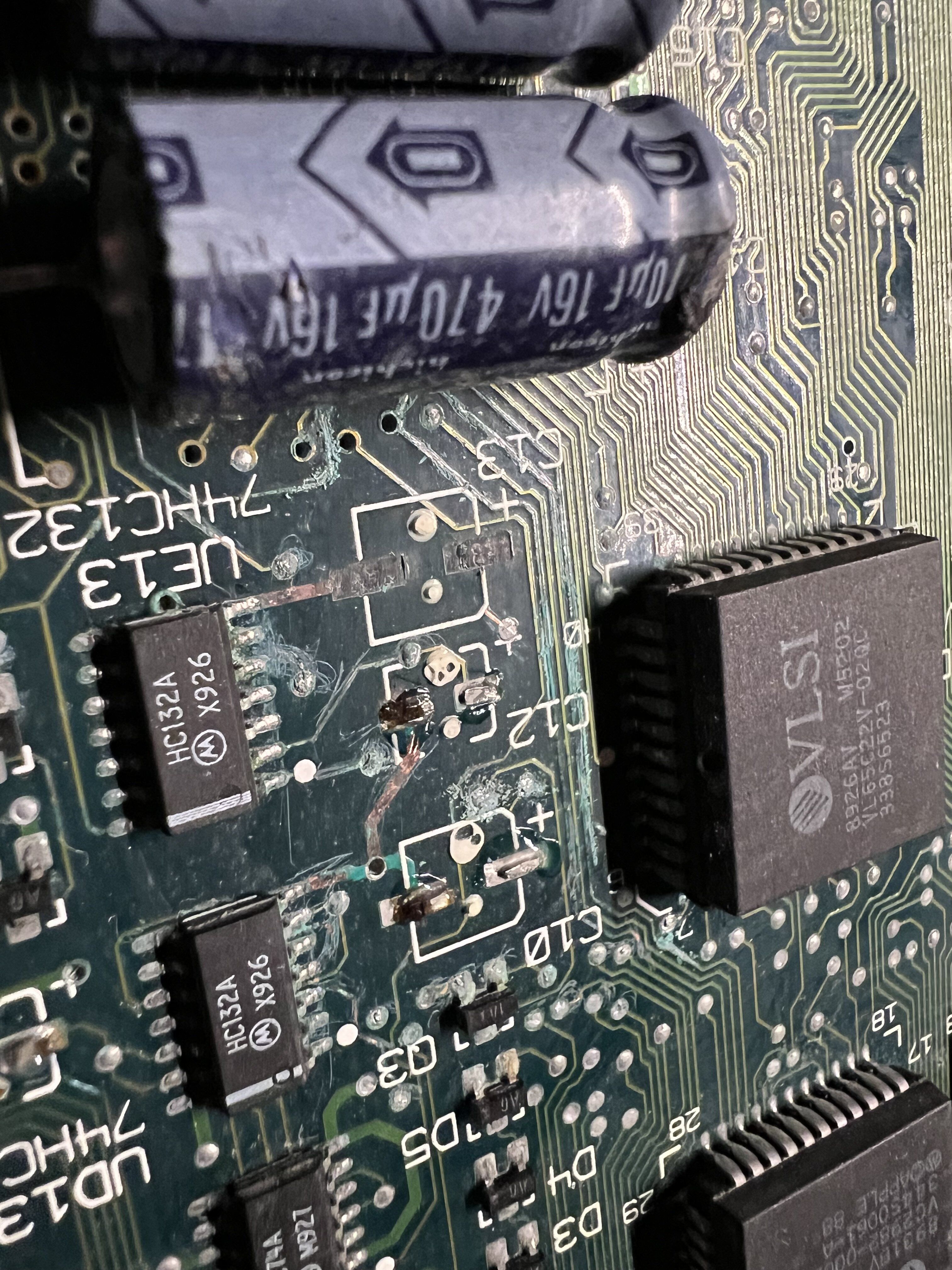

I would personally buy a hot air station — they're pretty cheap nowadays, around $40 on Amazon. Then desolder the entire chip, clean underneath, and check for any open traces. Bodge wires are fortunately your only option to repair a broken trace, but you can route them on the underside of the board, if possible of course.
Hugotronics
Apr 11, 2025
France
You’re pretty close to getting the machine working — I’ve already dealt with worse cap damage here.
