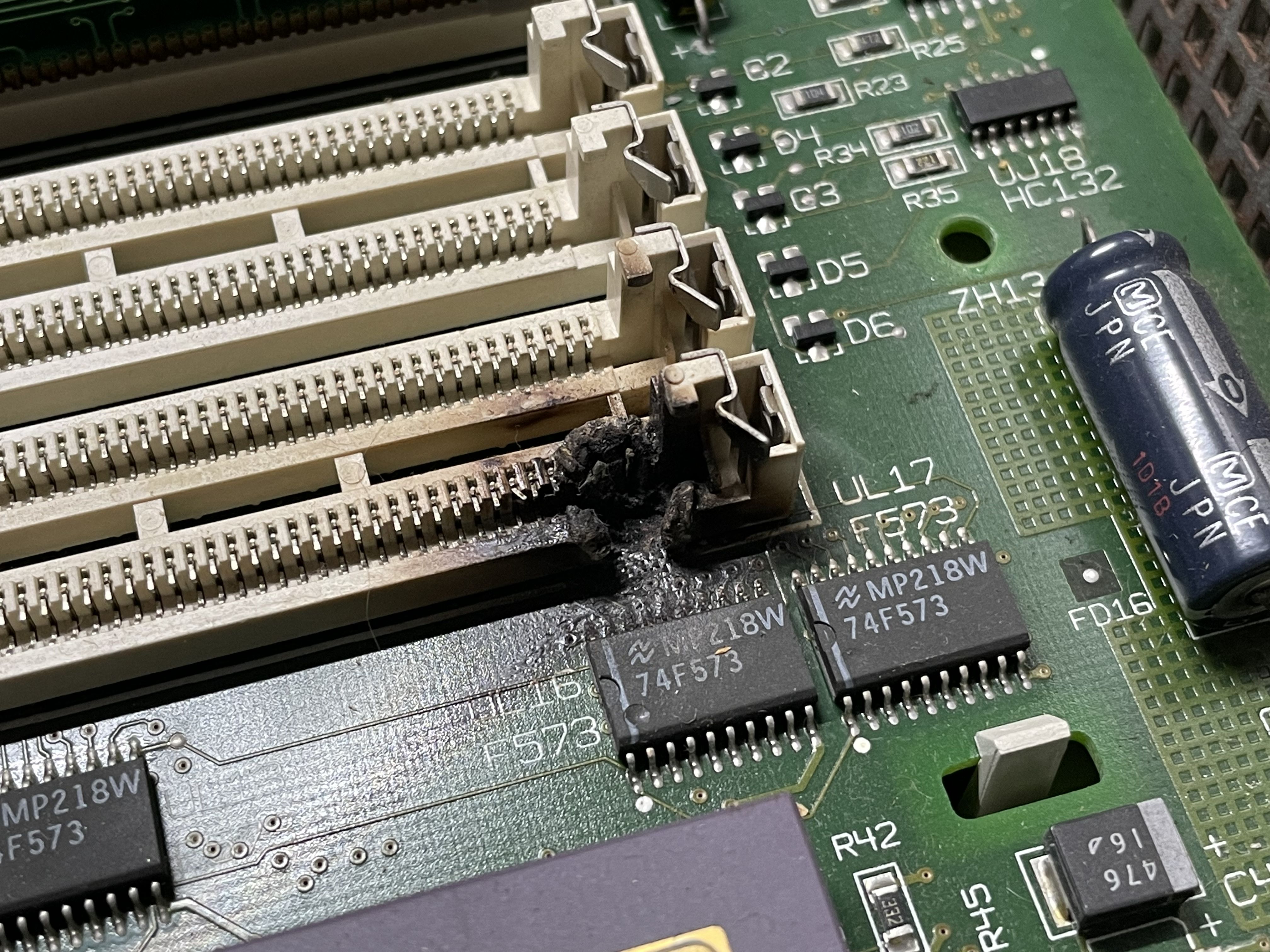

Currently in the process of fixing this and very curious, what could cause this in a RAM socket?
Whatever happened blew a hole straight through the board. Leaving one heck of a burn on the case even.

The 64 pin SIMM socket was also used by Apple for ROM modules and, I think, by Amiga for another type of incompatible memory.
Guessing, someone installed something other than a IIfx SIMM in the socket and caused a dead short from 5V to GND.
Or something close to that.
I have a PM9600 board with a melted DIMM socket and a hole in it, where someone forced 3.3V memory into a 5V slot....

Might as well give a few updates on the repair :)
Removed part of the socket, cleaned some debris from the crater.
Pins 1 and 2 no longer exist, 3 is in rough shape. Some traces 2 layers down got destroyed.

Hell of a whammy for just 5V but wrong SIMM is the most logical explanation, tnx!

A bunch more layers on top and the board is whole once again. The two ground pins will be drilled out once the replacement sockets come in or I may just run a wire from the legs to the ground, we'll see.
