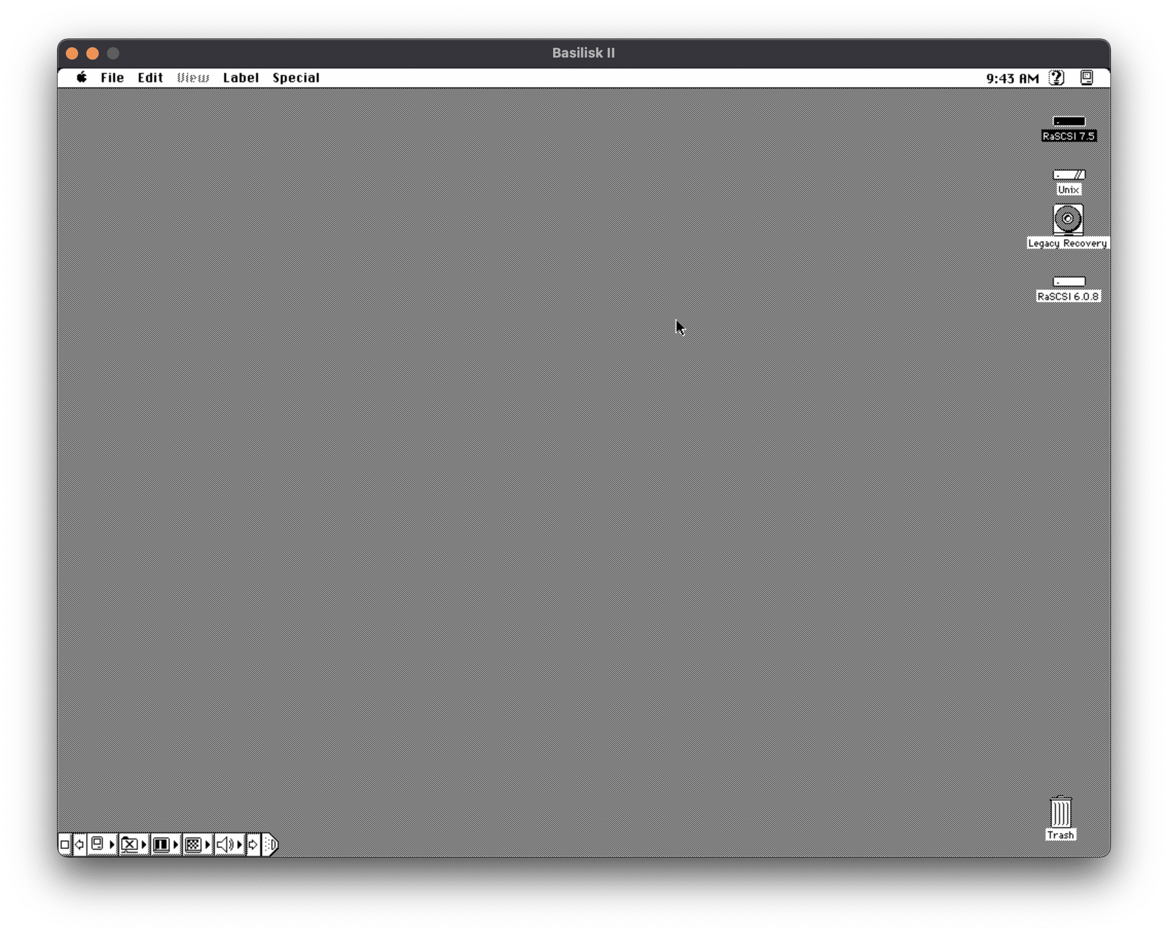

Ahh I now remember one part of the puzzle! For shared folders/drives to work you need System 7.5+. Here's what I just did to make it work:
Download RaSCSI 7.5.3
Download RaSCSI 6.0.8
(I also had the legacy recovery cd in there too)
Using a IIci rom.
Set 7.5.3 as the boot drive
Add 6.0.8
Set Unix Root
Booted and:
HTH
Using a IIci rom.
Add 6.0.8
Set Unix Root
Booted and:
HTH
This is how ya do it! Kinda of what I was alluding to as keeping a local disk for the EMU itself, and then mounting the ones you need to work with. Great little write up.
