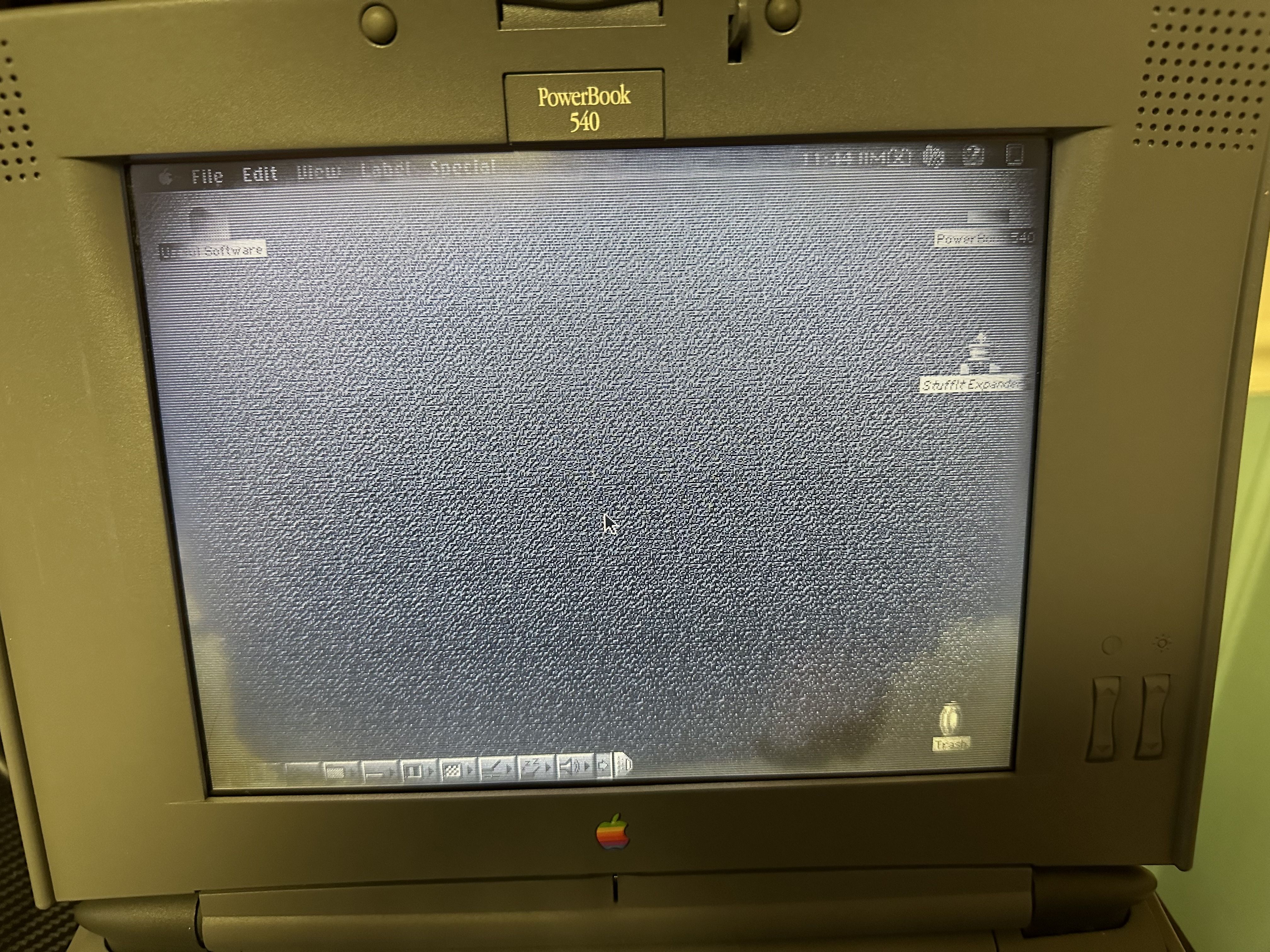

Beyond that I have the 170 which is still fine, and a PowerBook 540 that is affected. It's got a far more interesting failure though, some sort of what looks almost like moisture damage, although there are no other signs of it. The corners on the bottom are yellowed in a very uneven way. I took the panel apart and it's the backlight diffuser. I thought it was just a freak failure, but then I've seen a couple more on eBay that had the same issue. Very odd.
I'll try to find an image.

This photo was taken after leaving it on for a few hours to show the tunnel vision but you can also clearly see the weird yellowing in the bottom corners. It's the diffuser layer itself and is not something that can be cleaned off.

Yes. The 540 panels don't have a specific part number printed on them for whatever reason, but it's a Hosiden panel. I believe the best or one of the best they made, it can run in 256 grays mode (although I think it's been calculated to only display around 64 shades).
