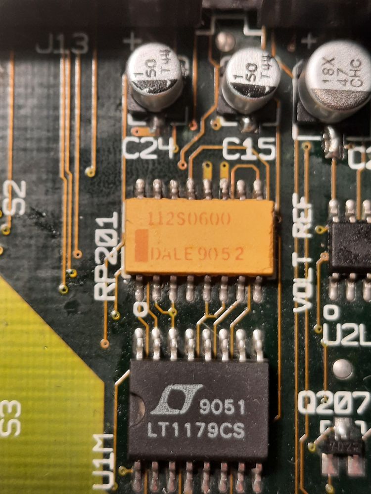

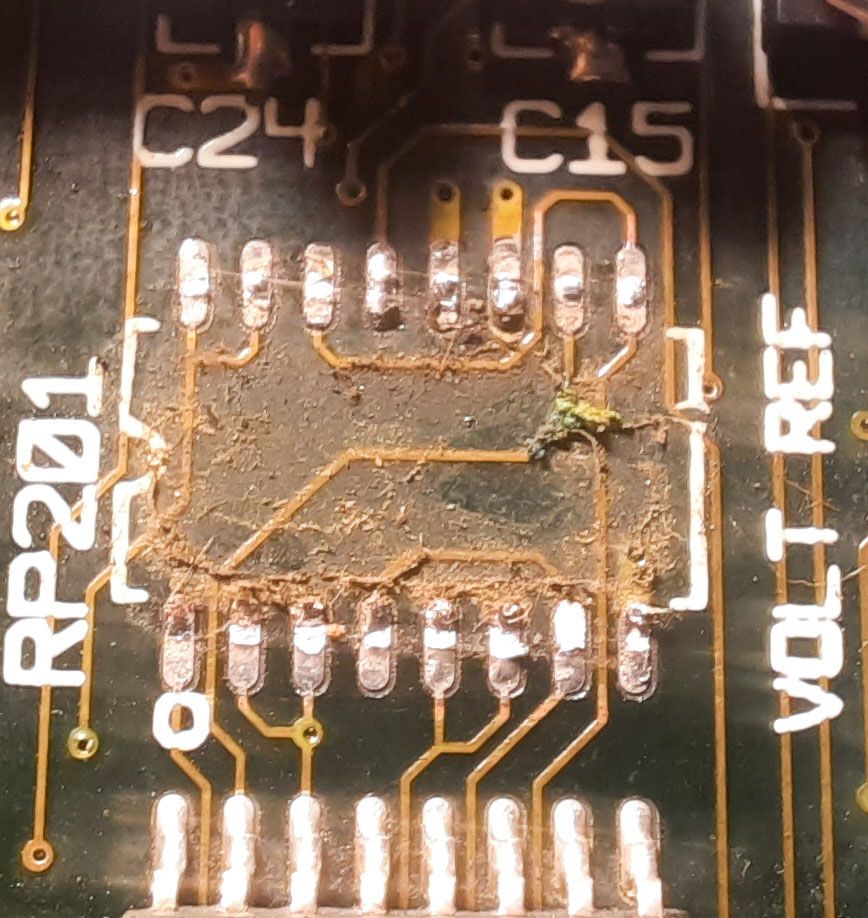

In one video he removes a few of the smd chips and finds cap-rot beneath...
I thought the area looked fine, but decided to remove the resistor-array => and found at least one VIA completely gone...
Next step: patch it up and remove the other smd chips in the area...

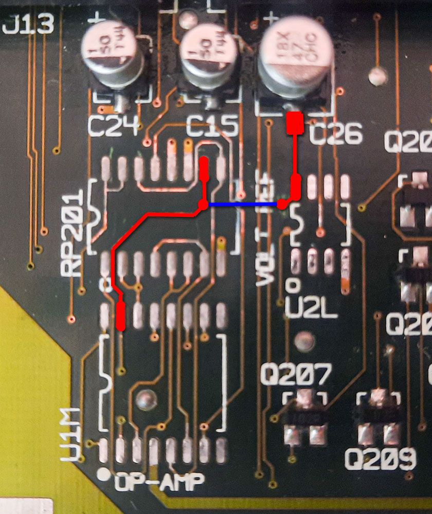

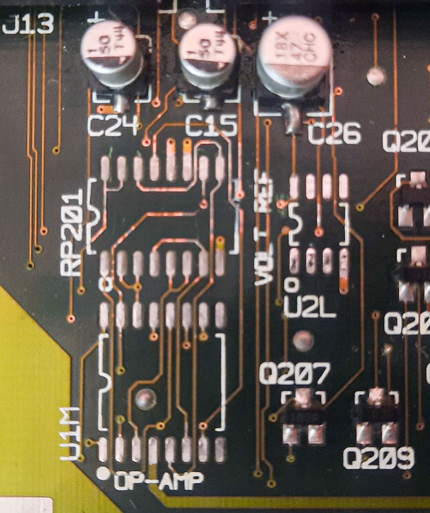

I have removed two more smd chips and found no more corroded traces... :0)
Find a picture attached for future reference of the traces under the chips... so you can check for continuity without removing the chips...
Red: Topside, Blue: Bottomside
Cheers, TOM:0)

Hi and Eureka!
after soldering everything back and patching up the bad VIA the Portable has the correct voltages, recognizes the battery and its charging-level, boots from Floppydisk even without an external PSU attached... NICE :0)
