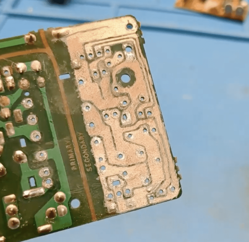

Working on various parts of my Macintosh Portable as I await RAM to replace on my board.....
This is the M5136 (CR-76U) from my non back lit version.
Is this salvageable? Should I just Dremel the lower part off and re-tin it....

I recap'ed my Portable power supply that was in similar/worse condition... one tip is to (carefully!) do an output voltage test before you re-glue the case together, in case any adjustment is needed. Be careful of course as the line voltage is right there and lethal until the case is re-sealed.

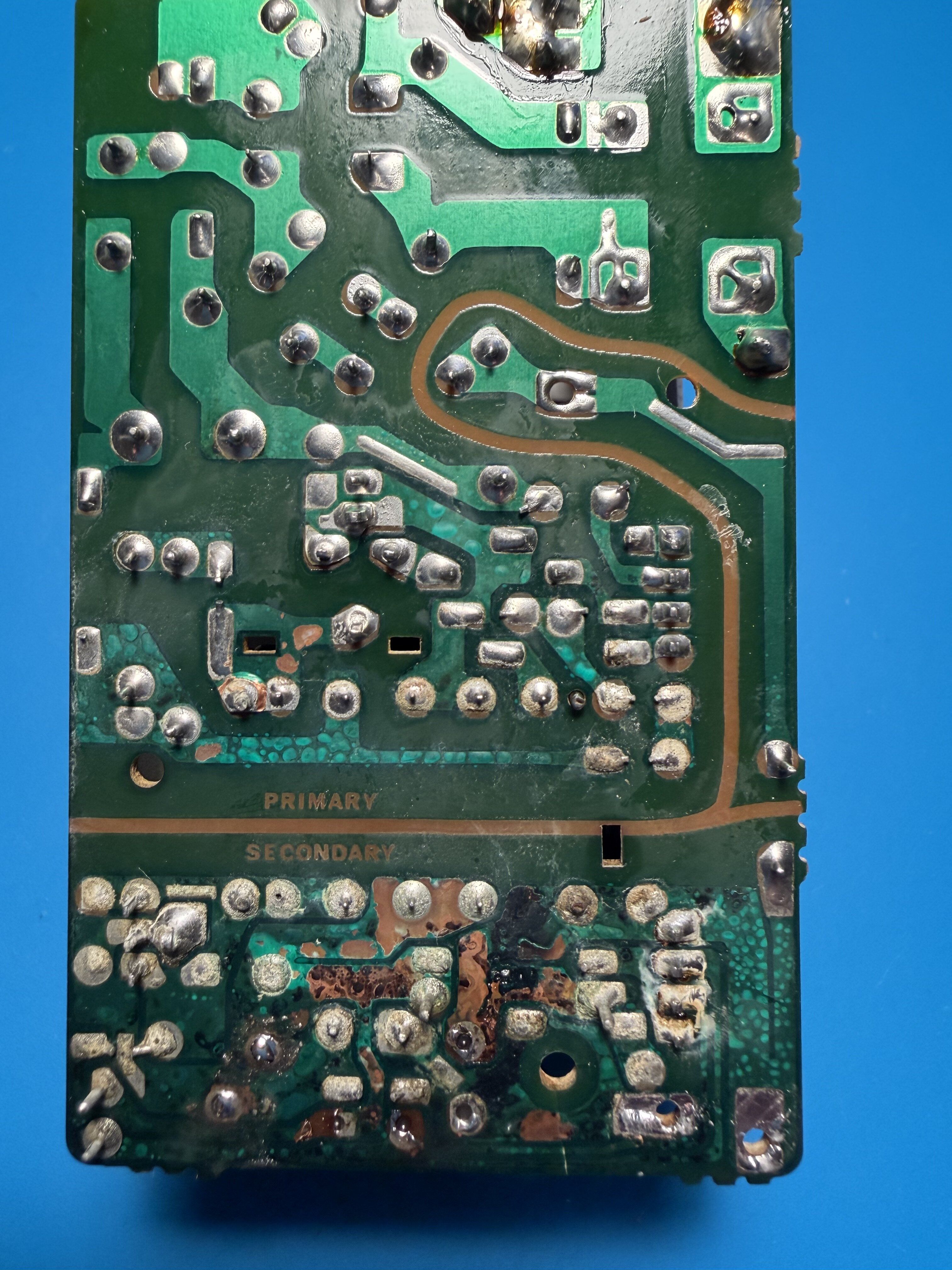

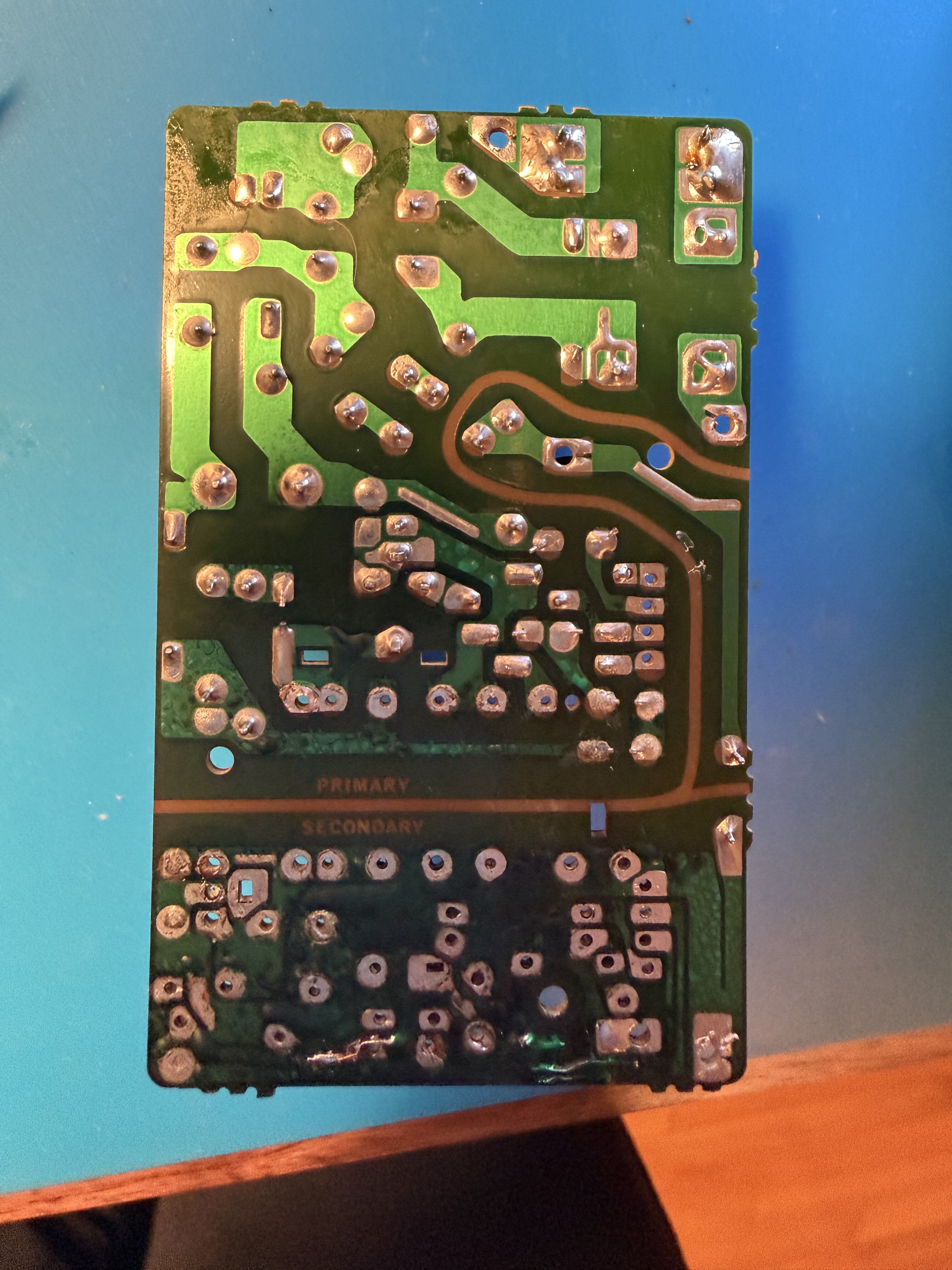

Well. I just placed some small wires to extend the areas broken. The transformer fit fine with some careful guidance. Power supply is fully functional. This is the repair -- not pretty but functional. I didn't end up using the Dremel, just checked continuity and fixed some areas where the board had been eaten away and cracked. All components replaced and new caps. Then checked the output at 7.5 V before I used it.... charging my Mac portable battery just fine.
Here is a picture of the "repaired" board.

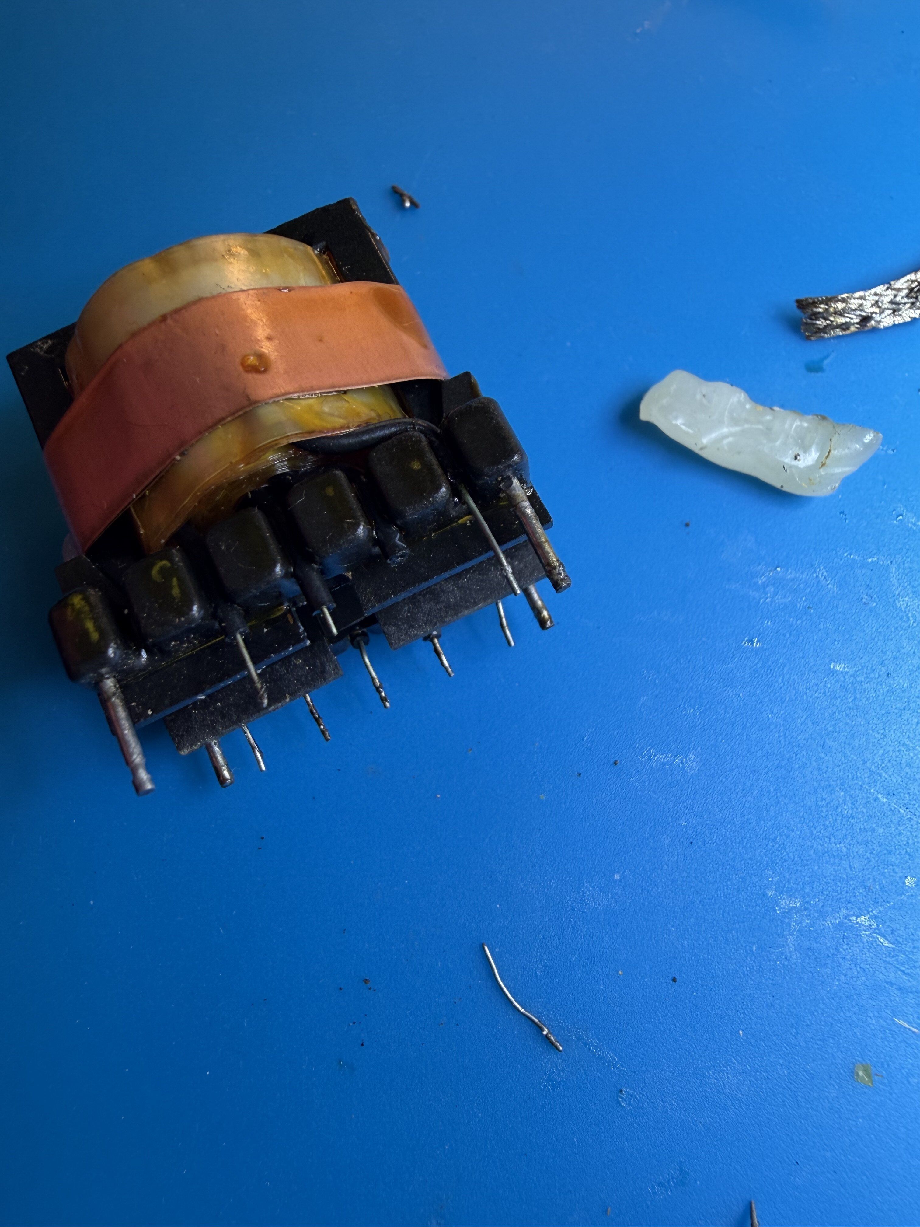

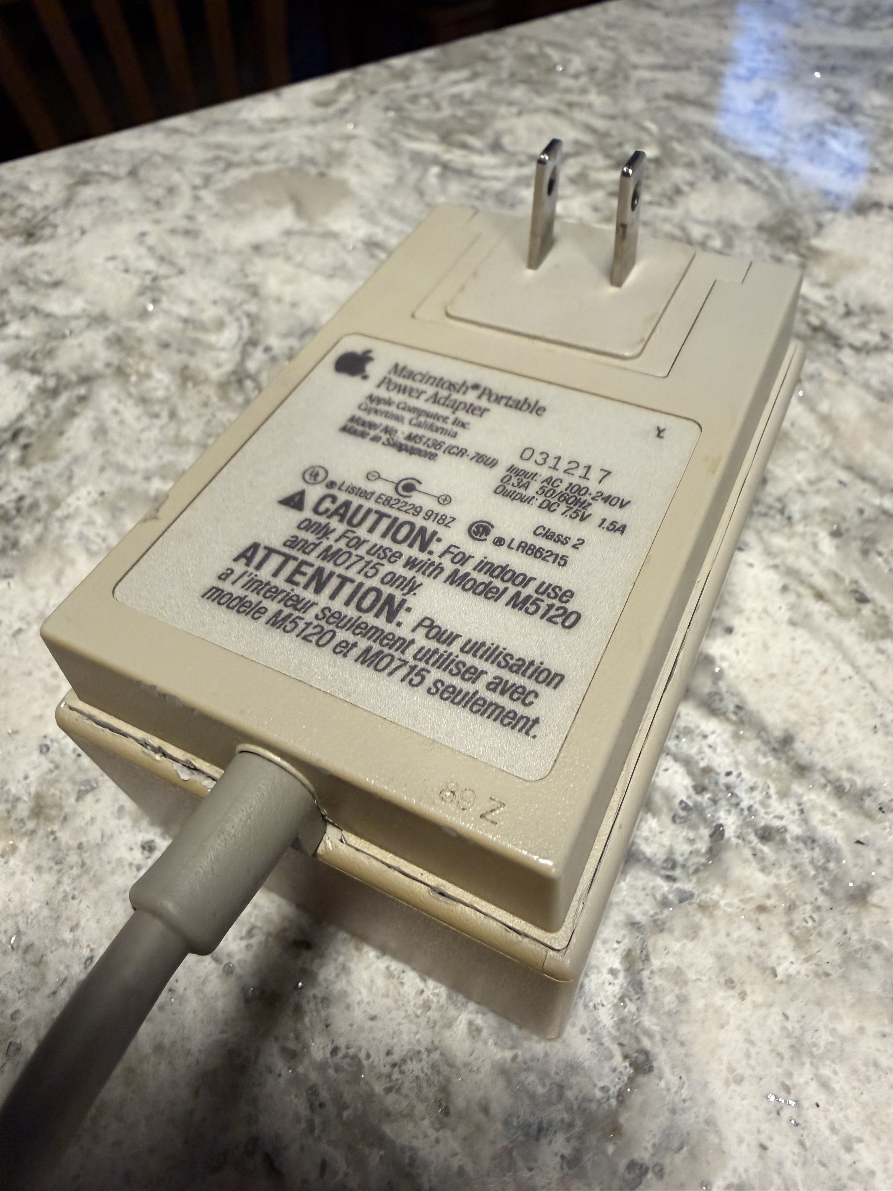

The case survived my screw driver prying method from the entry point of the cable. I used some small shims to get it open. Nothing cracked but I just worked it slowly. There is one screw at the bottom holding the board down once you are inside the case, it was rusted well as it is right where the capacitor carnage occurred.
Here is the picture of my reassembled brick.... not too bad but for some scratches....
