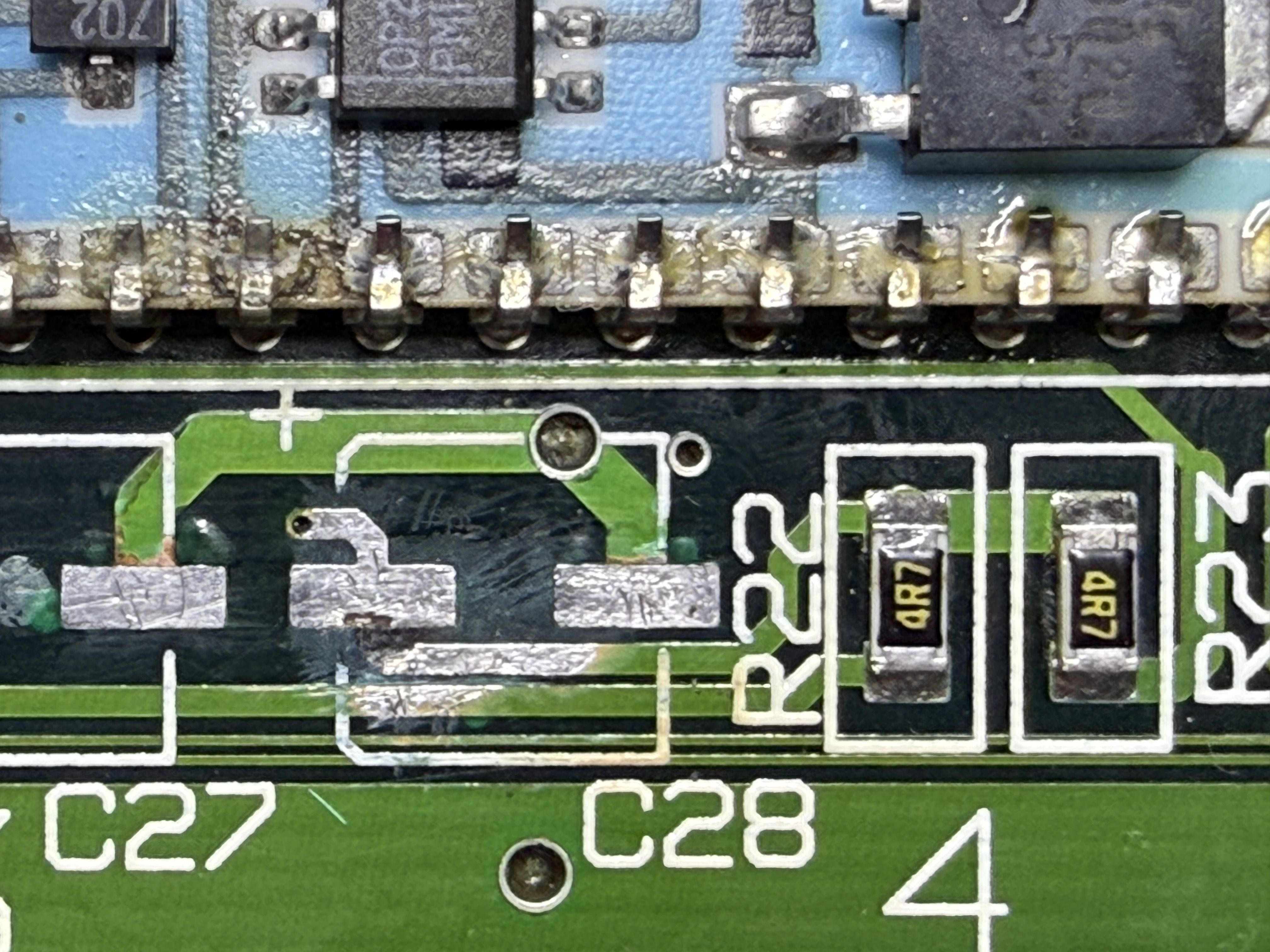

This is photo from Mac Portable non-backlight. Trying to recap and repair the traces. I noticed the 2 tinned traces coming from R22 show continuity across R22 resister. Should they show continuity? What is likely causing that if not?

That resistor should be 4.7 ohms, which some meters may determine as low enough resistance to beep “continuity”. What does the meter say in resistance mode?

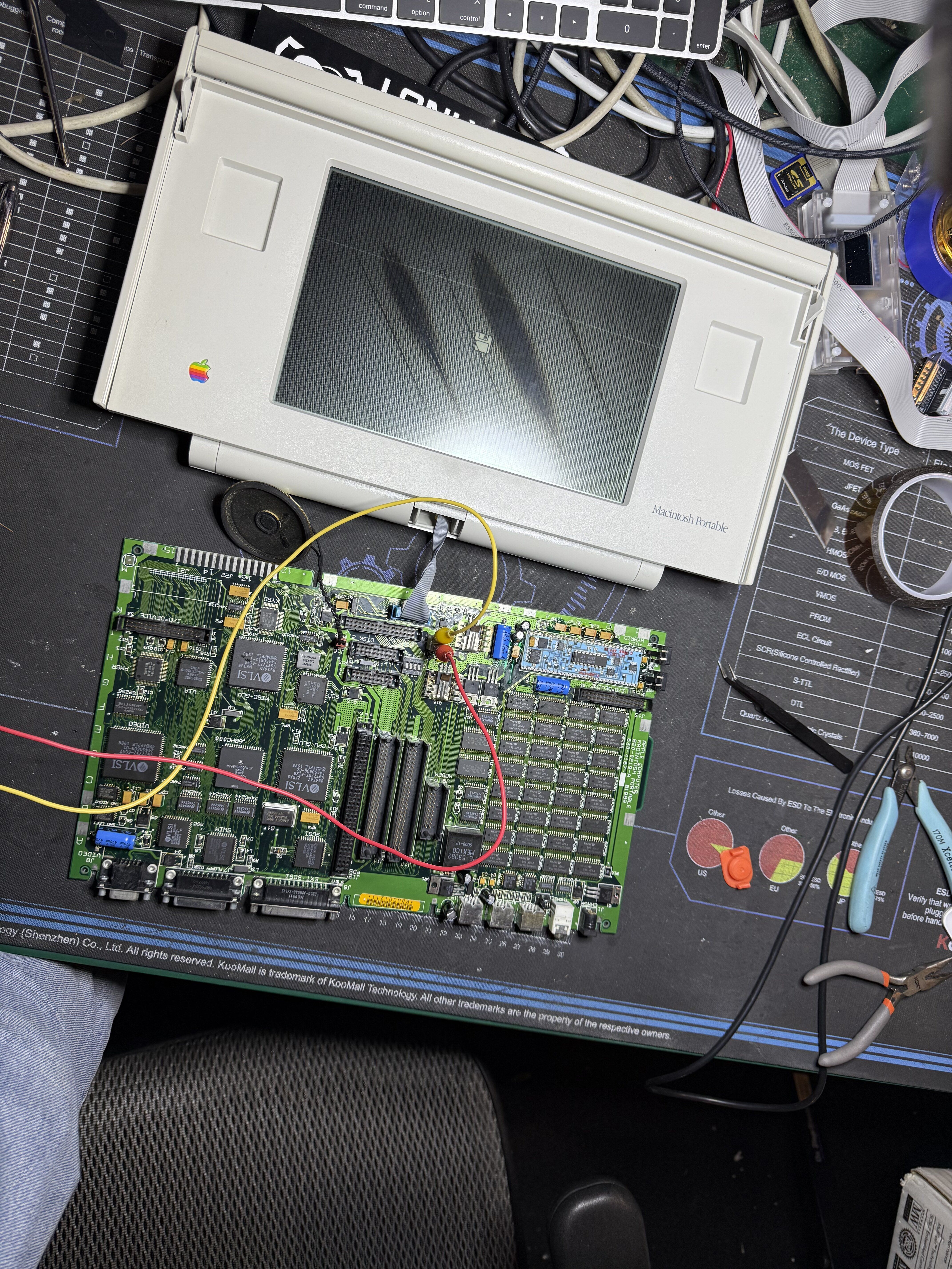

After fixing 3 traces, 1 missing pad and recap, it lives again, but has display issues. See vertical bars in the Display. Clearly the display needs replace but are the bars in the display because of the board or the display itself? I do not have another portable to test with.

Update:
  1. The vertical lines in the display cleared up after the ultrasonic clean.. Only issue with display is the physical damage.
  2. Boots from external Floppy fine. Internal did not work with original drive but have not service it yet.
  3. Sound is good.
  4. Unable to boot from external SCSI via ZuluSCSI or HD.
Is there a schematic or matrix available for this non-backlight board? I need to hunt down the SCSI issue.
