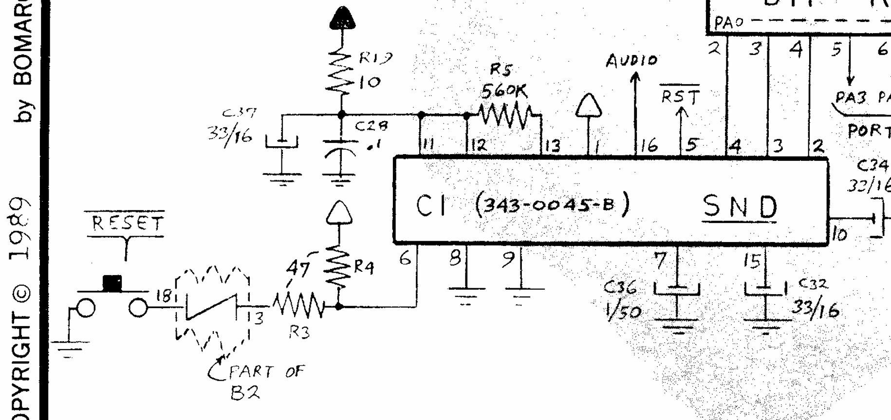

Traced RST's fan-out via the Bomarc SE schematic (sheet 3 of 4) — it connects to the SND chip (343-0045-B) pin 5 and VIA pin 34, plus the reset switch/pull-up circuit (R12, C28, and a mystery component labeled "PART OF B2"). Tried the known SE/30 fix of jumpering SND pins 7-to-15 with a 1kΩ ohm resistor (documented elsewhere as a fix for "reset signals generated endlessly" on this exact chip) — no change. Confirmed SND pin 5 is a schematic-documented input, so it's just receiving the bad signal, not the source.
Board was fully recapped earlier in this process, no change in behavior before/after, so electrolytics are ruled out entirely.
Still hunting: whatever is actively driving RST low. Leading suspects are the unidentified "PART OF B2" component near the reset switch, or the VIA's RST pin if it turns out to be an output rather than an input. Does anyone know what "B2" refers to as a physical component, or whether VIA pin 34 (RST) is input or output on the R65C22?

I have a pair of SE's, but they both have always worked well, I've not needed to work on those; but my SE/30's taught me that it's the Sound chip that releases the Reset line and drives the entire Reset circuit to 5v. Hoping someone else more familiar with the SE can fill in the details for us.
Mark_W
Feb 2, 2026
31
27
Stumbled across this reset issue on an SE FDHD and made a post a while ago, it will get stuck at checkerboard pattern on powering up for ~10s, then it chimes and boots up as normal. Turns out I put a much larger capacitor at C36 by mistake when recapping, used 47uf instead of 1uf.
My theory is on powering up or pressing reset button, sound chip will charge C36 until it reaches ~5V then release /RST signal. Also iirc /RST signal is indeed driven by the sound chip and it's an output not input.
So check voltage on all pins on sound chip, see if you get 5V on pin 1/6/7. If so then sound chip should output 5V on pin 5. You need to check this with pin 5 isolated, either desolder it or cut traces connected to it. If sound chip is fine then you got a bigger problem, /RST goes to a handful of chips on the motherboard, IWM, CPU, SCSI, etc.. Need to isolate them one by one and identify which chip holds /RST low

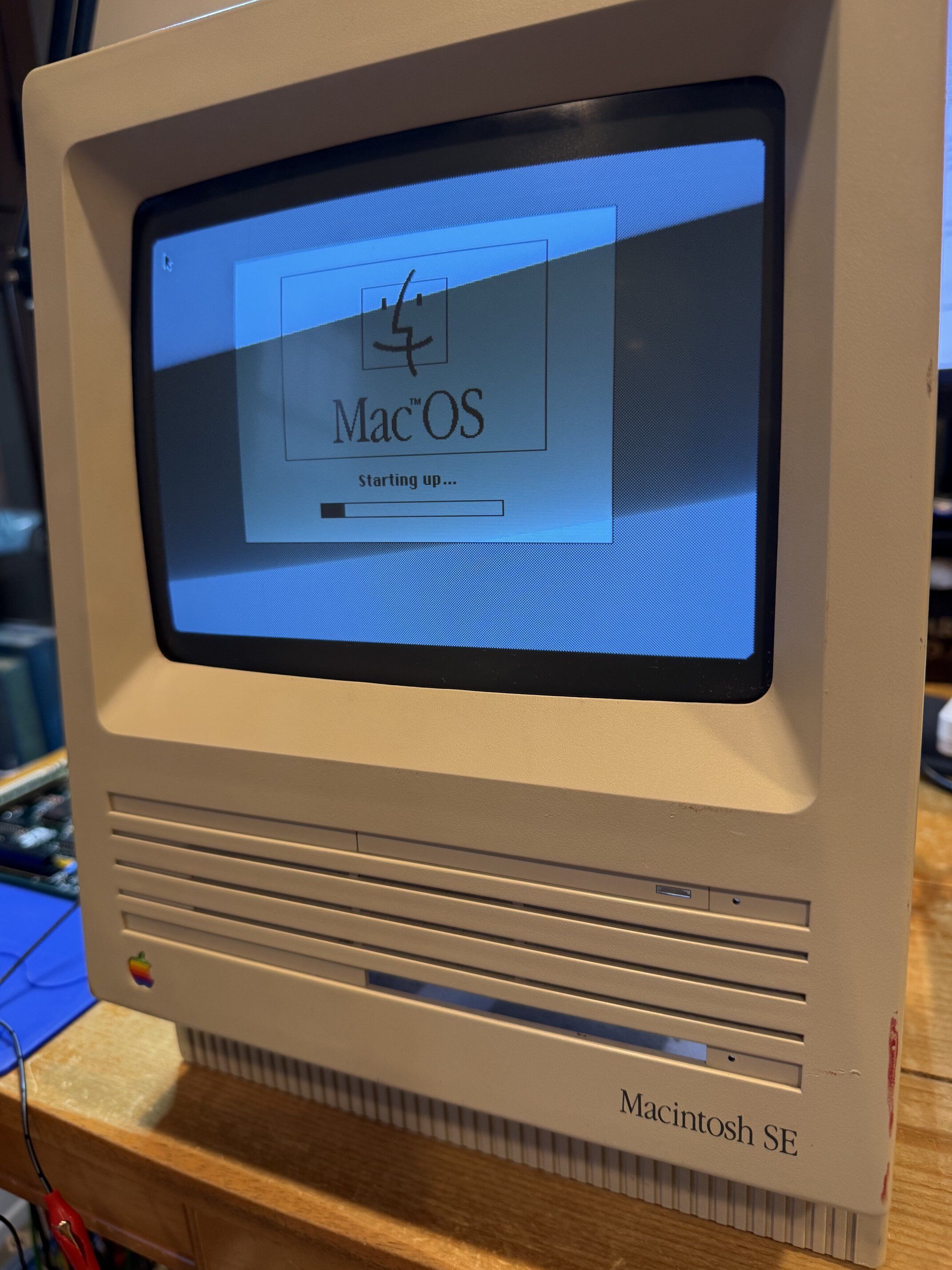

SOLVED: Checkerboard/noise turned out to be two separate faults — bad ROM LOW chip + a loaded reset line
Wanted to close the loop on this thread with the full resolution, since it ended up being two independent problems stacked together, and the diagnostic path might help someone else down the road.
Root cause #1: A bad ROM LOW chip (342-0353-A).
Root cause #2: The reset circuit's pin 6 on the SND chip (343-0045-B) was being loaded down through R3, on the switch/"B2" side of the reset network — preventing SND from ever properly releasing /RST (pin 5) high, which kept RESET/HALT on the 68000 permanently asserted low.
How we got there, briefly:
  • Started with a noisy/speckled checkerboard, no boot chime, single speaker click.
  • Ruled out RAM (multiple tested SIMM sets, all slots), chassis/PSU/analog board (via known-good chassis swap), and initially ROM/IWM (via socket-position correction and a first-pass known-good swap).
  • Full recap performed — no change in symptoms before/after.
  • Found /RESET and /HALT on the 68000 permanently stuck at ~150-200mV, actively driven low (not a passive short — confirmed via power-off continuity showing no path to ground, but a real DC voltage under power).
  • Traced /RST's fan-out via the Bomarc SE schematic (sheet 3/4) to the SND chip (pin 5) and VIA (pin 34), plus the reset switch/pull-up network (R3, R4, R12, "PART OF B2").
  • A very helpful reply pointed out that the SND chip's pin 5 is genuinely an output — it releases /RST high only after an internal RC-style timing condition is satisfied, and suggested isolating pin 5 to check whether the chip itself was at fault.
  • Built a full pin-by-pin voltage comparison table between the known-good and troubled boards. Found pin 6 (also on the reset switch's side of the SND chip) was sagging significantly compared to the good board, along with a measurable voltage drop across R3/R4 — real evidence of current being pulled through that branch that shouldn't have been there at rest.
  • Lifted the switch-side leg of R3, isolating the reset-switch/B2 network from pin 6. Pin 6 immediately rose to a clean 5.06V, pin 5 followed it up to 5.06V, and RESET/HALT at the 68000 came up clean too — matching the known-good board across the board.
  • Still got checkerboard after that fix, which told us there was a second, independent problem. Went back and swapped ROM/IWM with the known-good board one more time under these new, properly-reset conditions — and this time it was conclusive: ROM LOW was bad.
With both faults addressed, the board now boots cleanly to the Mac OS startup screen.
