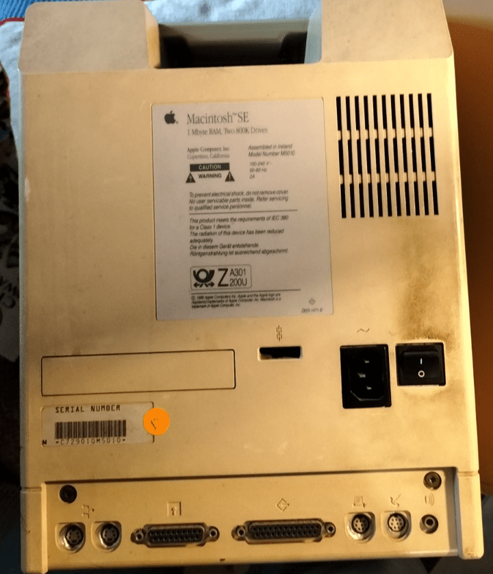

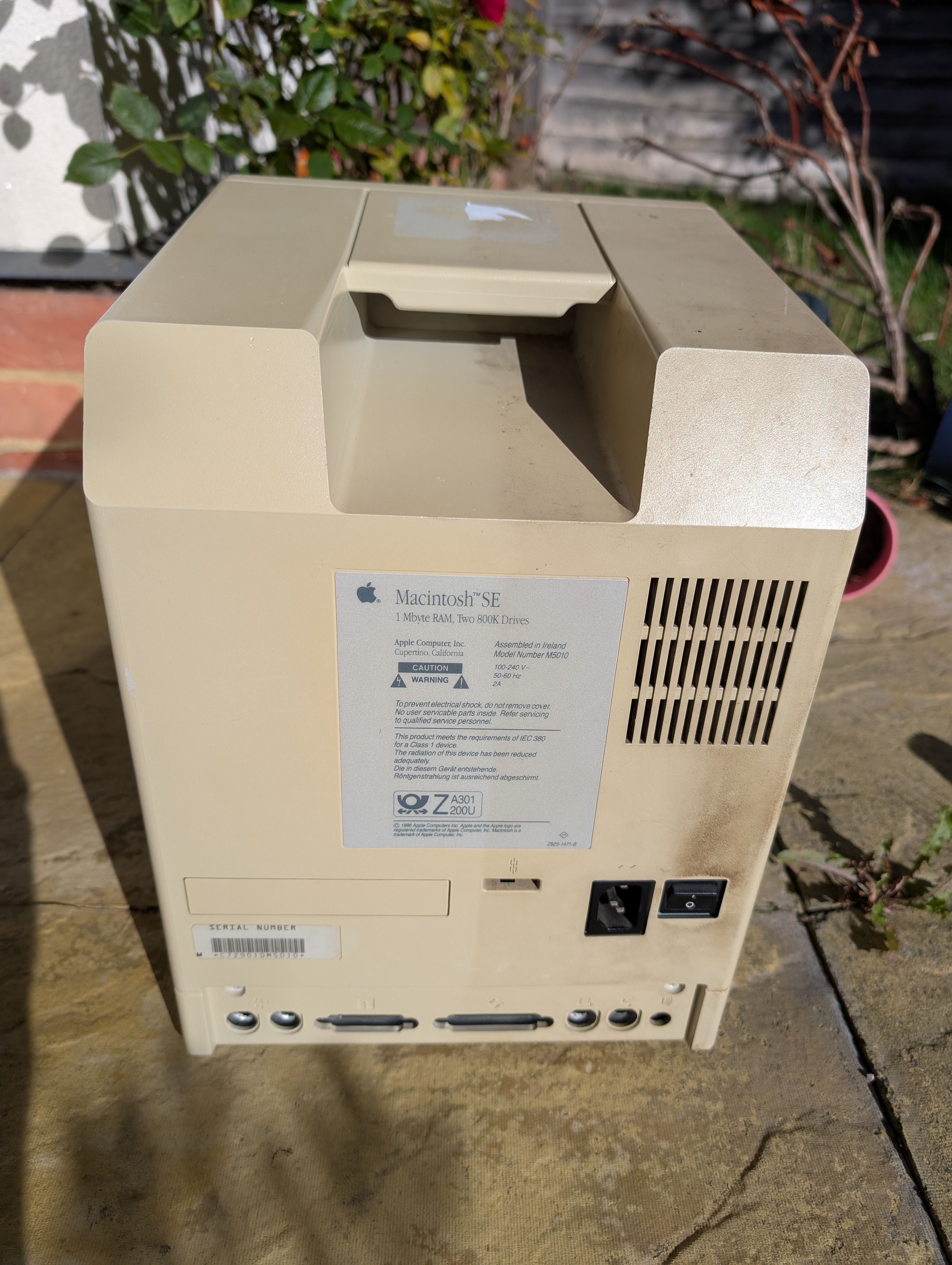

I did not have high hopes when it arrived like this:
However the whole thing was bundled with two full rolls of bubble-wrap to the extent it was roughly spherical inside.

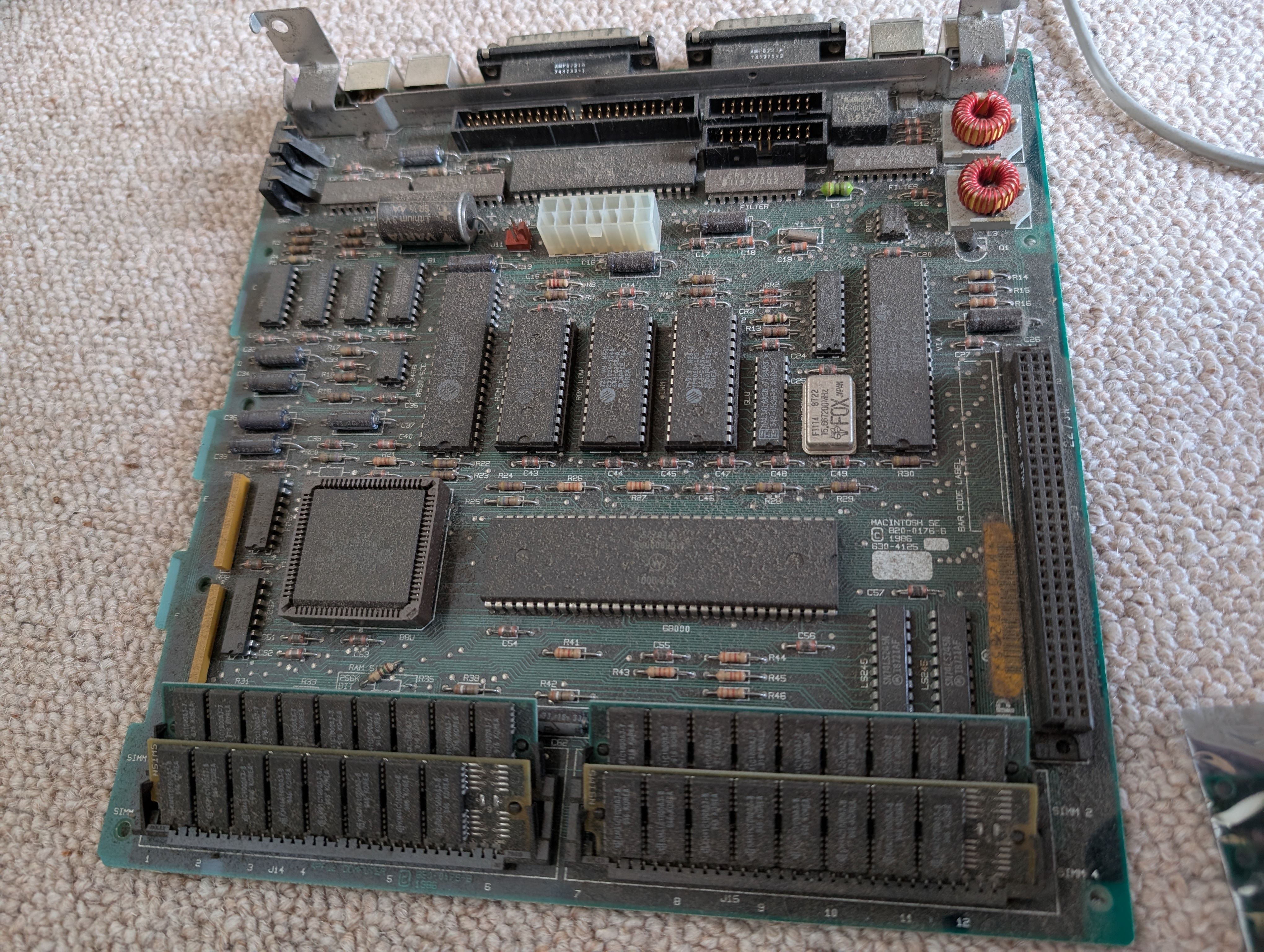

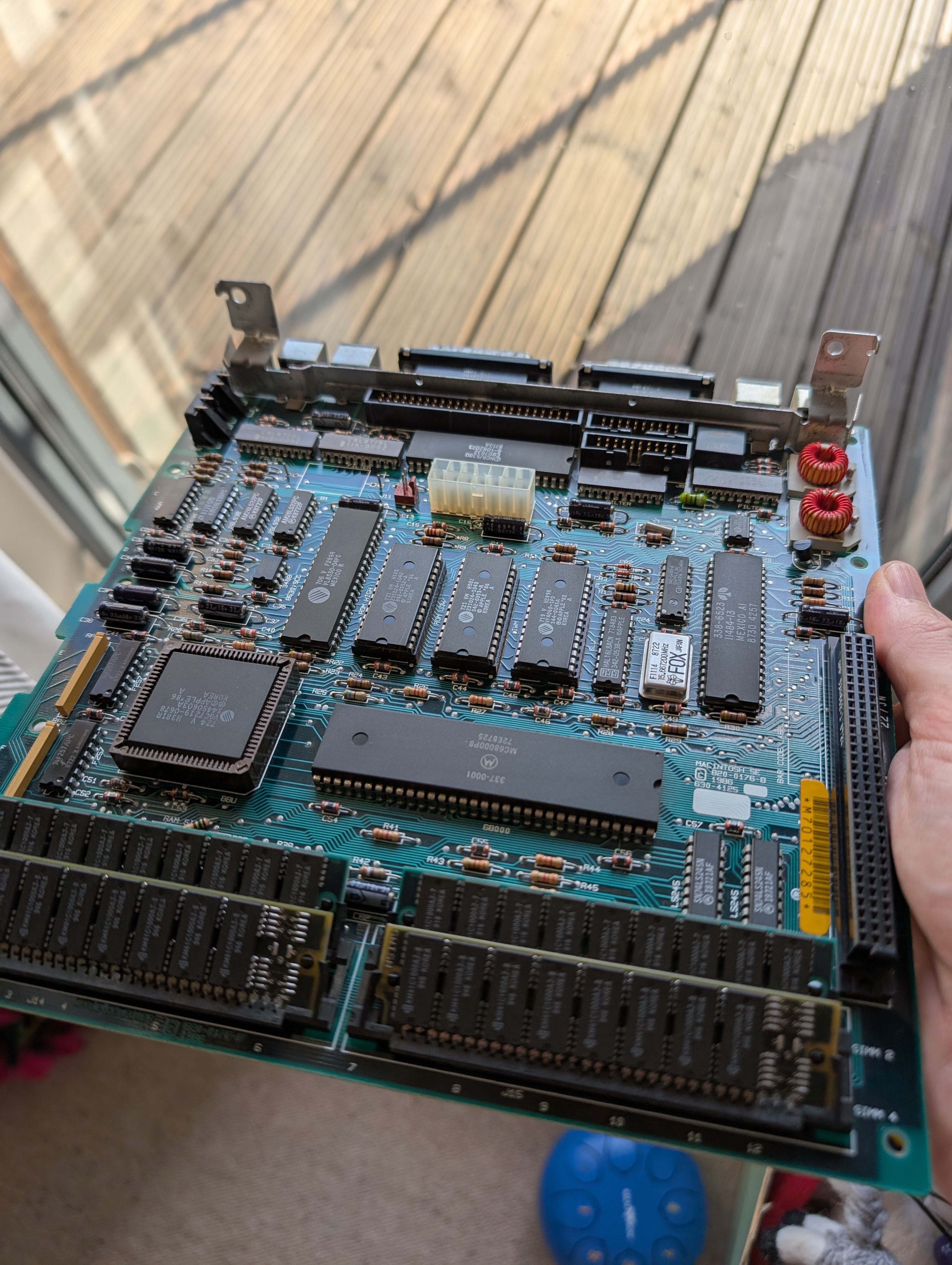

Very dusty, but the original soldered battery had not leaked. I clipped it off, then gave the board a once-over with the vacuum and a soft paintbrush. No need for a bath for this one. It shined up beautifully:
I checked the RAM chip part numbers using ChatGPT, and the RAM jumper resistor was clipped. Good news: 4MB of RAM, the maximum specification! Whoops - I had already ordered four 1MB 30 pin SIMMs which I had seen for a good price (£17). Good spares to have nonetheless. I hadn't appreciated that Macs accept parity RAM intended for servers (ignoring the parity) - which is why some SIMMs have the extra chip, shown above.

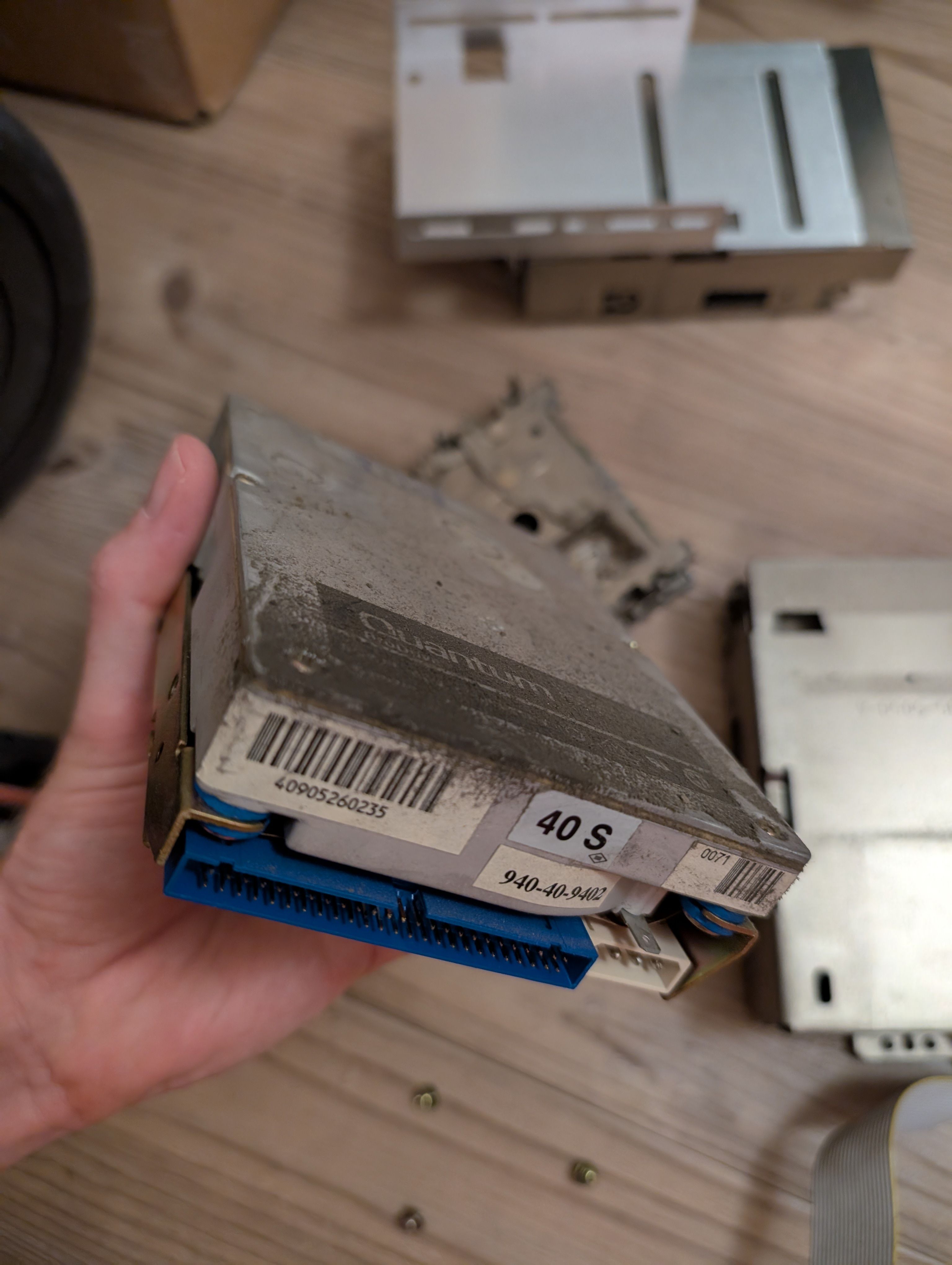

There was a dead 40MB Quantum hard drive on an aluminium bracket on top of the floppy drives (just enough space). I discovered that hard disks had never been sold as an option from Apple for the dual floppy SE, so it must have been an aftermarket addition. I tossed this away believing there to be no chance of repair, but I have subsequently learned that it is usually possible to slide the cover back slightly, opening it just enough to replace the decomposed rubber head parking bumper. Oh well, one for the next restoration perhaps :)

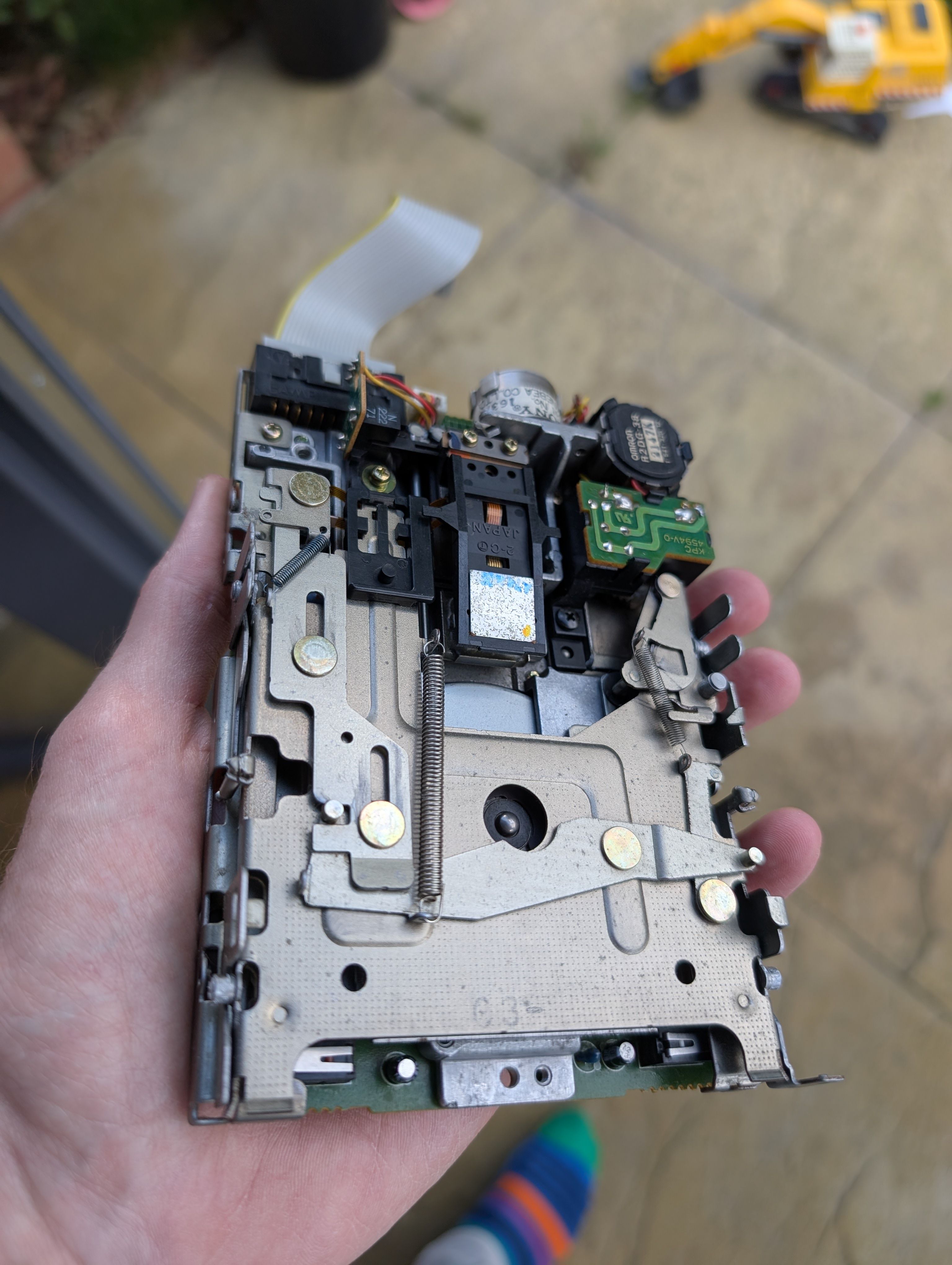

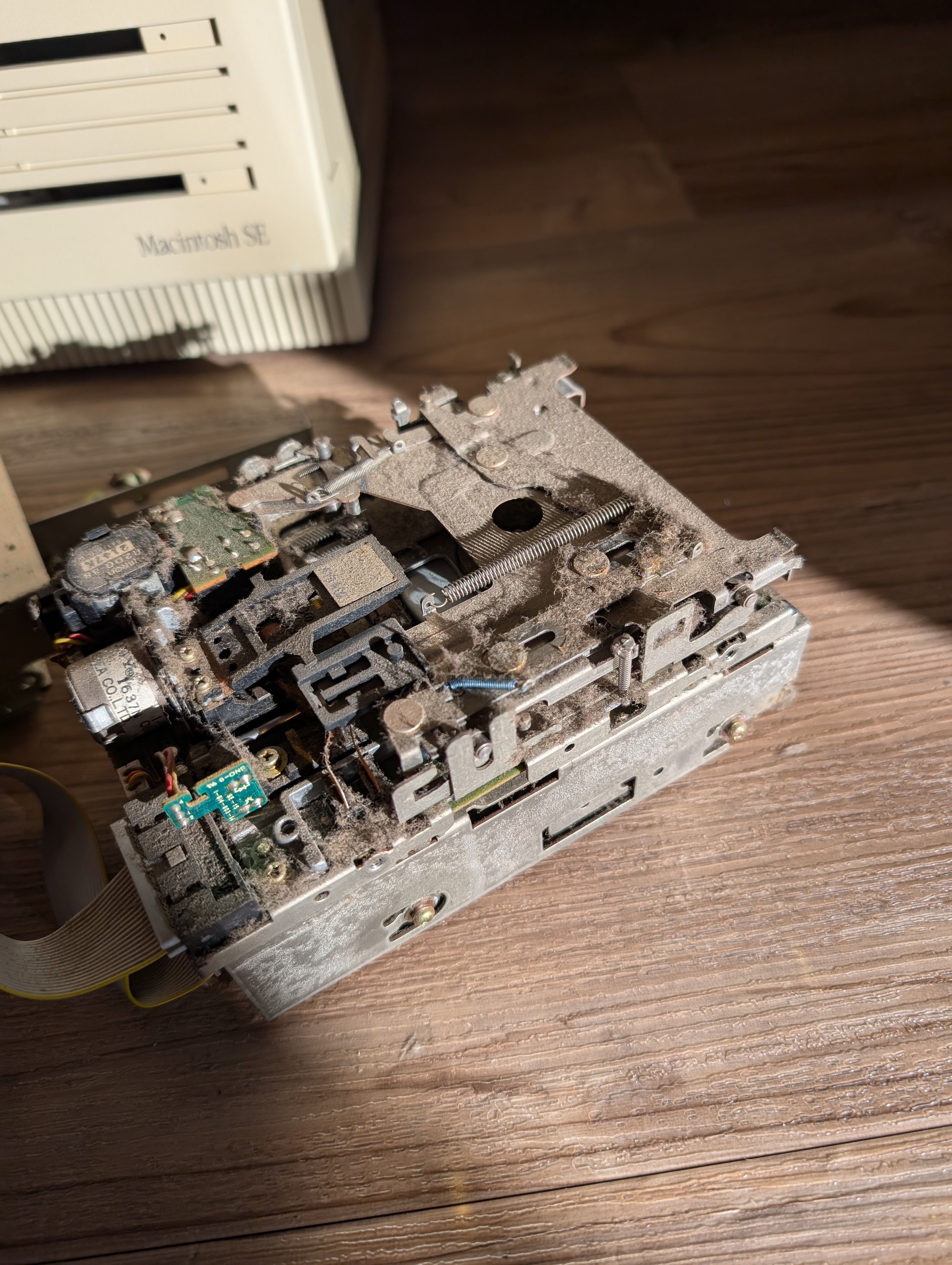

I didn't want to open up my SE/30 to take its BlueSCSI, so the only way I could test the machine was to refurb a floppy drive. Quite a task, as it turned out! This machine must have been a workhorse.
During this process I discovered that my SE/30 SuperDrive was itself a bit sticky despite me re-greasing it only months ago. I bought some sewing machine oil from eBay to use in addition. This apparently does not dry out. I cleaned the heads with a cotton bud soaked in isopropyl alcohol. Where the metal looked roughened by microscopic surface corrosion, I rubbed it with WD-40 which seemed to be very effective. Neither drive needed the eject mechanism cog replacing. I do wonder whether these get broken by people attempting a motorised eject while the drive is all gummed up, which I was careful to avoid.

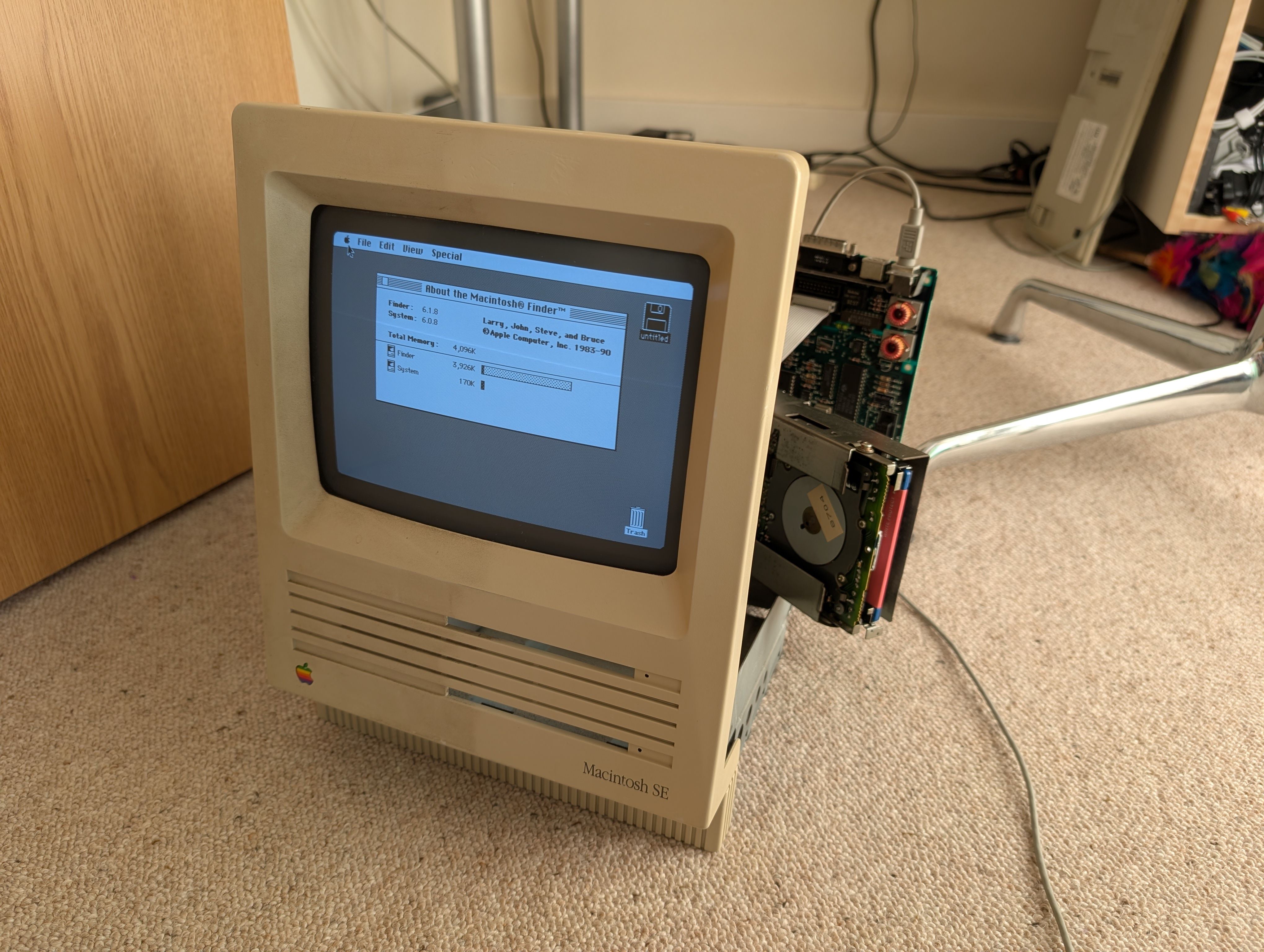

Next, I bodged the components together to test. I tried unsuccessfully to tape over the cutout on some high-density floppies I have, to write an 800K floppy for the SE. Although I could create them ok, these were not recognised by the SE 800K floppy drive. My recently restored Amiga could use the same HD disks without issue. I suspected the worst, that the first drive might be dead.

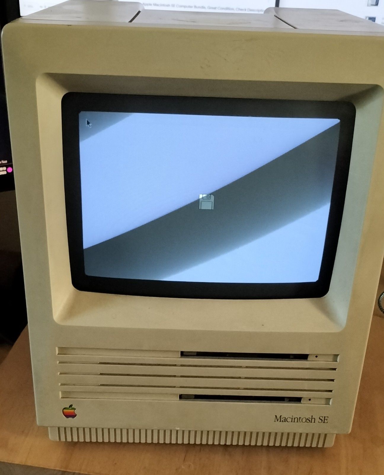

However, after a bit more research I discovered that double-sided and high-density media in fact have a different composition and are written to with a different magnetic intensity. I only had a single double-density floppy disk in the house - the PCMCIA enabling boot disk for my Amiga. I wrote a minimal System 6.0.8 to it, crossed my fingers, and gave it a try...
Successful boot! 🚀 Probably its first start up in decades. I then repeated the cleanup and lubrication process for the second floppy drive.

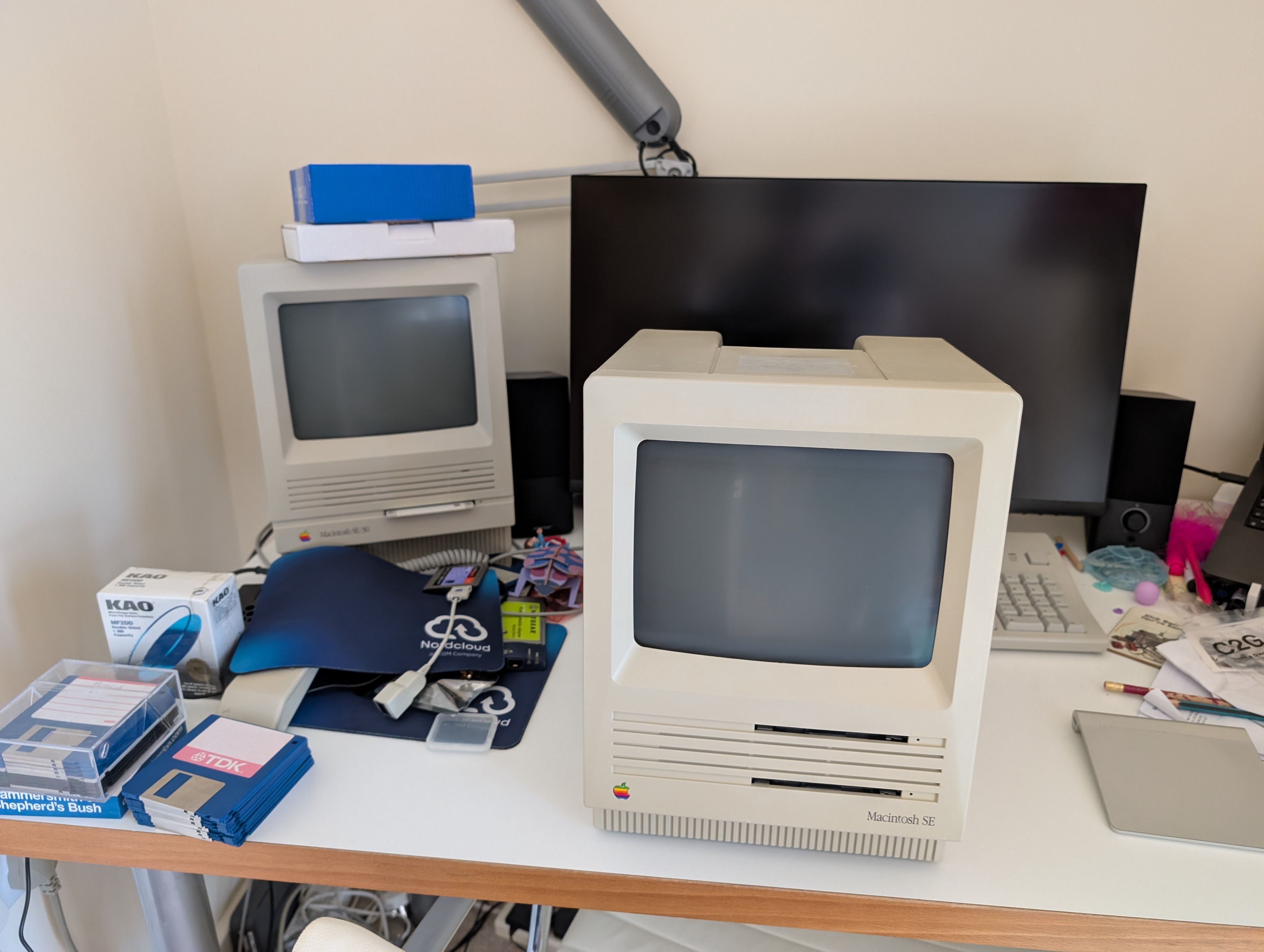

I often forget to take the 'before' photos when I clean things up so I thought it would be fun to do a half-clean on this SE, like they do in car restoration videos (see above image) to highlight the impact.

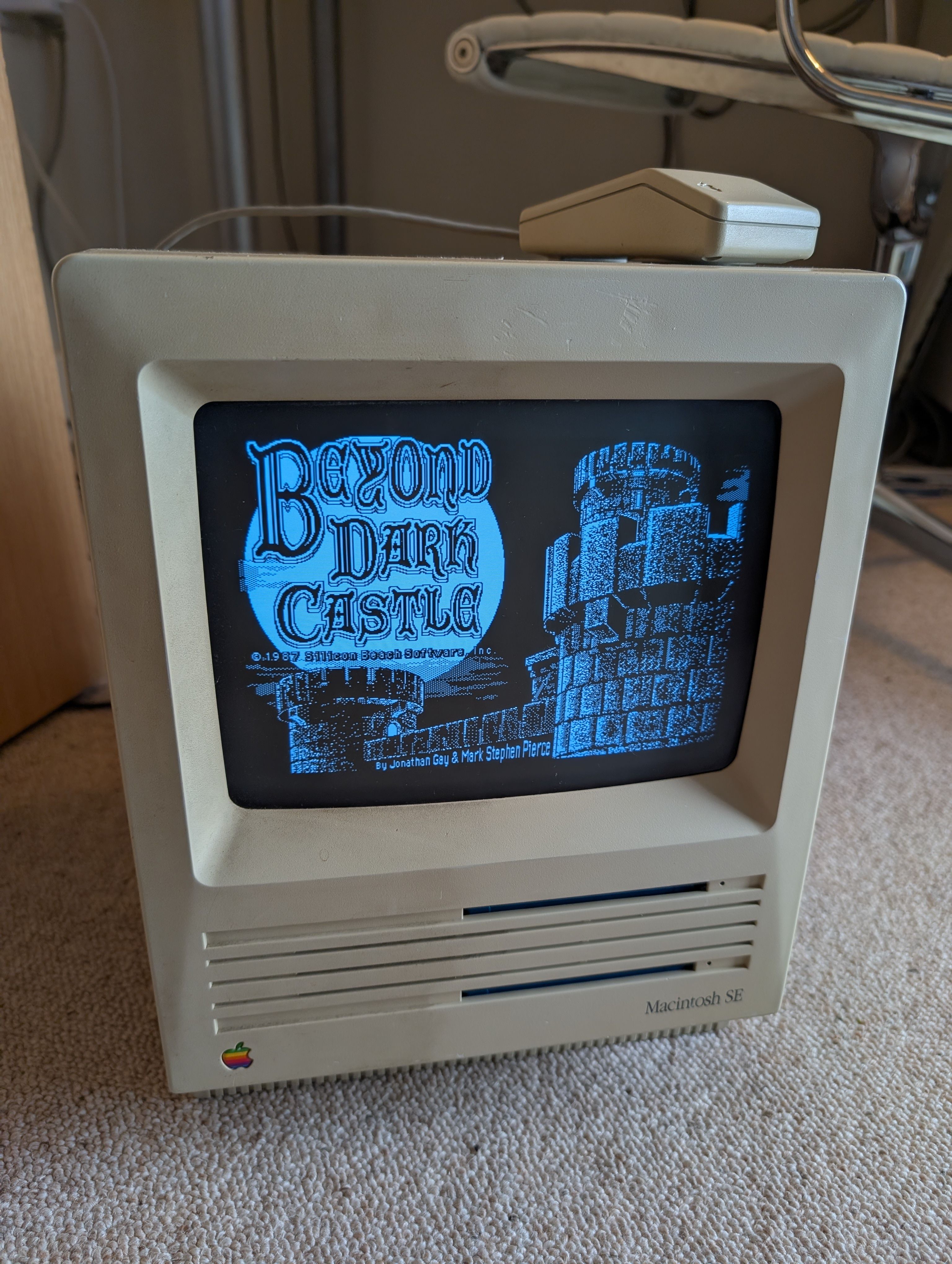

Testing both drives with Beyond Dark Castle, which is spread across two 800K disks, one of them bootable:
After a few days it became clear that the floppy drives had both settled down and were no longer corrupting the media, which was nice. This issue may have been caused by some thin residue on the drive heads, despite the cleaning with IPA.

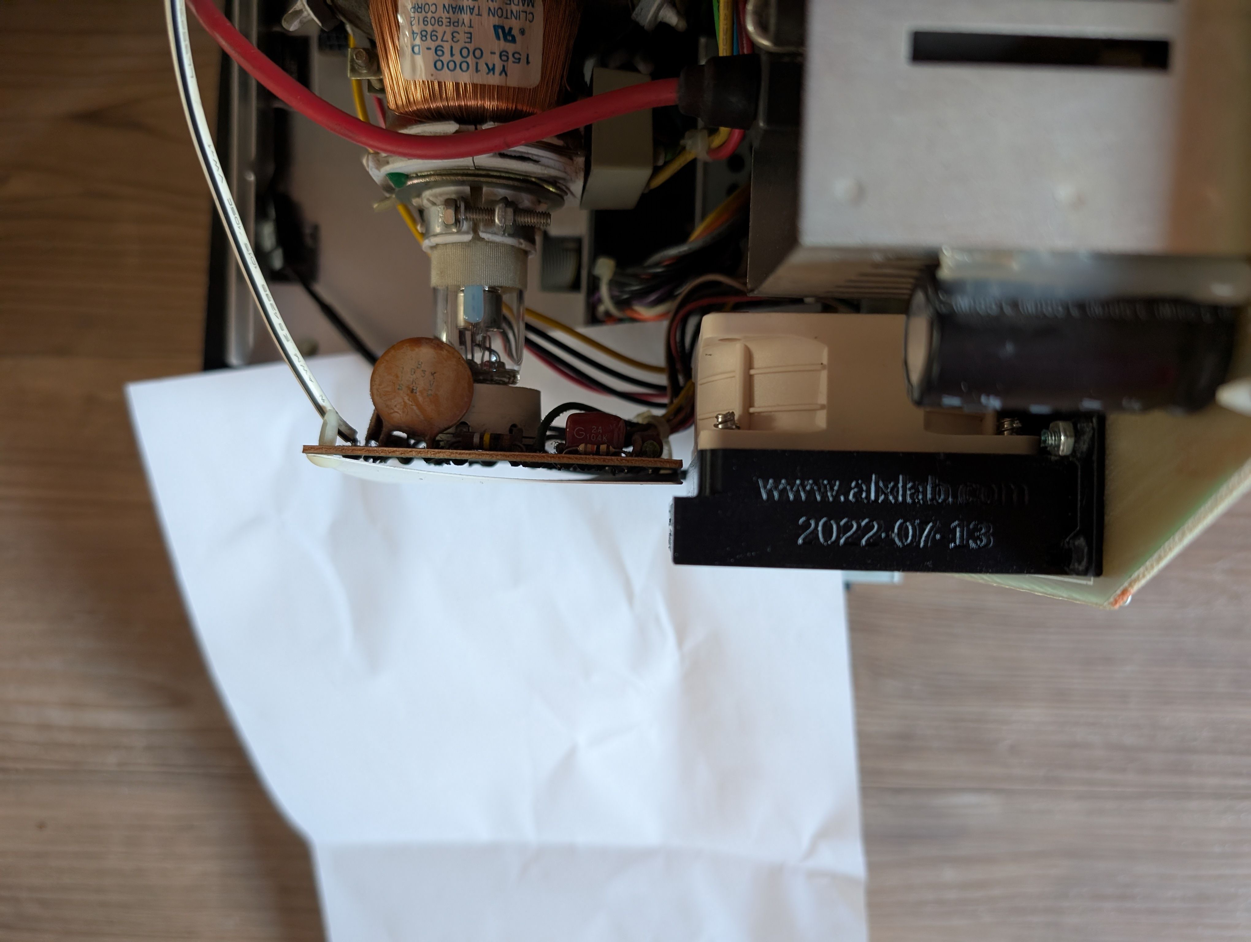

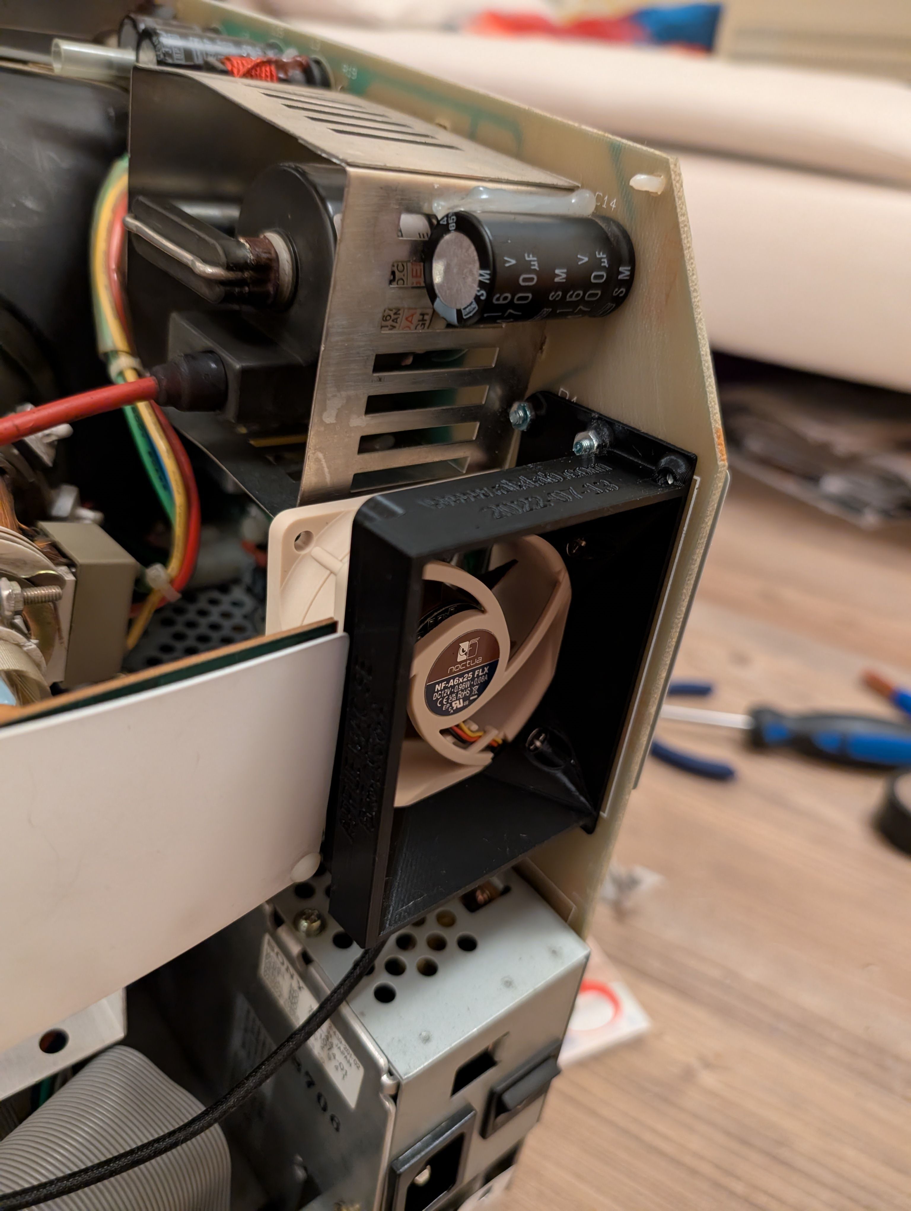

Next problem, the bearings of the helical 'squirrel cage' fan (as used in the early SE) were completely destroyed so I sourced a Noctua NF-A6x25 FLX 60mm fan which was 'opened never used' on eBay for £7, and I had a new fan shroud manufactured in black PLA by JLCPCB for around £6 delivered. Who needs a 3D printer of their own with this kind of cheap reliable service.
Notice the designed clearance around the CRT neck board. Very nice.
I clipped and taped the original fan wires and wired the new one up to the hard drive molex connector. I did not use the optional low noise connectors since the full 3000RPM flow rate only just about matches the original fan's specification.

Unscented baby wipes and a toothbrush are the tools of choice here, with alcohol and label remover solvent for any sticky residues. Magic Eraser, used gently, will clean dirt out from scuffs, which really works wonders. The front bezel above the screen is a good example of this. If you scroll back up to the Beyond Dark Castle photo you will see that this has been gouged quite badly, presumably to remove an asset tag at some point in time. You might think that would be pretty awful, but it's not very noticeable after cleaning.
I cleaned the inside of the case the same way but the vents were quite a pain. I repeated the paintbrush + vacuum cleaner technique for areas like the PSU and the CRT coils.
The SE is a little yellowed compared to my SE/30 (not very visible in this image) but by chance it perfectly matches the colour of a M0116 keyboard which I already owned. I may try the sun-briting method next spring. I did leave it out in the autumn sun for a single day but I didn't notice any change.

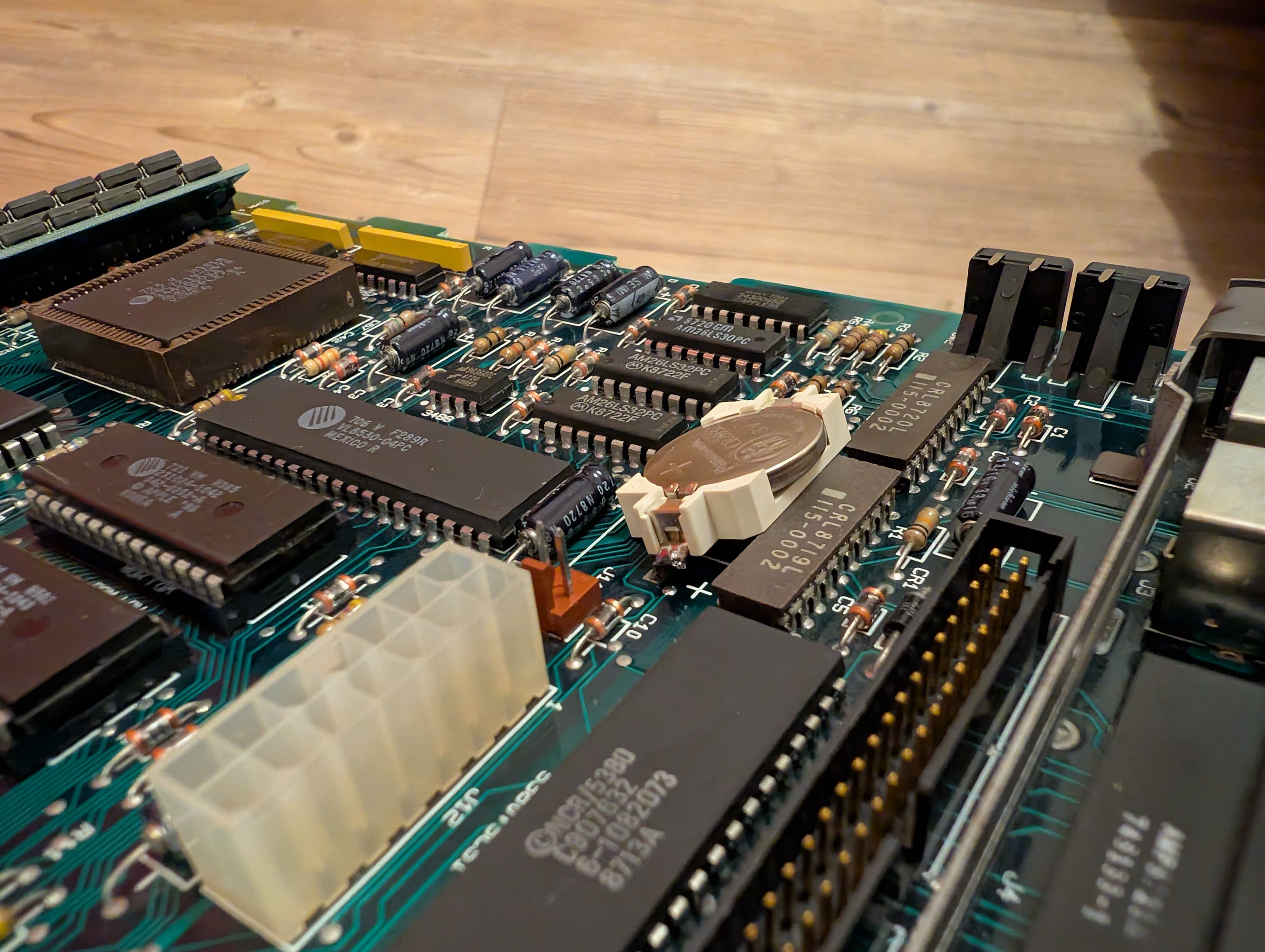

Having measured up the PCB pad spacing for the PRAM battery, I had ordered an appropriate CR2032 holder but it was slightly too wide when loaded with the cell. To avoid it touching the adjacent components I decided to mount it obliquely, soldering it onto the leftover clipped legs of the original battery:

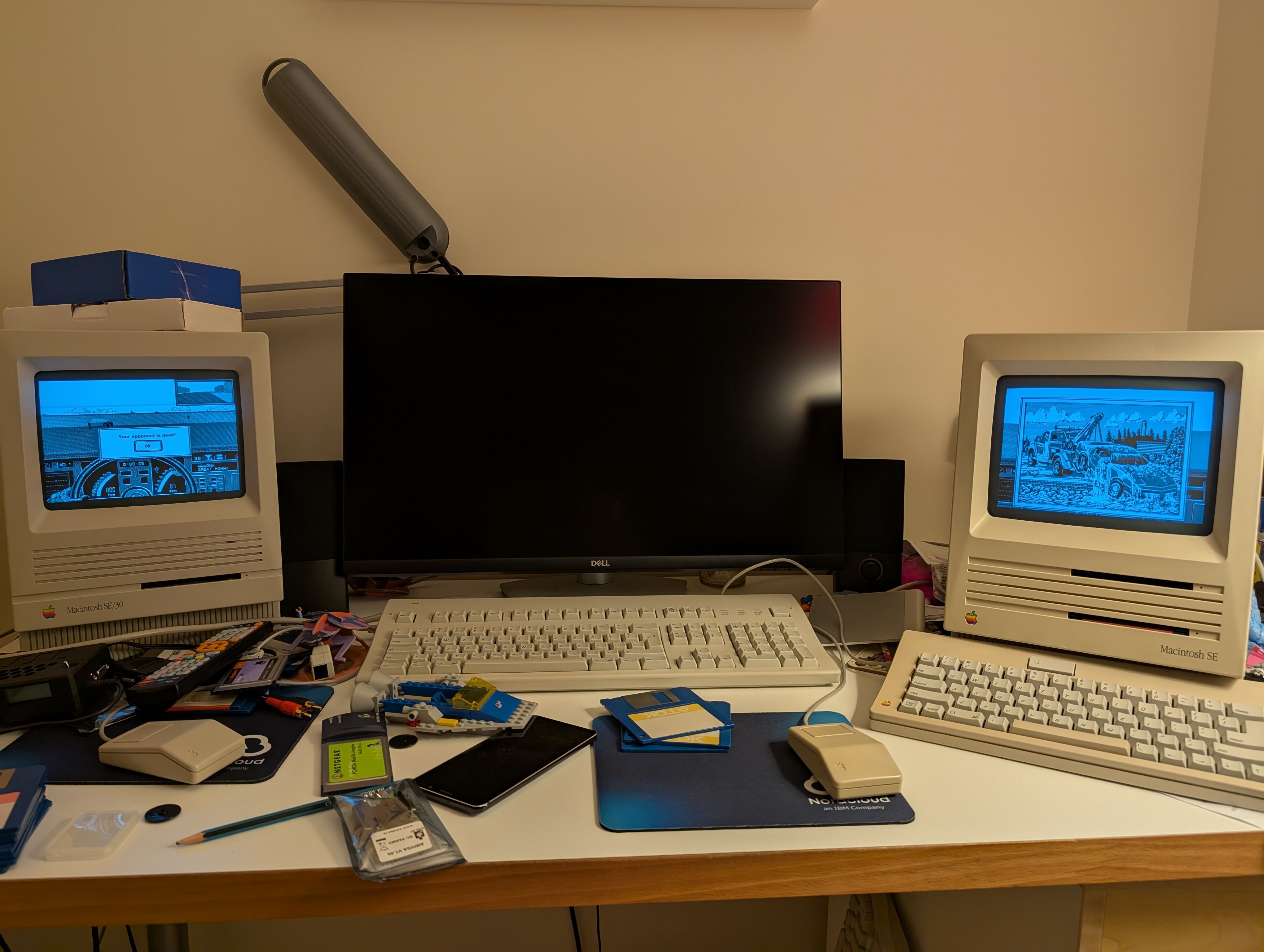

Way ahead of the curve: two players driving around the same 3D open world using a fully restored computer from 1987 :cool:
