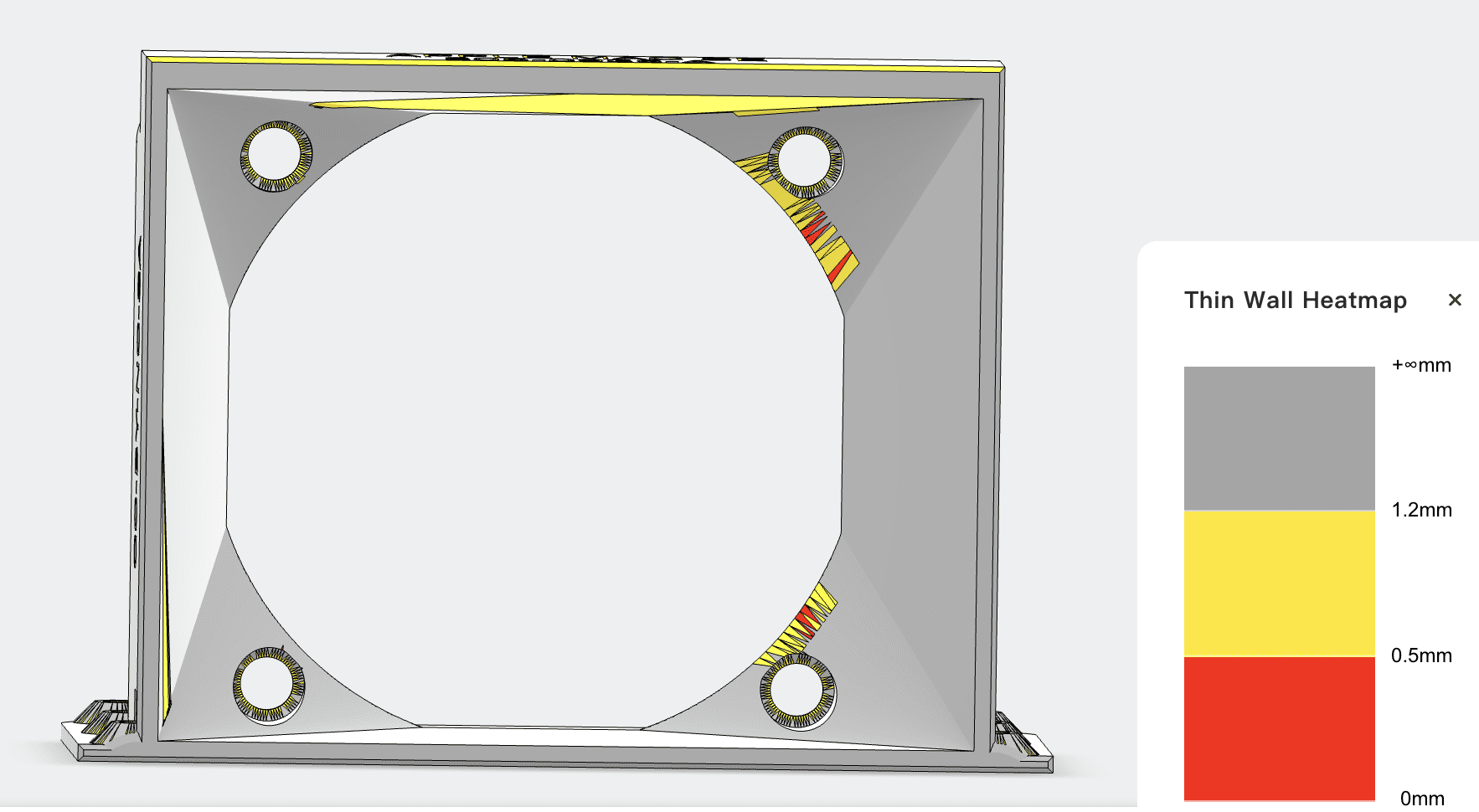

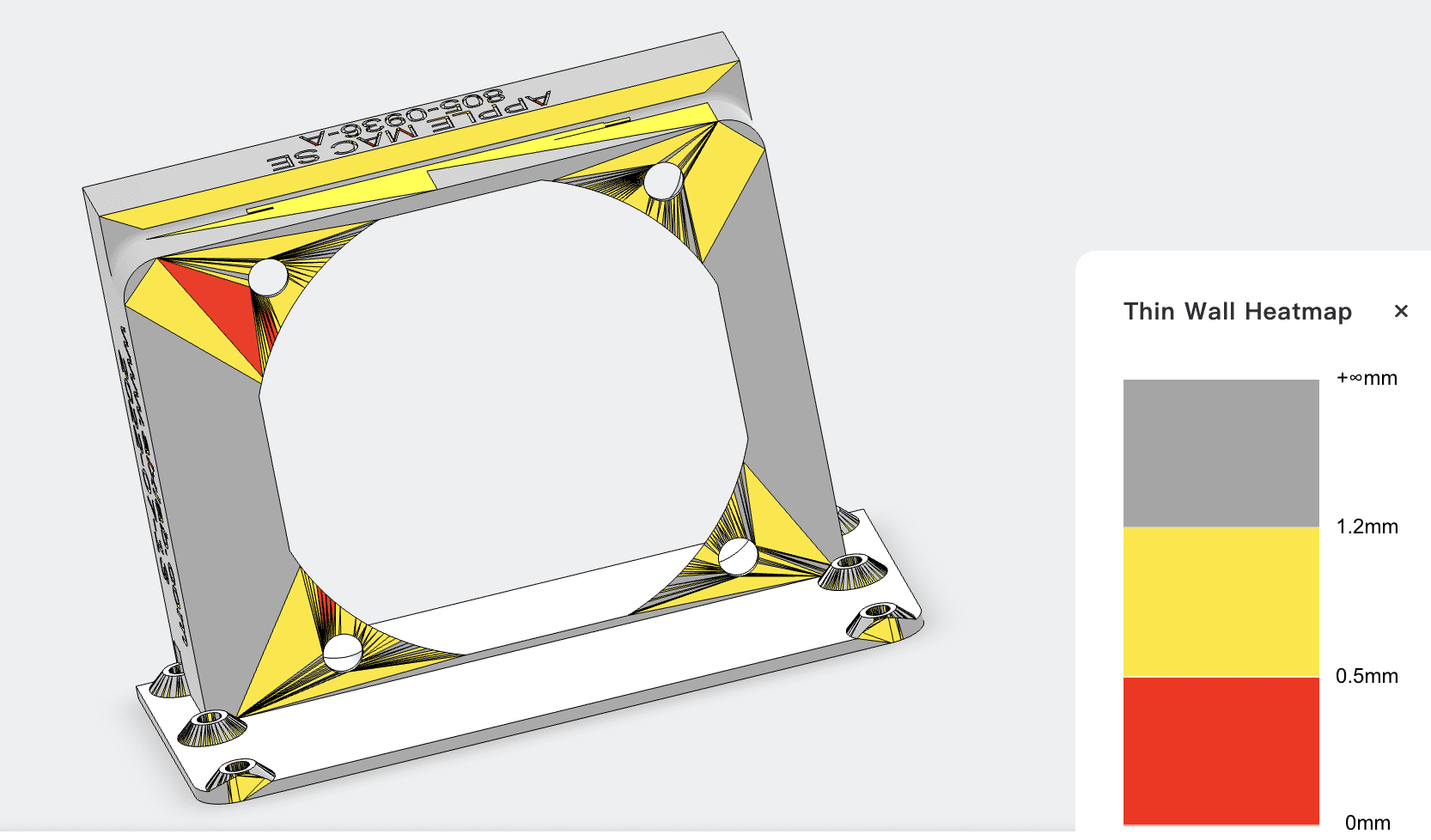

I added your fan bracket to my JLC3DP price quote today, hoping to have in printed in PA12-CF (Carbon Fiber reinforced Nylon), but JLC says some portions of the bracket (as shown in red below) are 0.5mm or less. Do you think that is a non-issue and I can safely just tell them to print it anyway? (It is interesting that only one side is showing red and not the other. Imperfect symmetry?)
Yeah I wouldn't worry about it. It should come out fine. If it doesn't I'll pay for the print.
Personally if I was ordering from JLC3DP I'd try out out the SLS(Nylon). It would end up stronger than FDM PA12-CF but more flexible. Flexibility shouldn't be an issue in this application. It's also cheaper.

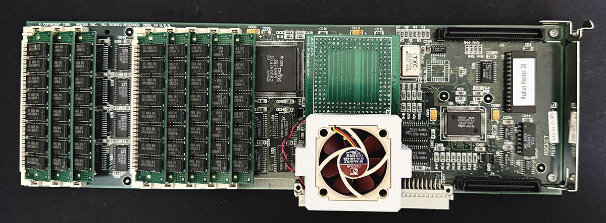

If it’s just the bracket for the fan, wouldn’t PLA work? The temps on the bracket would be minimal and PLA would be strong enough for that application and cheaper. I have drive cases printed out of PLA which do just fine, and they get banged around more than that fan bracket will.
Made a fan bracket for my Rocket (long story) out of PLA and it’s doing fine. The one I made for @JDW (and also myself for a different project) had the clips on the CPU hence went for a CF added filament, but this Rocket application has the clips on PCB so no need. Likewise I would think PLA should do fine for this fan bracket in this thread.

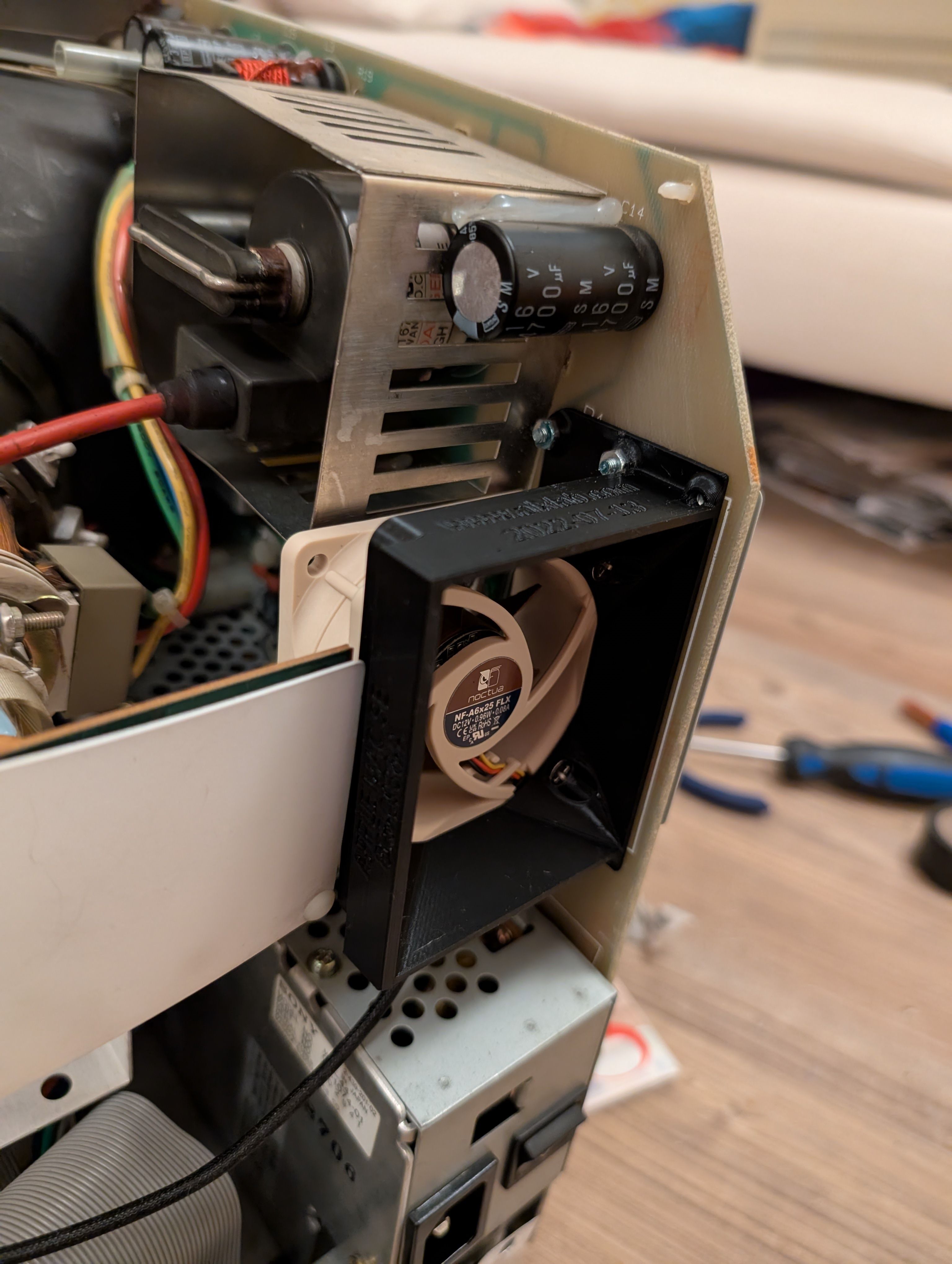

I just want to thank @alxlab for the design and @Trash80toG4 for the suggested improvements. I got one printed by JLCPCB via FDM (PLA) for only £6 delivered - to replace a very loud grinding "squirrel cage" fan in an original two floppy drive SE - and it's perfect!
I couldn't get the nut into position on the first hole you can see above (the cut-out isn't large enough for the nut), so I used a pair of hard drive mounting screws for those first two, then the recycled nuts and bolts from the original fan for the rest, which certainly seems sturdy enough.

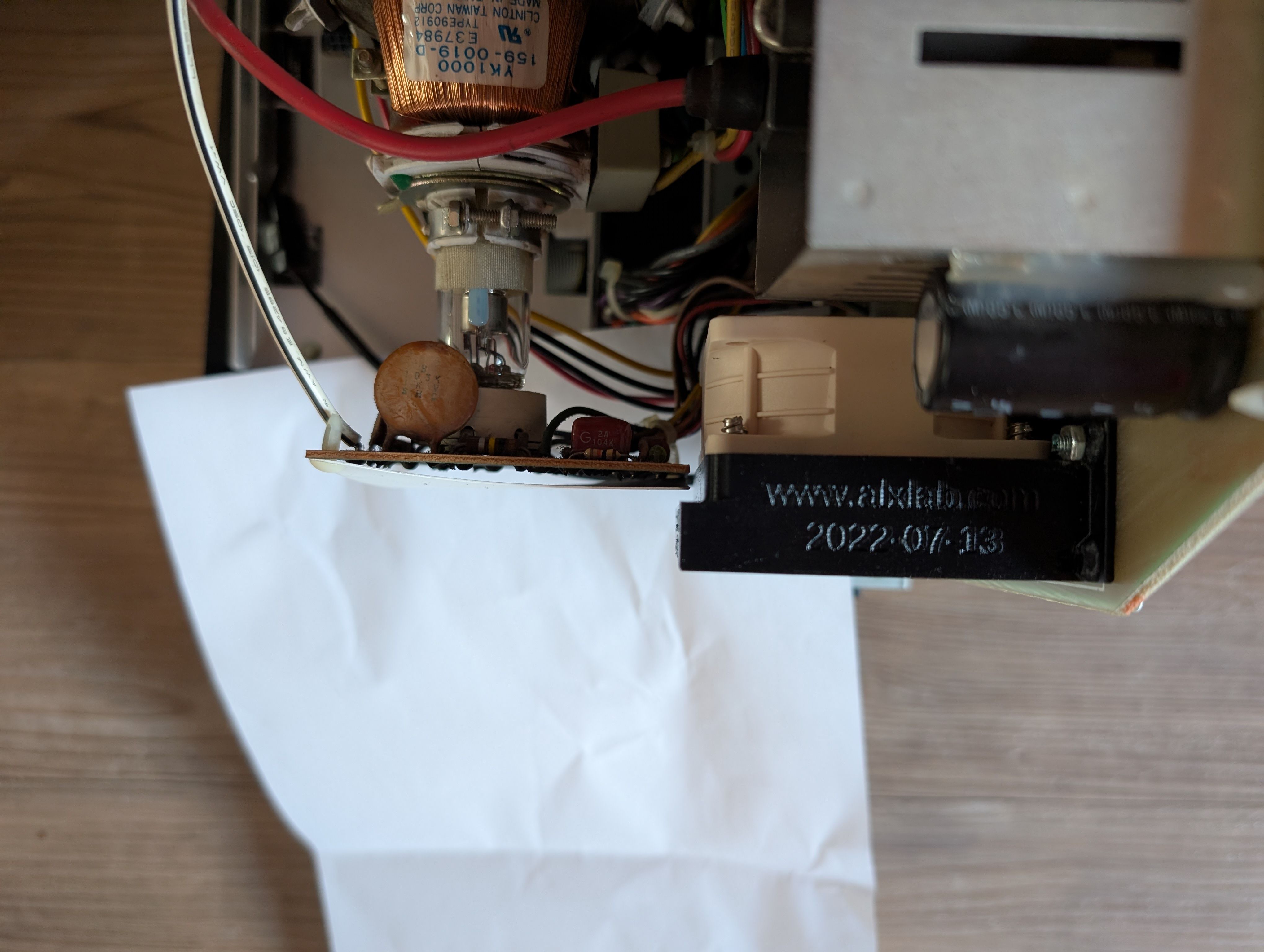

I've been wondering about the clearance with the horizontal video board. When you wiggle the analog board with a 60mm fan installed with this bracket, is there still enough clearance to prevent contact with the horizontal video board?

If you look at the top and bottom edges you'll see they're kind of stepped, with a cutout to improve that clearance. Once the case is on, I don't think there would be any sufficient frame/analog board flex that would disturb the CRT neck board, especially since the back edge of the analog board is pinched between some lugs on the back interior of the case. Next time I have the case open I can take a picture from directly above.
