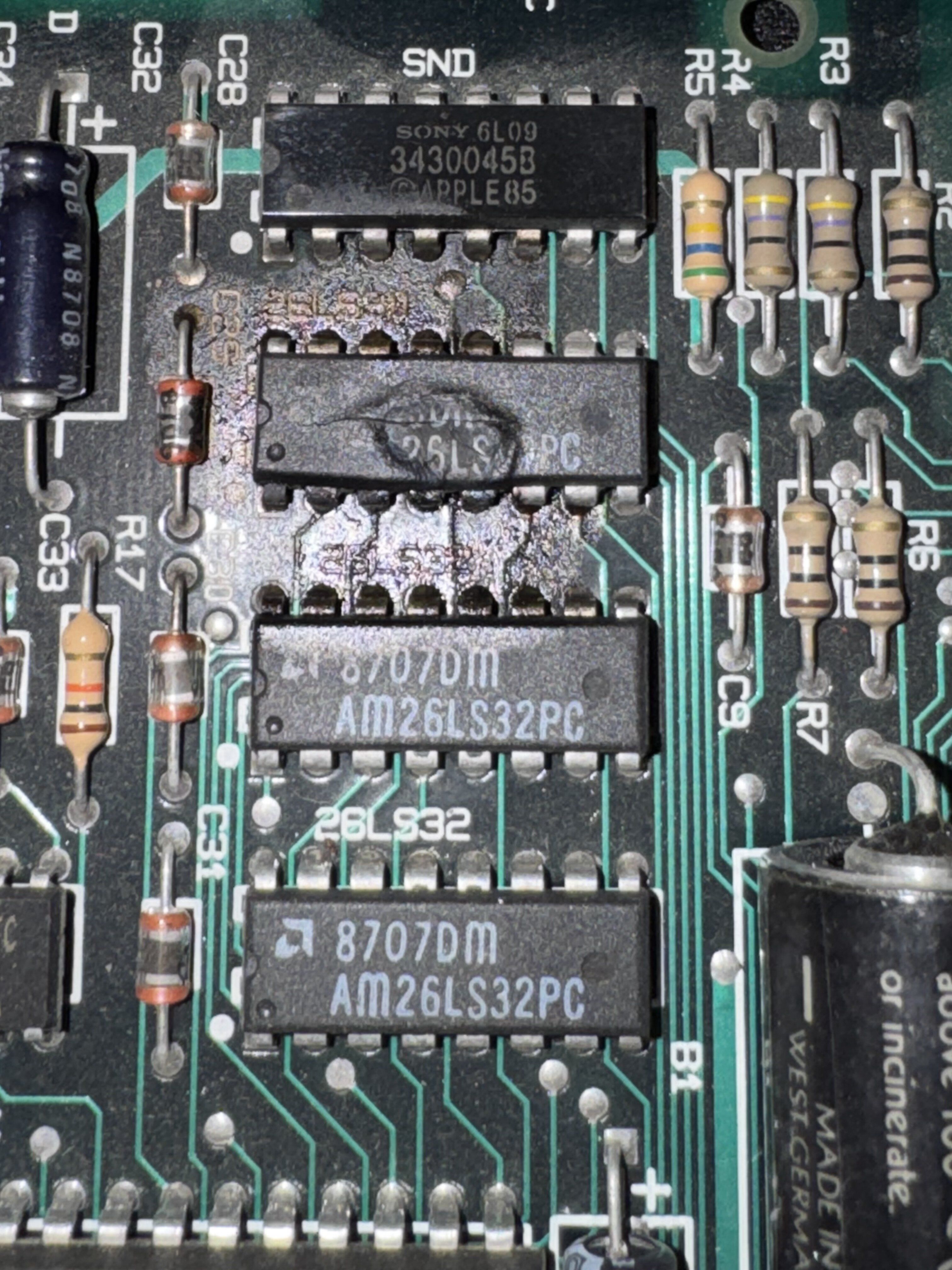

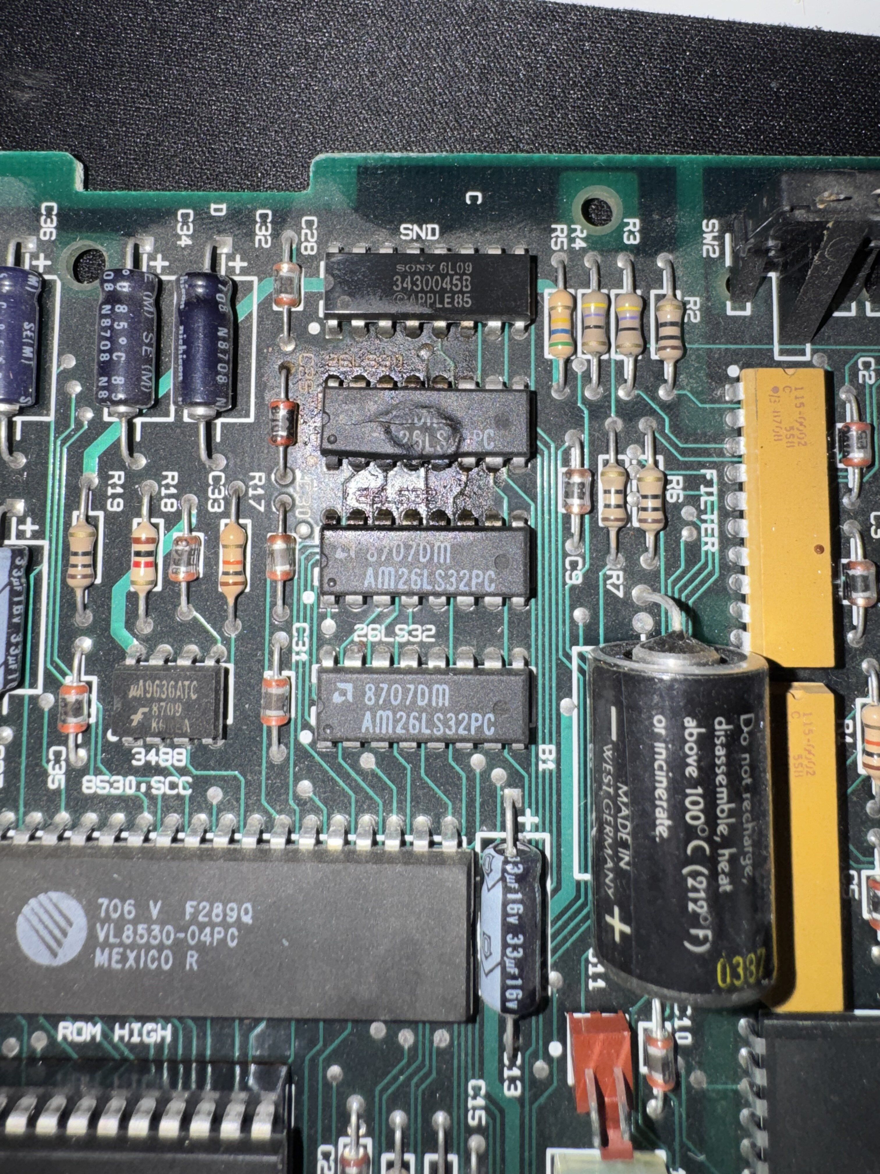

The logic board has a visibly burned IC, which I honestly have never seen before on a classic Mac:
  • It´s one of the three AM26LS32PC (quad differential line receiver)
  • The package itself is clearly thermally damaged and partially melted
  • The surrounding area also shows residue as if the whole chip burned for a few seconds
At the time of the failure, I had a BlueSCSI connected via the DB 25 port. Based on my limited understanding, the AM26LS32PC is involved in handling differential I/O signals, so I’m wondering whether this could be related to the SCSI interface or nearby I/O circuitry.

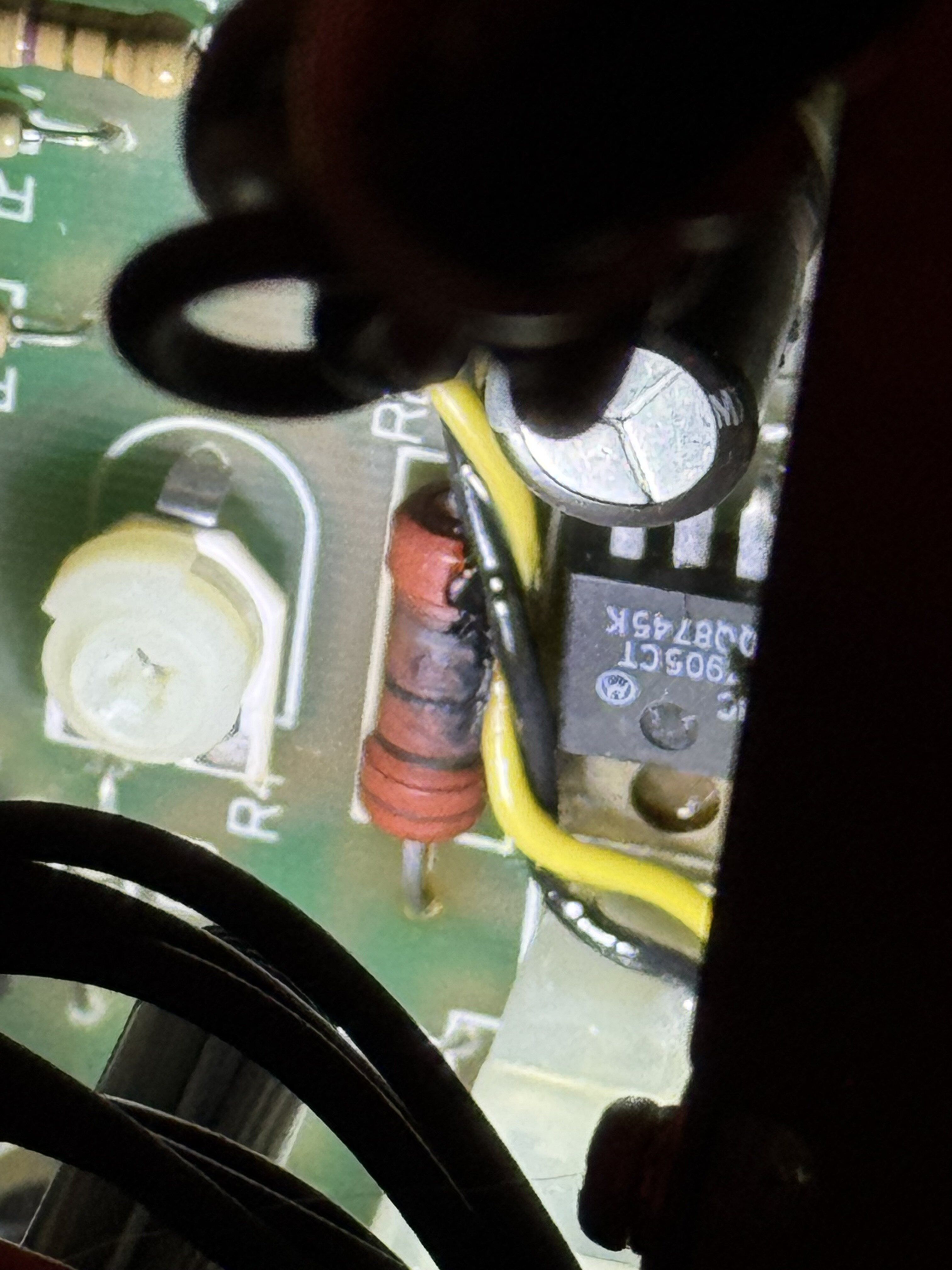

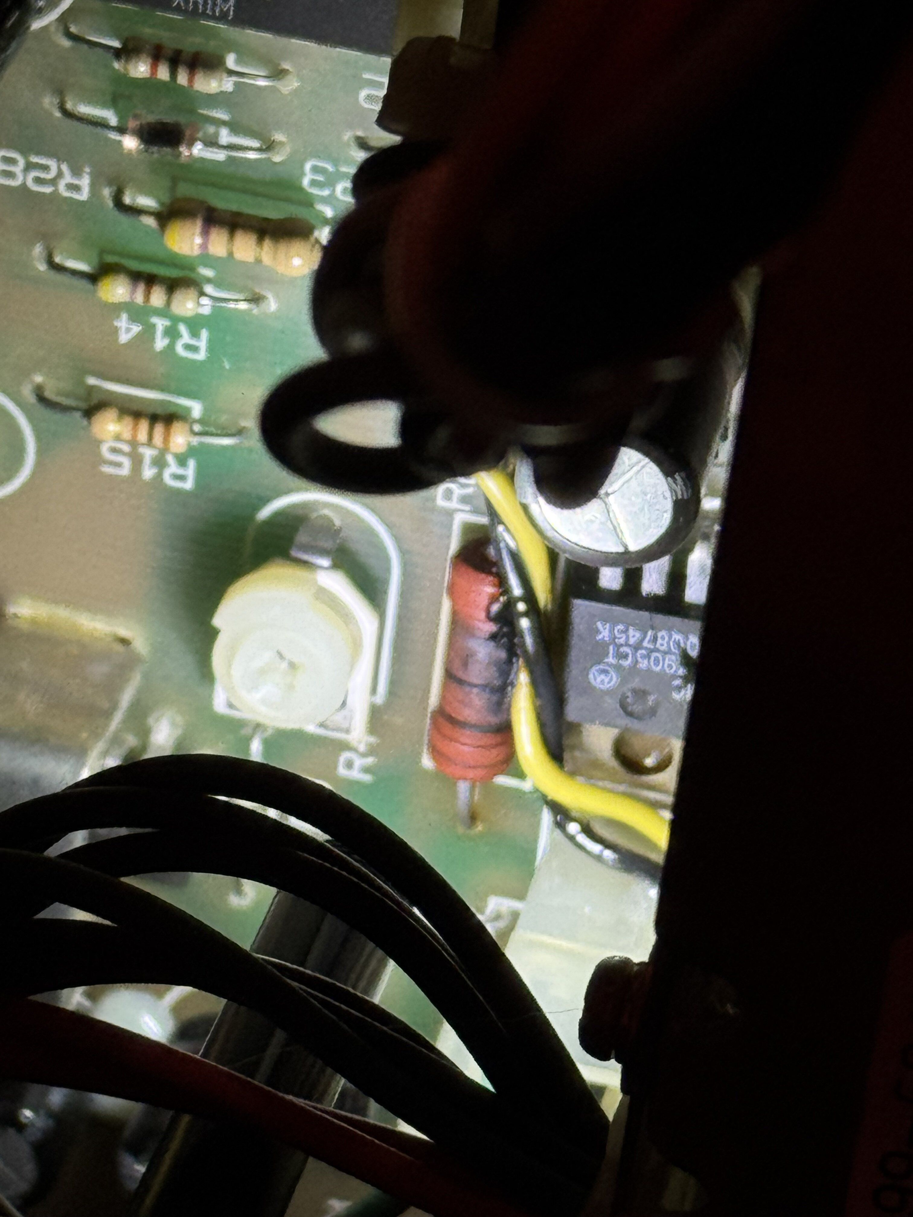

  • Near the PSU connector there is a power resistor with a dark / blackened area that looks like a burn mark.

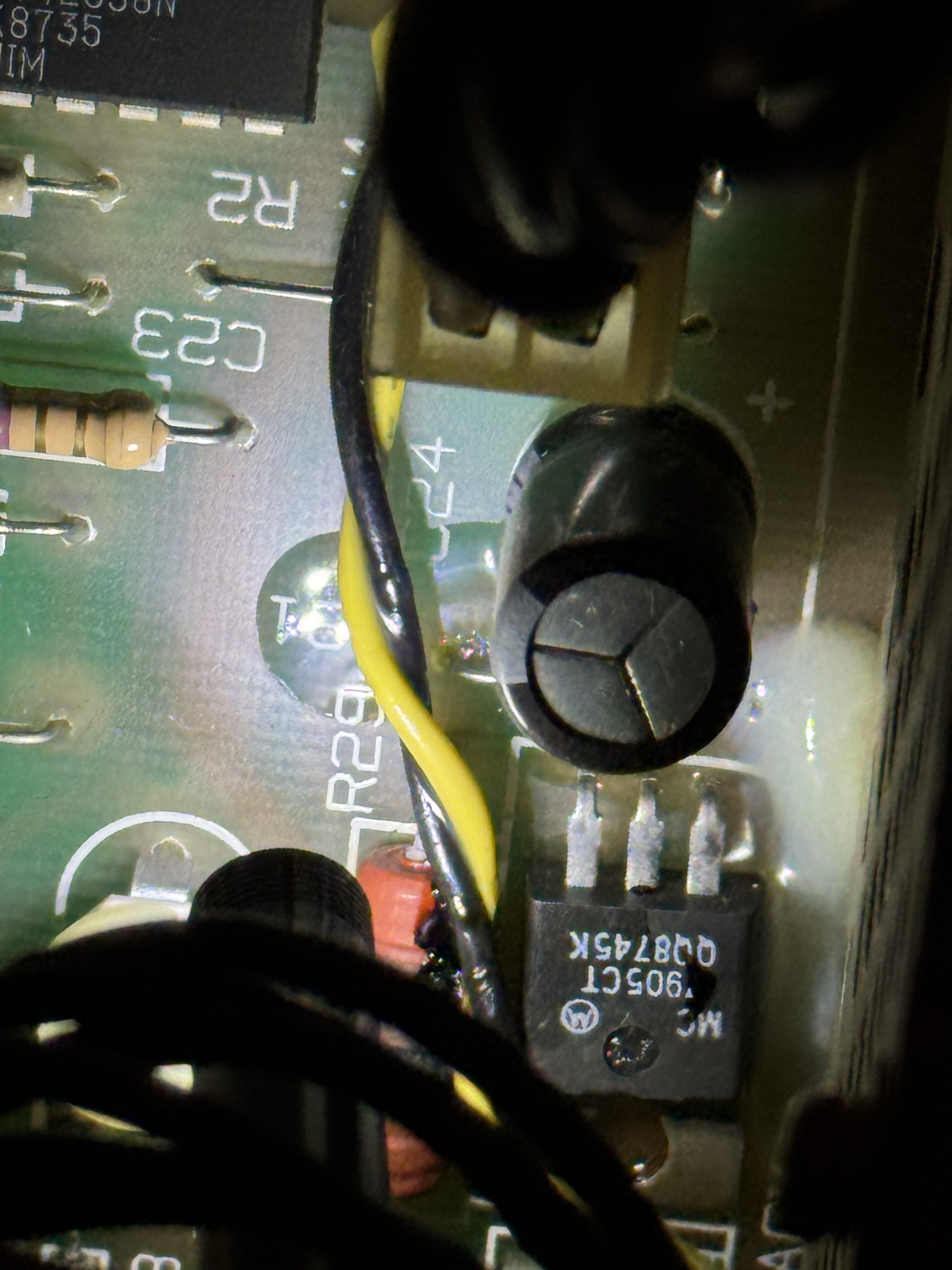

  • Directly above that resistor is a large electrolytic capacitor
  • Next to it there is an area that looks like a glossy "puddle" on the PCB
Due to limited visibility I can’t be 100% certain, but this could very well be electrolyte leakage from the capacitor. But my understanding is that capacitor leakage often appears brownish or glossy rather than clear or dry?
I also used a small AliExpress endoscope to inspect the inside of the PSU. I didn’t notice any obvious damage, although the inspection was limited by visibility and access.

Stop!! That‘s the 26LS30, not 26LS32! It‘s the serial driver IC. You need to get these second hand. Did you overload your serial ports once?
victor.muc
Dec 17, 2025
7
Thanks for the correction!
Regarding the serial ports: a few days before the failure, I briefly connected an Apple RS-422 cable to the printer port while attempting a LocalTalk connection to a PowerBook. It didn’t work (I later learned I was missing the proper LocalTalk adapter), and the cable was connected for only a few minutes. The machine continued to run normally for several days afterward, and when the failure occurred nothing was connected to the serial ports, only the BlueSCSI to the DB-25 port.
I can’t completely rule out that the serial circuitry may have been stressed, but given the delay and the fact that the machine ran fine for hours afterward, I’m also considering an internal fault that finally manifested under load.
victor.muc
Dec 17, 2025
7
Strage.. It should have worked with a cable. You only need the LocalTalk boxes when connecting more than two devices. Maybe your driver IC was already faulty at that time?
Good to know!
If the connection should have worked with just the cable, then a preexisting fault in the IC does seem plausible. What I’m trying to understand is whether a partially failing IC could later progress into a catastrophic failure like this, and whether such a failure could realistically take down the entire machine rather than just the serial port.
