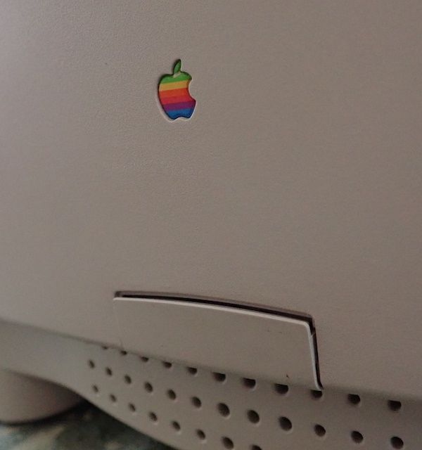

I just picked up a pre-release Color Classic. Notice that it is missing the word "Macintosh" beneath the Apple logo, the words "Color Classic" on the bottom plastic insert, and the QuickTime sticker on the lower right. The plastic has not yellowed.
Looking closer, there are no signs that the text was removed.

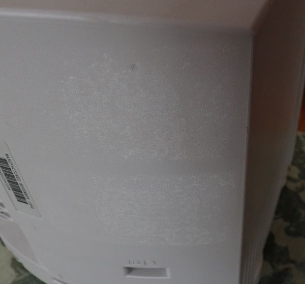

On the back, some large stickers were removed. Could have been "Property of Apple" and "Not FCC certified".

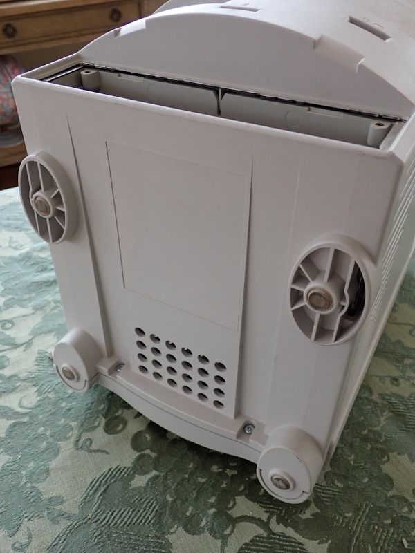

Underneath, the model information is not molded into the plastic.

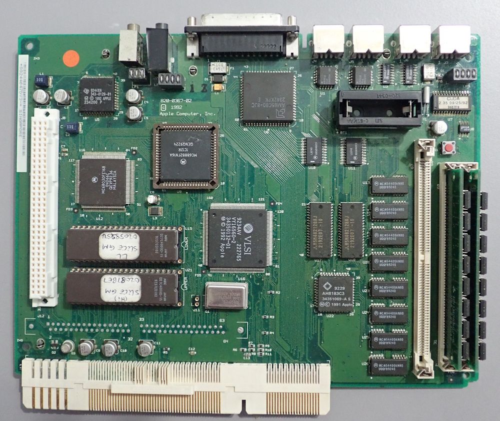

The motherboard is revision 820-0367-02.
The EPROMs have handwritten labels with "slice" (the codename for the Color Classic). Connector J11 is installed for ROM programming, as are transistors Q3 (2N2907) and Q2. However, J12 (ROM SIMM slot) is not installed.

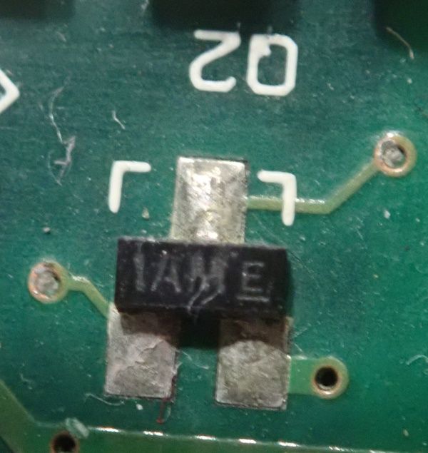

Here are the markings on Q2

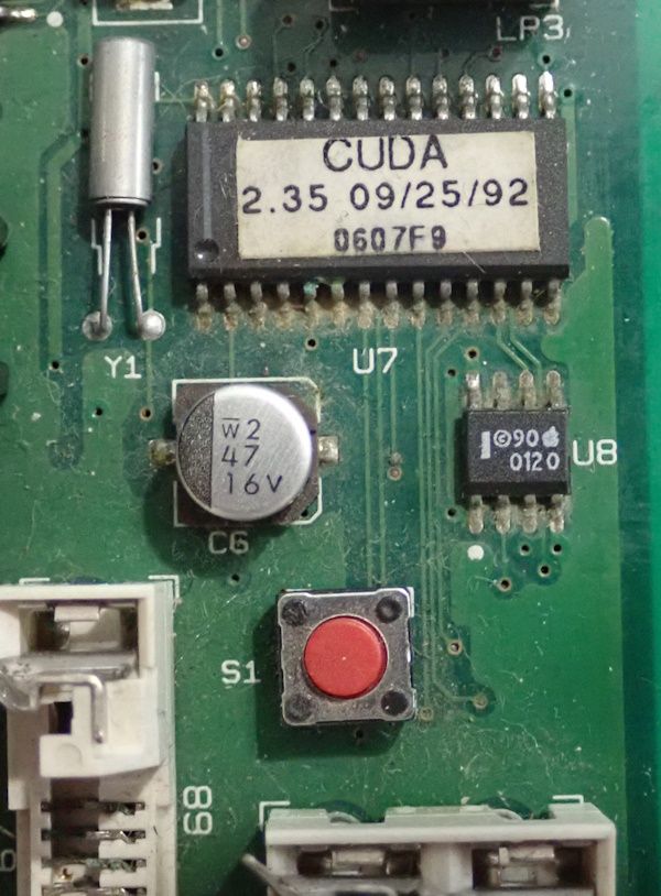

The CUDEA is labeled v2.35 09/25/92 0607F9. CUDA reset S1 is installed.
There has been significant leakage on the CUDA as well as the first several pins on the video memory slot (lower left). I cleaned all of this up during recapping.

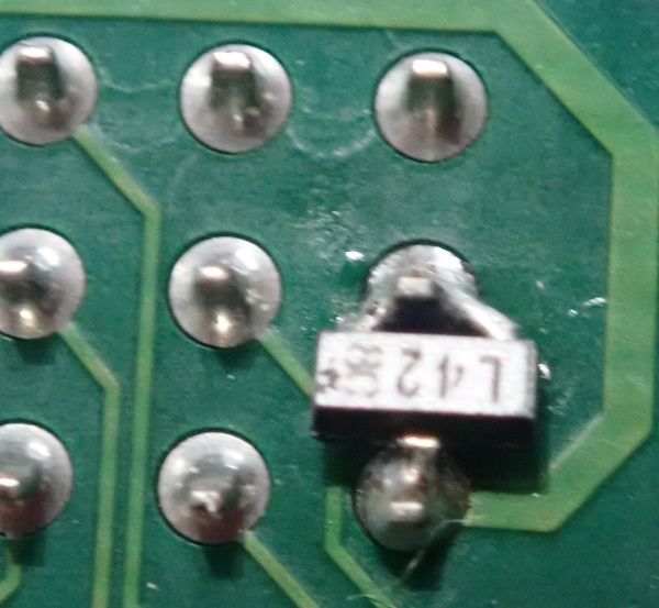

There is an 'oops' component on the back of the PDS slot.
I recapped the motherboard and hand cleaned it. I didn't want to lose labels in the ultrasonic cleaner. The motherboard works. Unfortunately, the analog board does not work -- despite looking very clean and low mileage.

What a cool find! Congrats, and thanks for sharing! It's cool to see the extra components mounted for in-system ROM flashing.
I have a theory about the "oops" component on the bottom of the board. Based on the L42 marking, I think it's a BAT54A pair of Schottky diodes. Looking at the close-up picture, I think it's across pins C32 and B32 of the PDS connector, which are -5V and GND respectively.
I also notice your board differs from a stock CC board in that it doesn't have diode D2 (it would be between the sound chip U5 and the 68030). D2 would be a Schottky diode across -5V and GND. So I think that's the bodge they did before they added it on the top side of the board.
