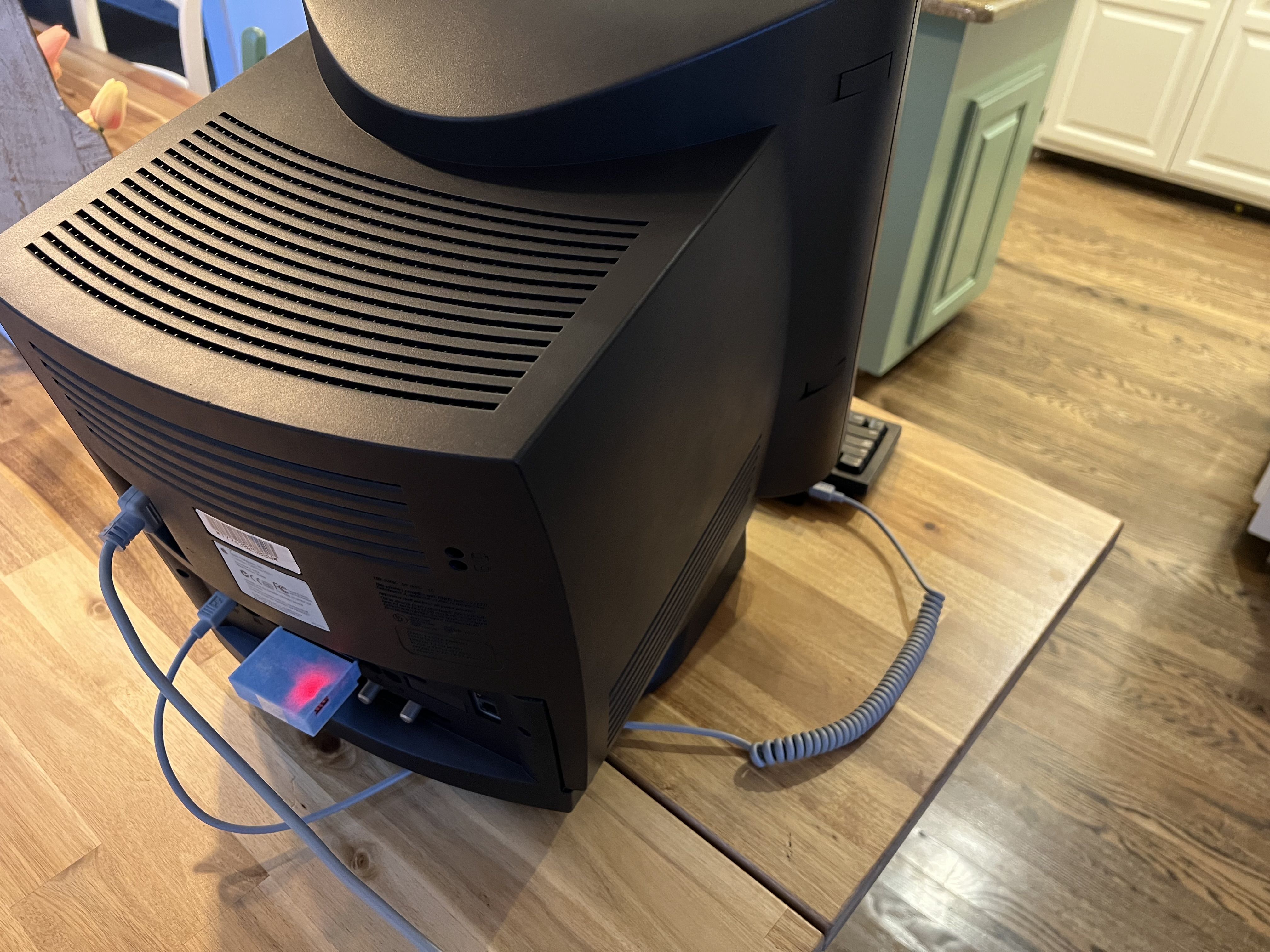

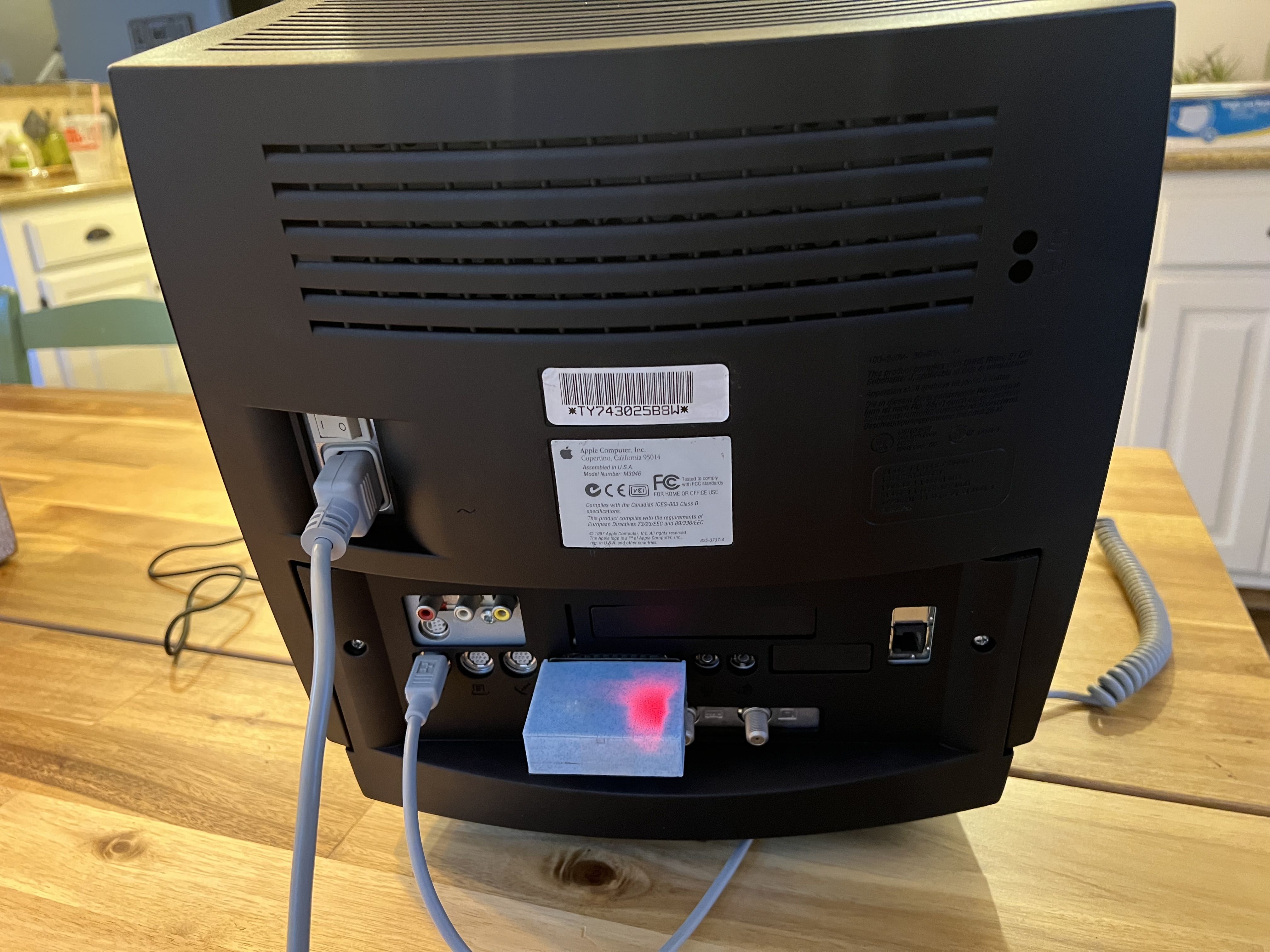

So, I decided to keep the quirky platinum doors from the Mac TV to keep it original. And I was reading up on the black Mac SE/30 and realized that the real life version was platinum, and it was only black when they recreated it for the Watchmen movie. So I think I'm going to leave my spare SE case platinum for now.
However, I realize I had a Powermac 5400 that I messed up on one of my first attempts at retrobrighting (NEVER use the plastic wrap technique in the sun! However I do use the plastic wrap technique every time with my UC light box). It was splotchy and looked pretty bad. I also have always wanted one of those black Director editions of the 5400.
iu
So, I bought a couple cans of the vinyl and carpet paint, disassembled it, popped out the Apple logo, taped off a few areas I didn't want to pain (the IR sensor and the LED in the front panel). I removed the stickers for the model number and the Apple sticker on the back. Hoping they'll reapply well.
I'll post pictures when it's dried and I've reassembled. I can reuse the keyboard and mouse from the Mac TV, although I'd love to have a second set. I can make my own mouse, but the keyboard will be difficult because of the letter on the keys and keyboard itself.

Wow! It's hard to believe this is painted...
Was this the same type of paint you used on the mouse? 😮
Yes, I used the Duplicolor Flat Black Vinyl and Carpet paint from the auto parts store again. I picked the vinyl paint because it purportedly is a bit flexible and would be better for the cables. But it seemed to do really well on the hard plastics and the finish is a very close match to the original black 68k / PPC Macs.

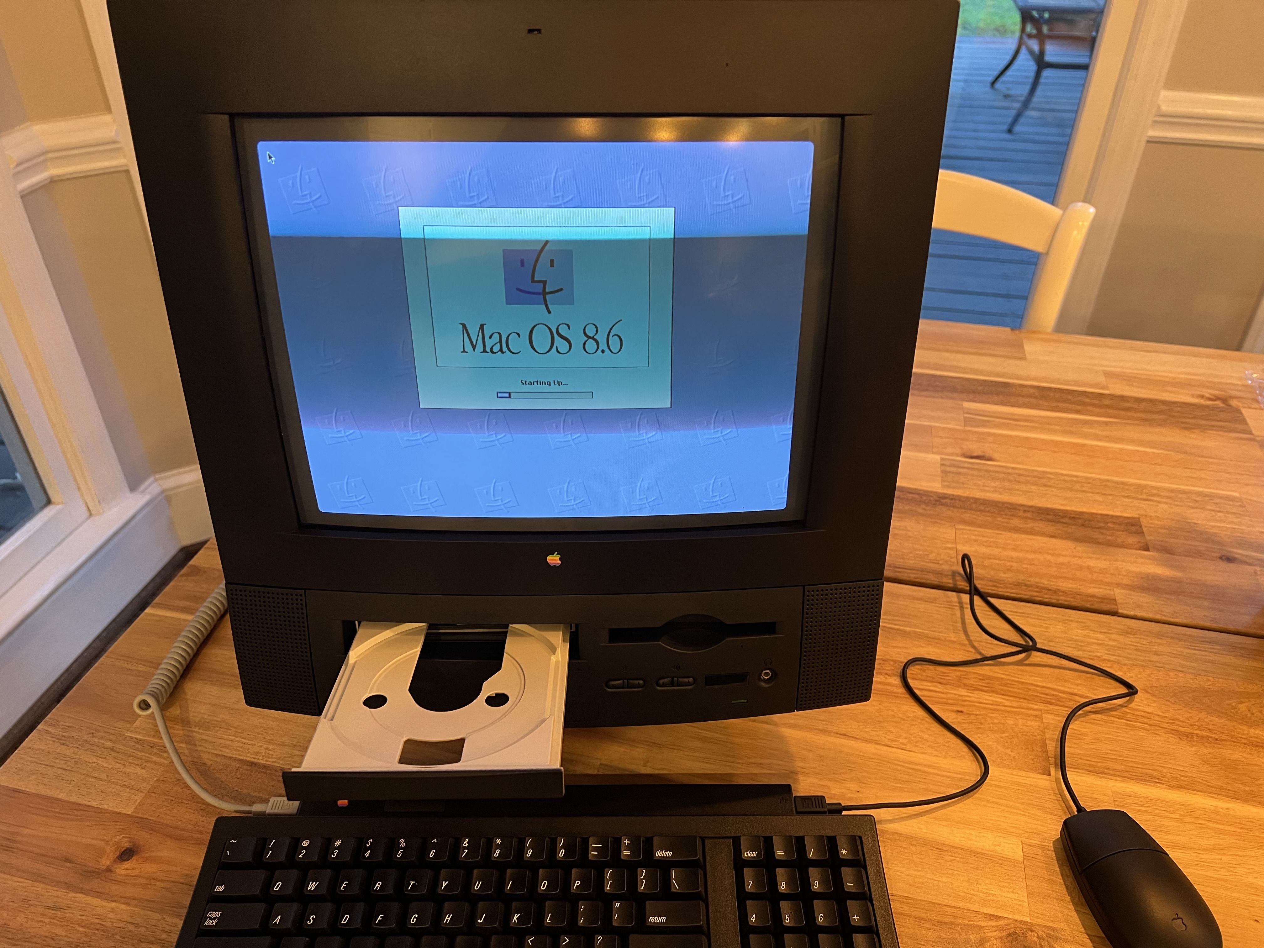

The funny part is I feel like that matches the beige CD cartridge door cover of the MacTV, so it kind of makes me wish I had kept the CD tray front platinum. Worst case I can swap out the CD-ROM from another machine.
I have an HDMI to COAX box, so I can stream all the Star Trek TNG (I watched that almost every night on the kitchen TV after getting home from work at Target).
