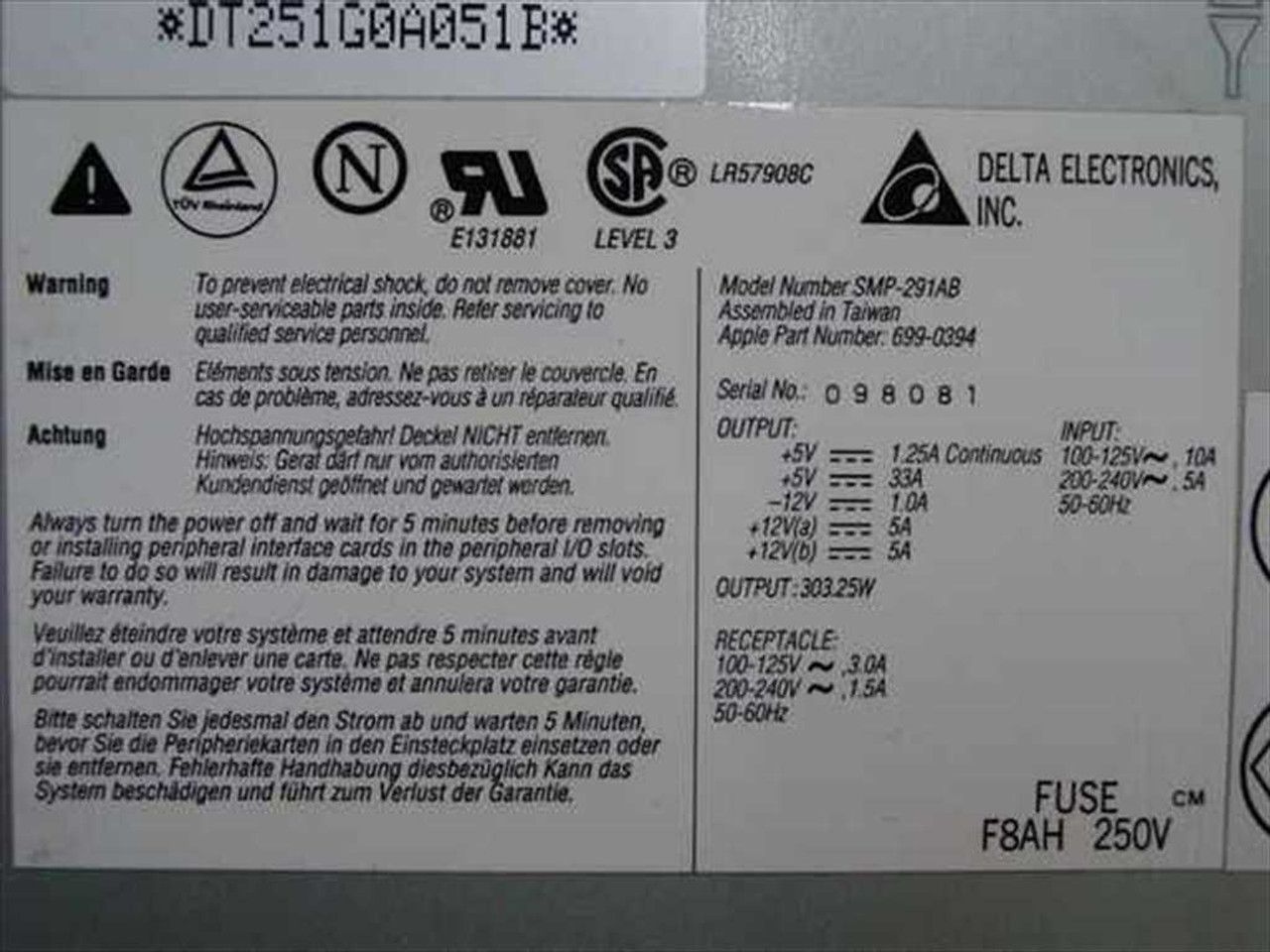

These are the stock ratings. Most PSUs today have a weaker 3.3V and 5V (around 20A) and a very strong 12V. Typically the -12V is 0.3A
Reactions: David Cook
