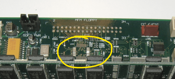

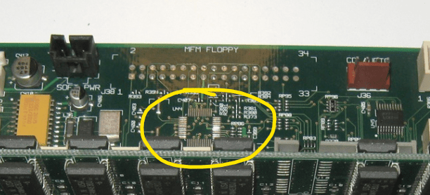

Has anyone here ever encountered a PC floppy drive on a Macintosh clone? The Tarzana motherboard design did make accommodations for a MFM style floppy drive, but I've yet to find photos of a board with those components installed.
Anyone seen one?

Technote for the LPX-40 motherboard
I don't think this was ever used on a shipping product. It would have greatly limited disk compatibility which probably would have not been seen in a positive light.
That being said, browsing everymac shows about a billion Mac Clones where the only graphic evidence of existence is a tiny thumbnail from the 90s.
There's probably a ton of clones that were scrapped because they looked like boring PC stuff.
The Starmax that shipped had a bezel without a cutout for the eject button.
Even the various prototype CHRP Macs seemed to use a Mac/GCR floppy.

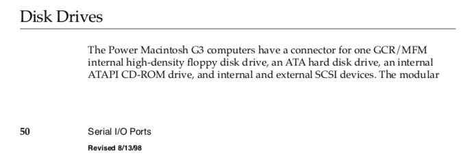

Supposedly the Gossamer G3 logic board (as seen on the 'beige' G3s) also has a header for a PC-style MFM floppy drive... under the Mac floppy socket. I haven't confirmed this though, nor have I seen any pictures or evidence that it's ever been tested.

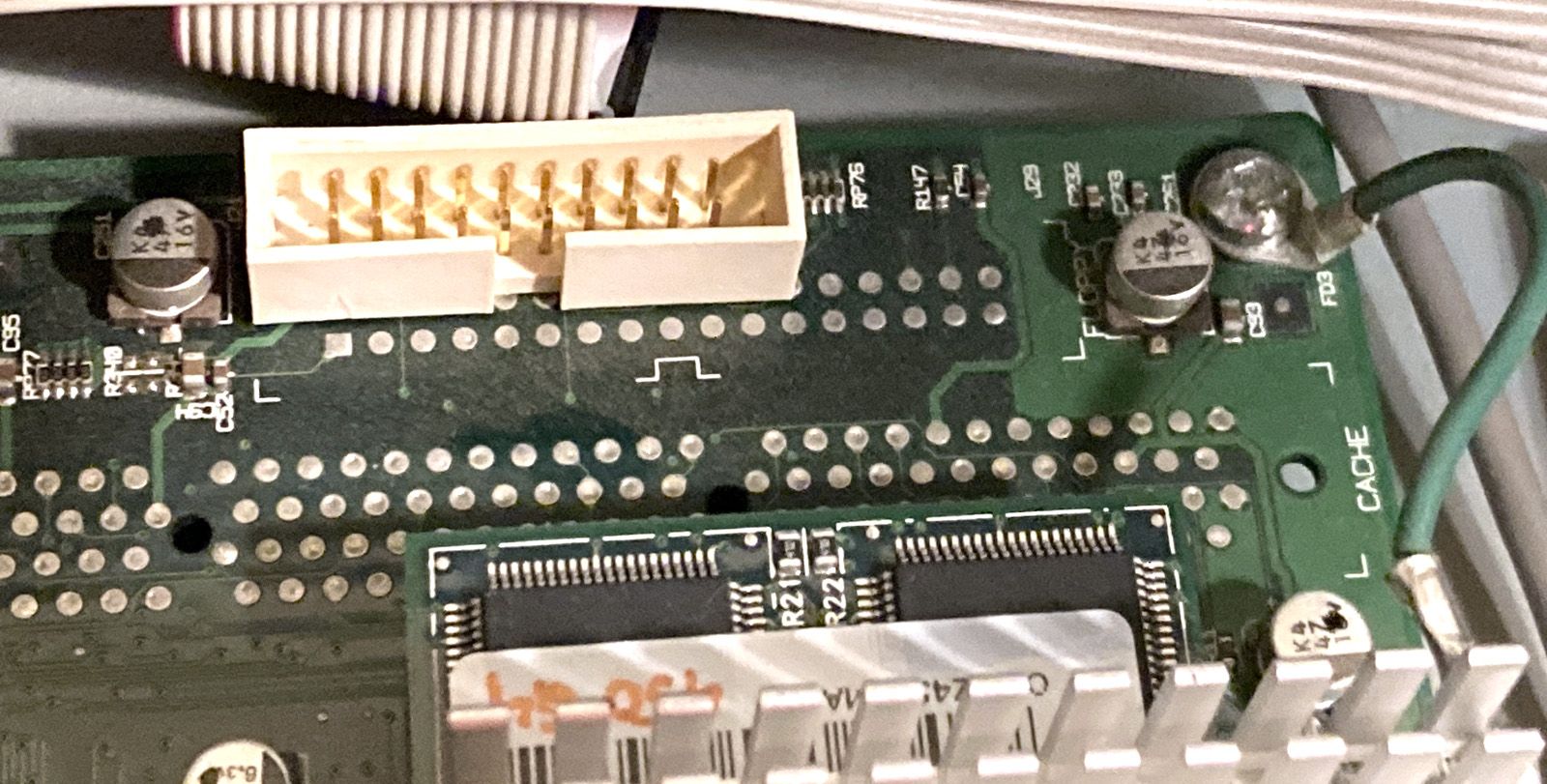

I desoldered the Mac floppy port and fitted a PC floppy port onto my Beige G3. However I can't get a PC drive to work – it's not detected and doesn't do anything.
