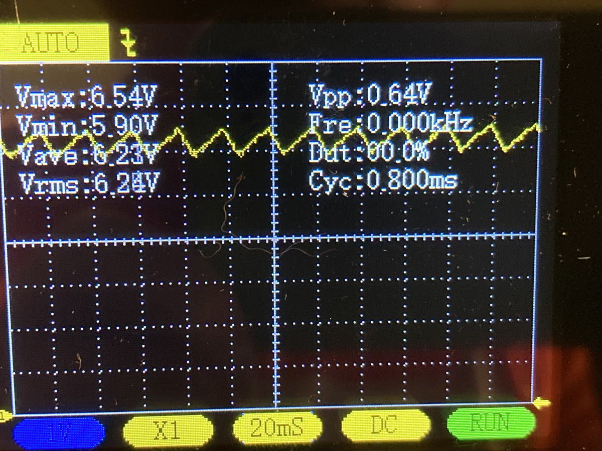

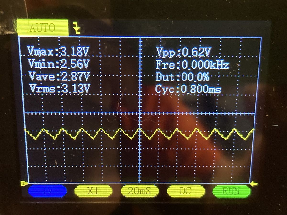

This is pin 5, which some claim is 5-12V input. I am going to call it 0-Vmax input, but a typical PWM fan needs 25% to maintain minimum speed, so the 3V I am getting with a slight waveform is about correct for when the computer is idling.
And as I run a CPU benchmark, things heat up, thus requiring the fans/pumps to accelerate...

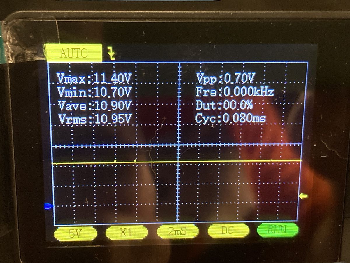

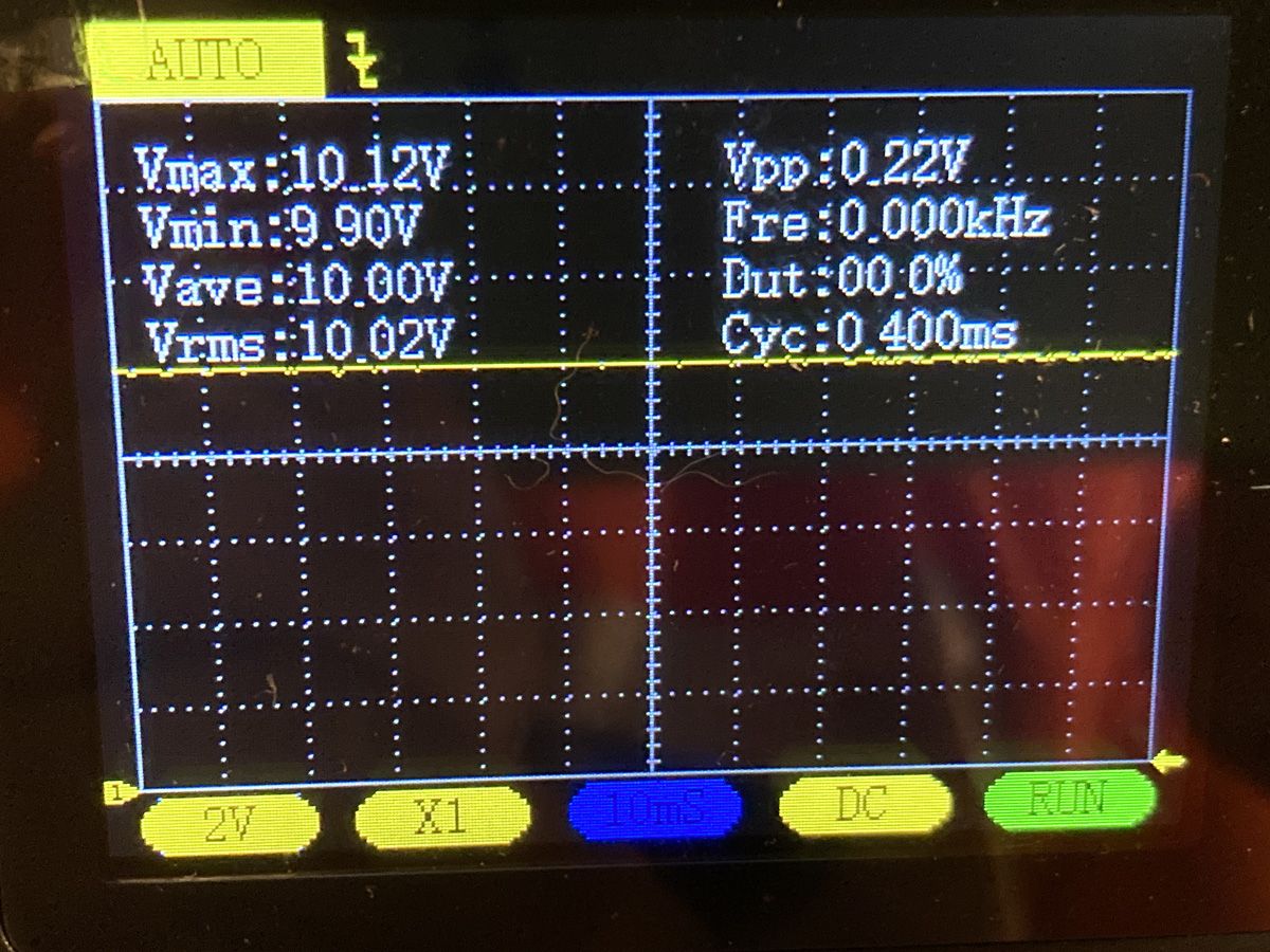

And at max heat/speed I get this... but when read with a multimeter, I get 11.8V
Pin 1 people seem to have labelled as PWM, but it seems to just be Vmax to me, I saw no waveform whatsoever at any reading. Pretty much the same 11.8V I saw on the multimeter.

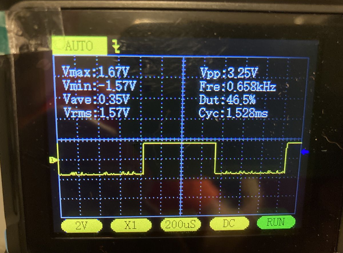

Pin 3 is tach output, 3.3Vpp and adjusting the screen to your desired preference was rather easy.
