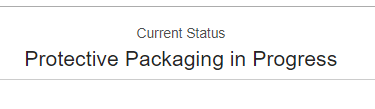

It arrived at the buyee warehouse earlier in the week and I promptly ordered an additional protective packaging. It's been sitting in that state for about 3 days now.
I'm kinda regretting not requesting a photo of its status before ordering the repackaging.... rookie mistake I guess?

I've read that thread already @This Does Not Compute and seen your video , neat stuff and so satisfyingly lucky.
So the way it now has gone:
-Buyee received the package locally
-I ordered a repackaging
-I waited 4 days; they just noticed me an hour ago that it was done
-The option of requesting a photo is now again available, but if I request it, I imagine they'll have to undo all their work, forcing me to repay it if I want it back. So off we go with the shipping then.
How I should have done it:
-Buyee receives it locally
-I request a photo
-I request a repackaging
-I request the shipping
You guys understand the issue right? They might have done a perfect repackaging job (of that, I have no doubt) around a broken machine, broken in the transit while in Japan, from seller to buyee. Since I have not done a photo request at the critical time after it arrived at buyee, I don't know either way.
254
387
When you originally purchased the machine, which "plan" did you pick? The default is the "standard plan" which includes shipping insurance and product inspection (when the item arrives at Buyee's warehouse). If you picked that, or the insurance-only plan, then if the machine is damaged when it gets to you -- regardless of when the damage happened -- you'll get a refund.

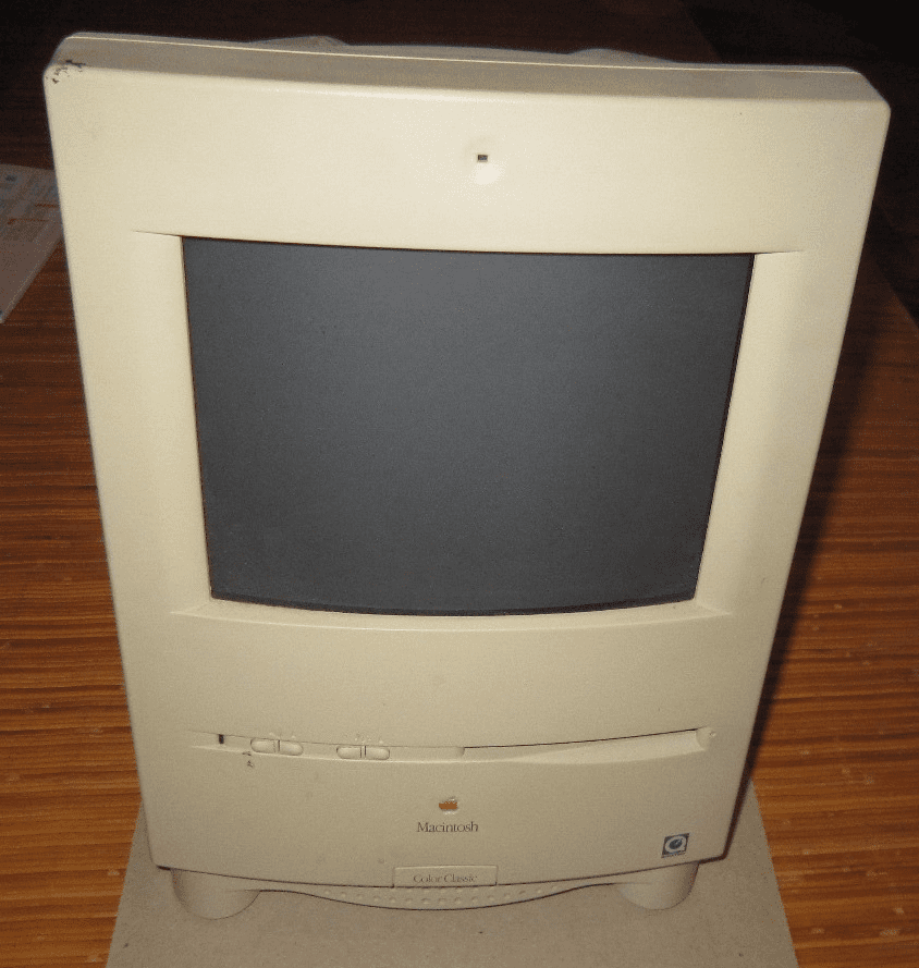

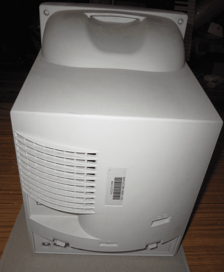

Well, despite splurging extra for a repackaging at buyee, here's the status of the machine:
It got damaged on the left side (when looking at it from a user vantage point).
Auction photo:
When it got here:
The front plate has shifted to the right side (point of view of a user), but only near the top of the machine.
Before anyone has a chance of asking (Hi @Ron's Computer Videos ! 😅), I promptly removed the battery, no apparent damage. No leakage from the SMD caps (I'll order a new set pronto, ofc). There's only a light pretty even coat of dust everywhereas is normal.
Tests done so far:
1) plug in power chord, flick switch, push power on button on a keyboard - get a burst of power, see a blink of the green LED in the front, then shuts off
2) wait 3 hours with the power cable plugged in, let the switch be on and power it back with the keyboard then, I got a chime and a sustained sign of life and an image on the CRT!
3) terrible sounds from the internal hard drive (big woop!)
The image is dim, not very focused, but since the damage is scary looking in the case, I suspect some fine and not so fine tuning have to be done on the CRT. (image and boot sequence on the next post)
