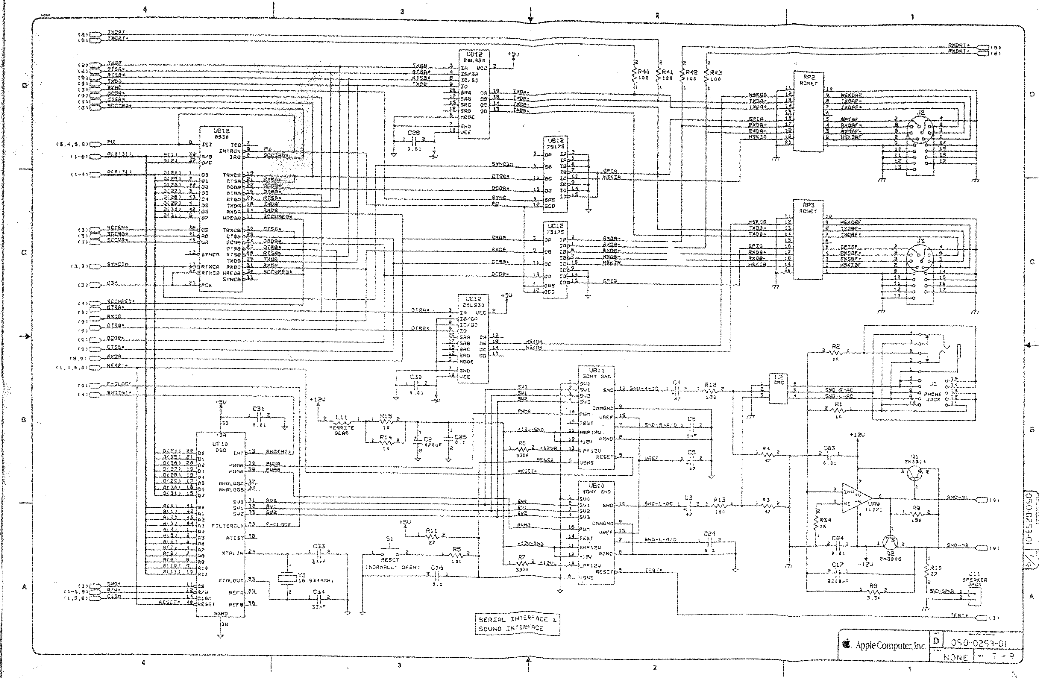

How do I test these transistors? The sound chip is UE10, correct? This is what I have that I think is the most relevant schematic page for the SE/30

Q1 and Q2 form an emitter-follower output stage.
Check for the the +12/-12 supplies at each collector.
If the upper half of the output is distorted, replace Q1.
If the lower half is distorted, replace Q2.
Be aware, they are different parts.
How do you propose to check for distortion? Send a pure sustained sine wave through the Sound Driver's 4-tone synth and check the output at each transitor on a scope, and look for sinus impurities?

A sine wave test would work.
Q1 and Q2 have their emitters and bases tied together, so the output is shared.
A failed transistor will be obvious; You'll be missing the upper or lower half of the output.
I'd replace both as a matter of course. They're cheap and used throughout many logic boards.
