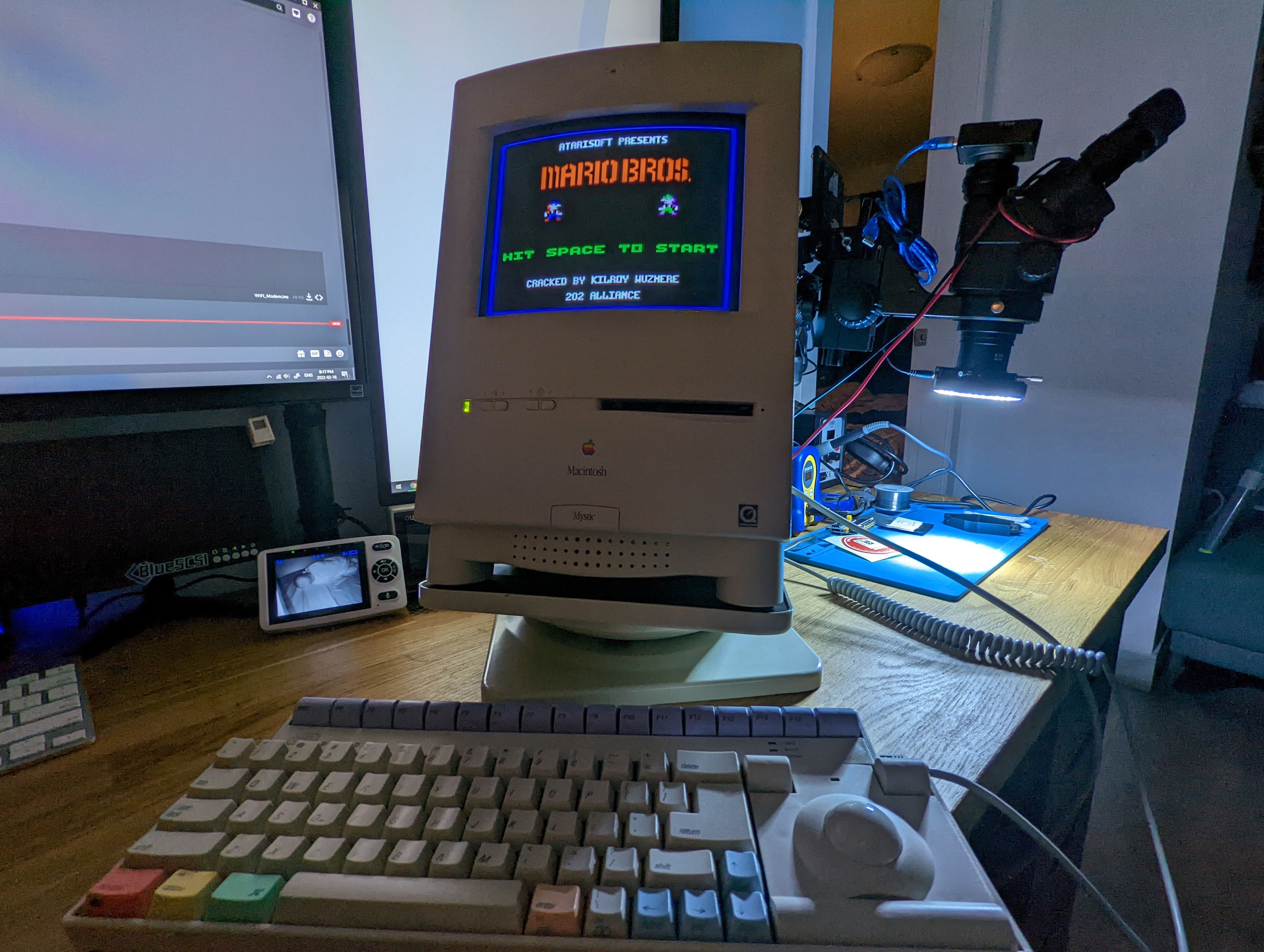

IIE PDS card has too much proprietary logic to replicate as-is. Maybe someday the herculean task of running another machine like Pi or Mister through PDS? At that point the feeling of authenticity gets diluted.

48.8mhz and running fine, I guess the IIE card isn't dependent on the logic boards timings as the IIE card contains it's own clock, it really is another computer in itself. Glad running this through the PDS is good to go, many users who build a Mystic may already have or want IIE card for both having the slowest (IIE) and fastest (🔥Spicy Mystic🔥) machine AIO :ROFLMAO:
Great result Drake!
Unfortunately I don't have IIe cards so I can't try them😉 I have a lot of Apple IIs, so I didn't really want them, but I should get them. If I have a chance❣️

The logic on the Apple IIe card, is the Mega II chip and the IWM. That's literally it. The rest is 74LS series logic, a 65C02 CPU, a PROM and some DRAM. The Mega II is the Apple II on a chip. The schematics are available for a IIe, so...nothing really impossible - would just take someone knowledgeable to lay out the IIe/Mega II into an FPGA.
