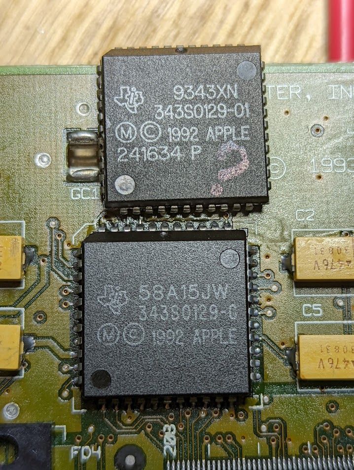

I just purchased a couple 343S0129-01 for my "Takky" color classic as the one logic board I was using had a bad one too.
swapping a good chip in was the only fix as well, unfortunately as years go on this will begin to cause some headaches unless there is a replacement option :(
Good news in my case is that the 5200 and 6500 use the same one, aside from the -01 or -C identifier.
