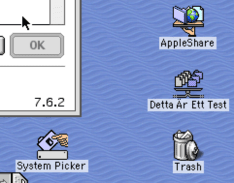

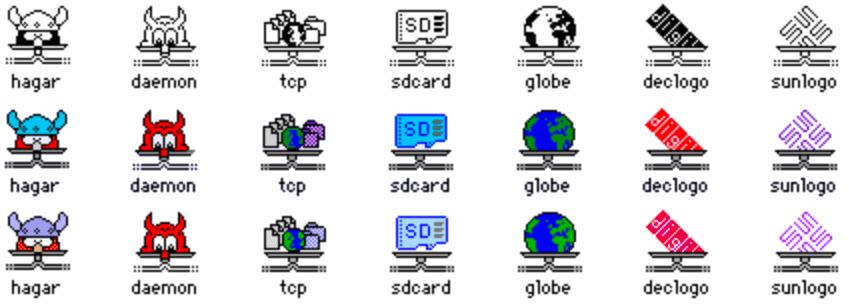

As always amazing work! Super interested in the "friendly new color volume icons", looks like there are several options (each with 1-bit, 8-bit, 16-bit versions)? How will you select which is used?
...and would it be possible to substitute your own icons for one of the sets?

The OS will select the correct version based on the set monitor color depth. You can set your own custom icon for an AFP server just like you do with a folder, by pasting in an icon in the server's "Get Info..." window.
Also, as the code stands, its impossible to see the color "tcp" icon since its not an available setting for "legacy icon". @rdmark

The bit depth version being selected by monitor color depth makes sense but which one of the 7 sets of icons will be used by default? hagar, daemon, tcp, sdcard, globe, declogo, sunlogo? I assume you can somehow configure this for a netaatalk installation?
On pasting an icon in Get Info is that possible to do for multiple bit depths?
Set legacy icon in afp.conf to set the one you want. IF you want a custom icon with multiple bit depths, you can create a file with them and name it "Icon\r" and place it in the server's route directory.

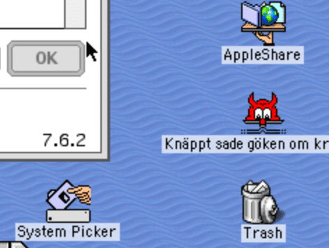

in later revisions I slightly redrew and renamed tcp → fileserver
see the screenshot what it looks like now
the background is: netatalk 2.x was able to distinguish between TCP and AppleTalk connections when mounting a volume, and served a different icon depending on the transport layer
typically, the TCP connection icon had a little globe as part of the motif; you can see an example of this in the upper part of the screenshot
however, in netatalk 4.x the architecture has changed and we cannot tell the transport layer when mounting a volume; therefore, having an icon named 'tcp' no longer made logical sense, so I removed the globe and added an extra folder instead
@NJRoadfan knows this architecture very well since he was the one who grafted AppleTalk back onto netatalk :)
