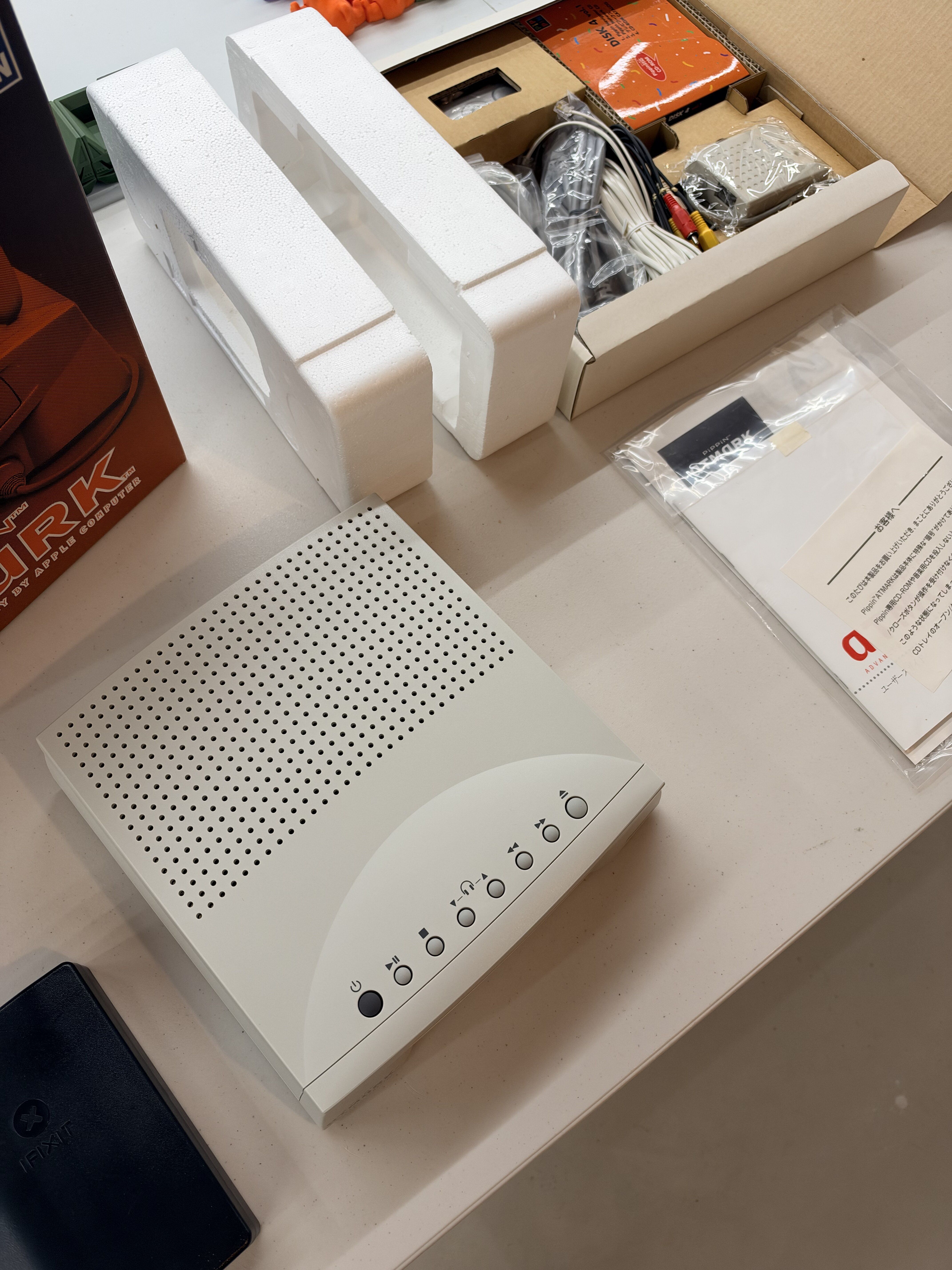

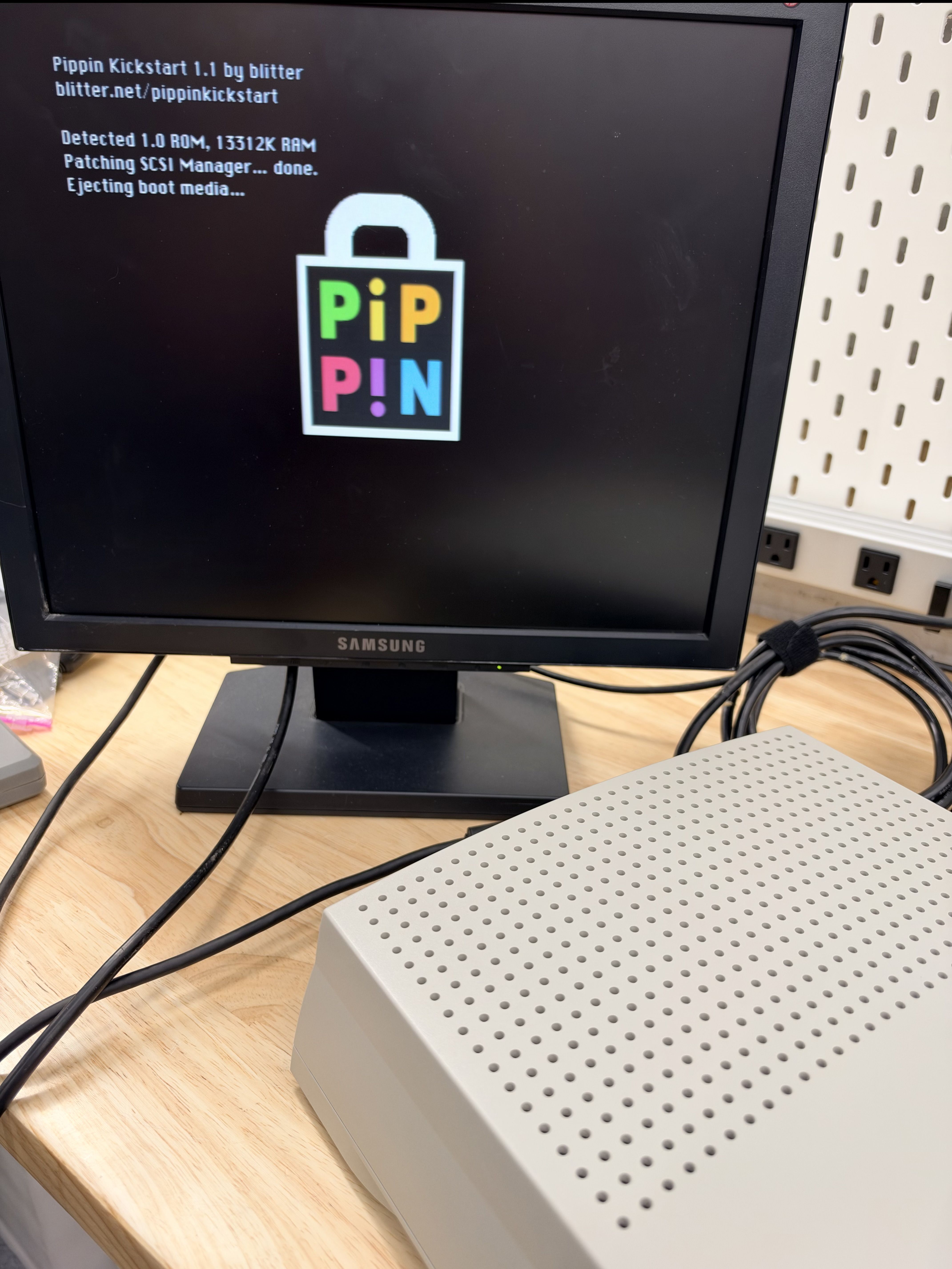

At this year’s Midwest Gaming Classic there was a brand new Pippin Atmark in the box in the vendor hall - and in the original shipping box, which I was able to get for a fair price. Today, I finally opened it up to remove the battery to protect it from future damage.
I don't think this thing has ever been used. It smelled brand new, and there was zero dust anywhere. The cables and controller were packed perfectly as they were from the factory. I used this video as my guide to disassemble the console. It was fairly accurate, but my model used security-style torx screws. The packaging included a brochure with some interesting examples of the Pippin in use.

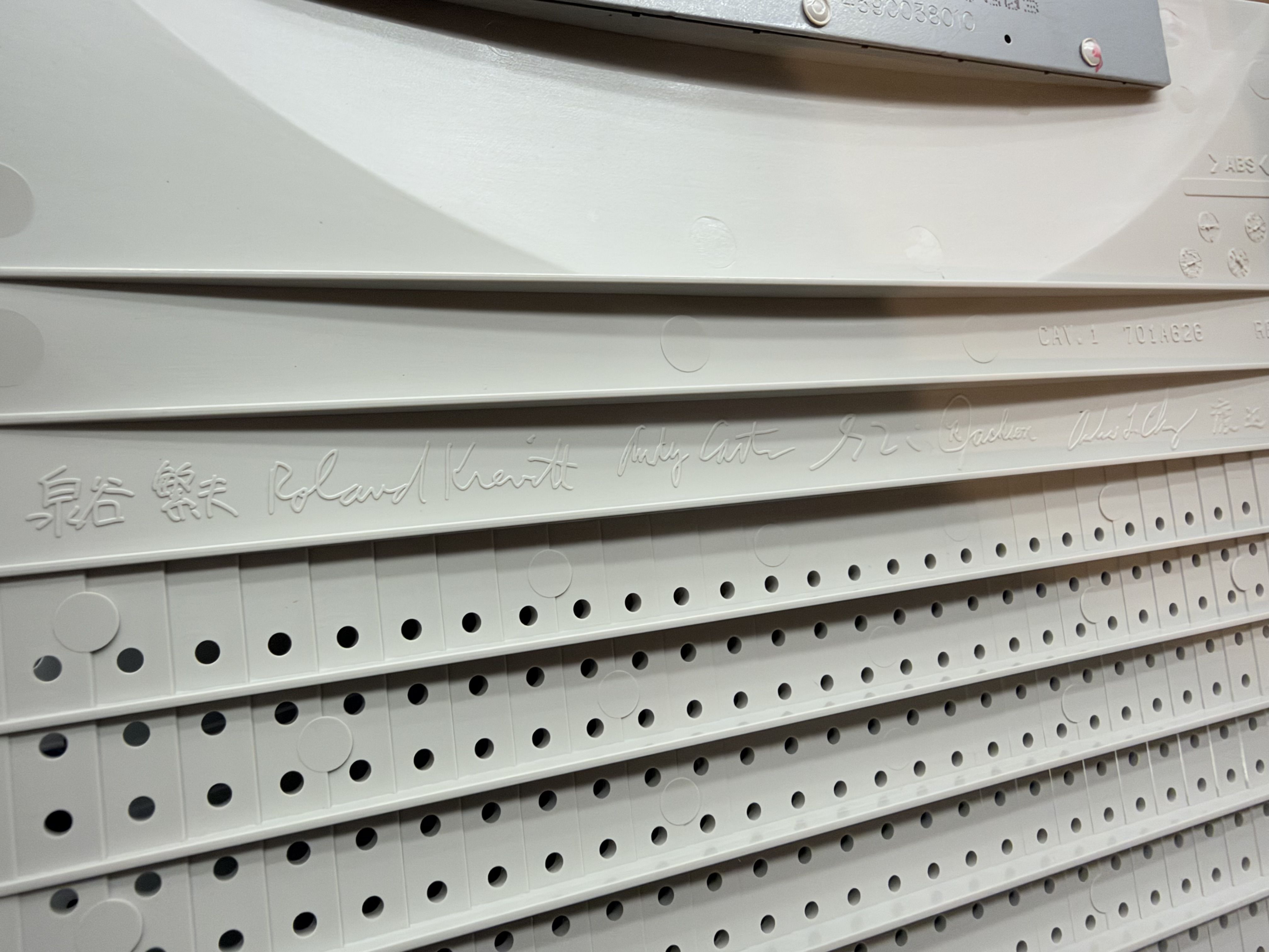

What was interesting, and I think I already knew this, but there are only one or two references on the web that show this -- the signatures from a few folks on the Pippin team are embossed on the inside of the top case.

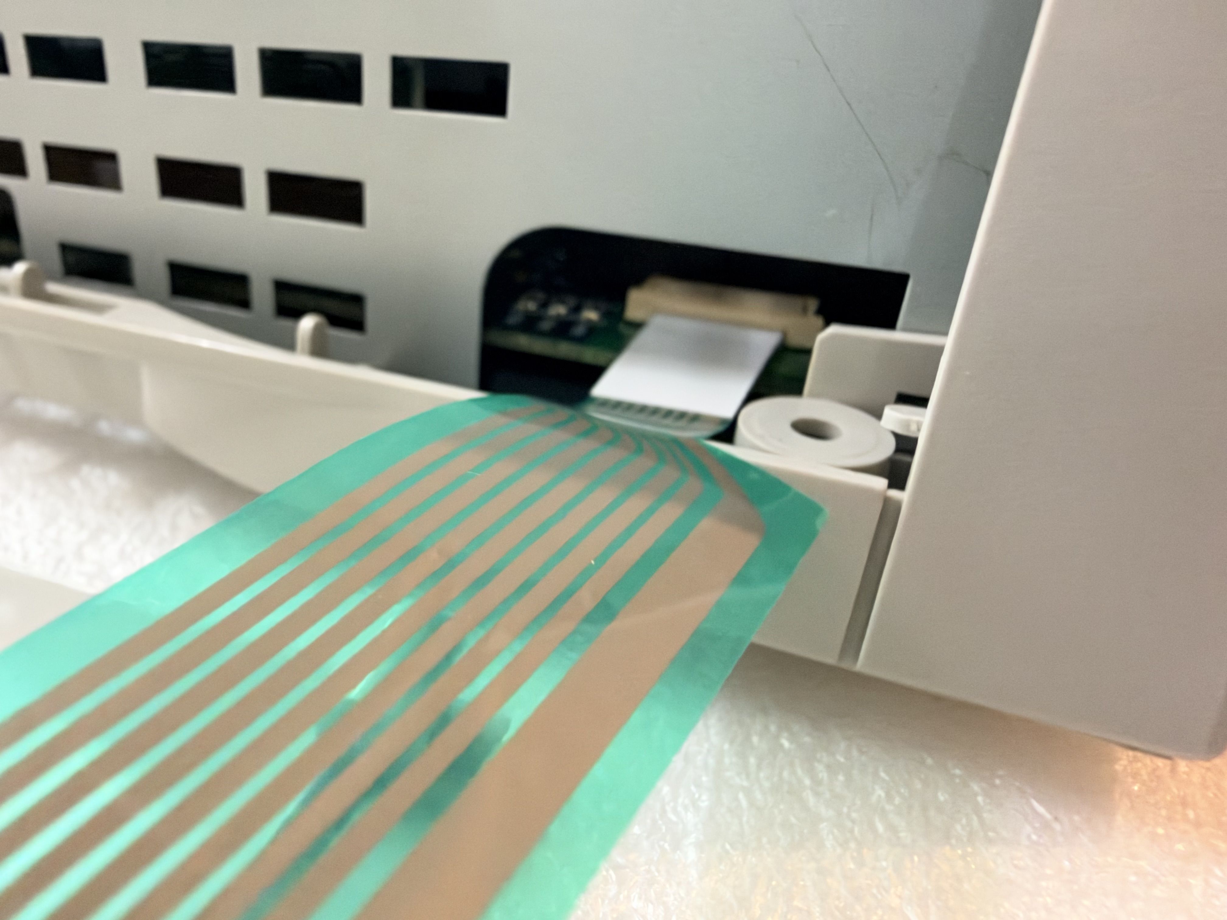

The biggest concern and issue I faced was the FFC - flexible flat cable. Some details can be found here. It was easy enough to pull out, as the video called it out, but getting it back in was a pain. I eventually realized I had to pull the connector tabs out a little, and then I could easily get the cable in and gently push the tabs in with a tiny screwdriver.
And it's back together and working! Hoping to get it running off a BlueSCSI for #MARCHintosh 2027!
